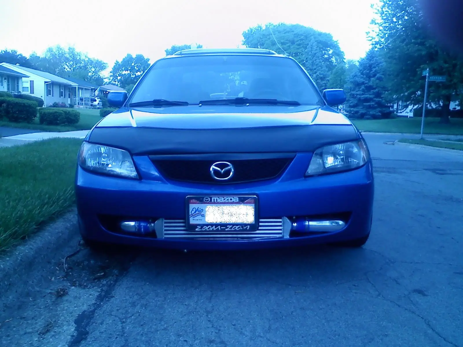

Check old posts, I took a bunch of pics on my install. It's not a totally custom job. It's based off the MAM FMIC kit but I ran a smaller core and, my kit was designed for a clocked turbo but my turbo isn't clocked yet, so I have to run some 90* couplers and extra piping
I also ran into problems with my fog lights hitting which I took pics of as well
It's a work in progress. I don't have it all the way hooked up yet. It's on a non-turbo car for starters. I'm working on creating a shield so I can hook a filter on the end of it. Then if I can find a resonable spray bar it'll be hooked up as my purge line for my NOS.
