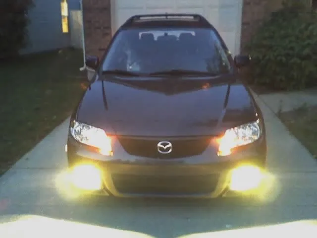

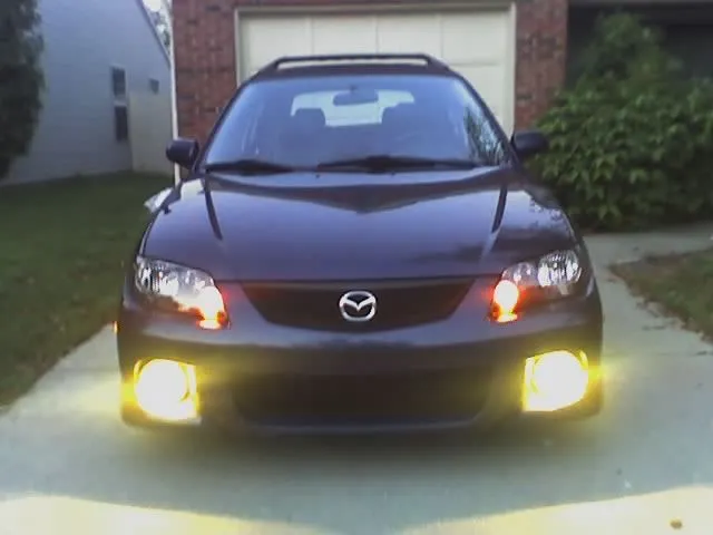

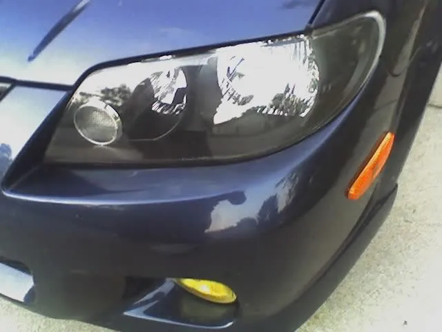

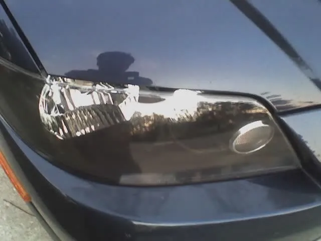

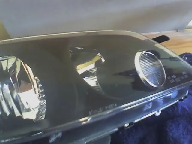

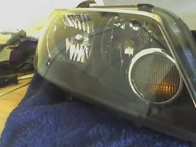

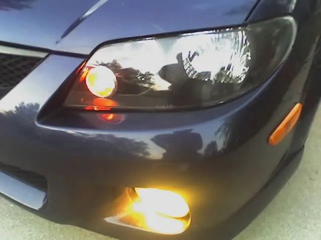

So I painted my headlights this week :D
BEFORE
DURING
AFTER
Hope you like
:D
I like very much, almost to the point where I'm thinking about doing that. How much of a pain was it?
Looks good!
follow the how to and it isn't that difficult. I masked off the small ring on the turn signal and personally think it looks much better. Either way- it's a great mod!
(Sorry for the crappy pics- I only have a camera phone...)

two more... before and after.
It wasn't that much of a pain, but I've done this before so it wasn't a problem for me. It was time consuming though.

I think it looks good on the silver
A friend of mine said to do that after I had finished, I think it looks cool to.

My understanding is the Canadian 2003 p5 came with them like this. I have had very little luck finding a set myself. One guy offered me a set brand new for $300, but now that i see this...hmmmm.....
So much cheaper to do. Just takes a little time.
How much time and money went into this? and was it a huge Pain in the Ass to get them off?
I've never taken my front bumper off, so i'm weary about trying this. But i DO like saving $300...I like that a LOT!
I paid about 6 bucks for the paint. The front bumper took me about half an hour to get off (there is a write up on on it in the how to section). Disassembling the light took about 30 minutes. Painting took about 30 minutes (three coats for each one). Another 30 minutes to put them back together and about 15 to put them back on the car (knew what I was doing this time). I took a lot of breaks in between and ate a sandwich, but all in all didn't take that long at all. So 6 bucks in and some time well spent is all it takes.
