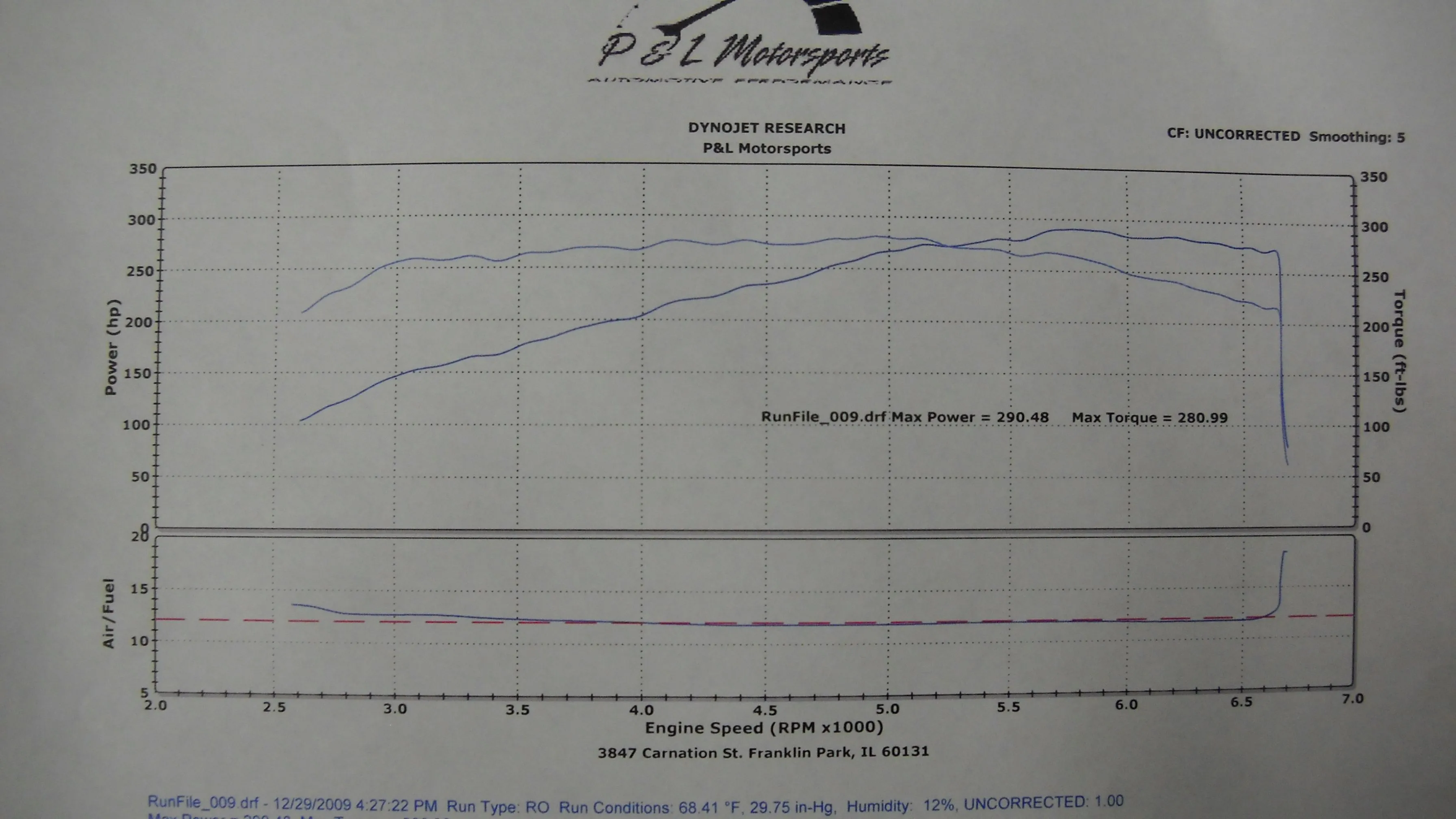

For anyone in the Chicagoland area with a Speed3 or 6 looking for a solid tune, go see Jorge at P & L in Franklin park. They have a long history with Subaru, but have been gradually expanding into the Mazda market. Jorge understands how this ecu works and how to tune a butter-smooth daily driver (he also tunes huge hp race cars.) I drive 60 miles/day commuting to work and like to get into the throttle, so I did not want huge midrange peaks, rather great power that I can use frequently without torching my engine. Very happy with these guys.

I am extremely happy with my tune! The power delivery is very linear, and having power hold to redline makes the car very fun to drive. I don't have to shift at 5500 like others to avoid a nose-dive. I have seen a lot of dyno sheets where boost is cranked at 4k rpms to make a huge tq number, but that puts a lot of unnecessary stress on the internals for bragging rights. I don't think that a wad of power at from 3.5k to 4.5k necessarily makes for a faster car, and I haven't seen many make great power at 6700 rpms like my tune. At 4k, my boost is at a very safe 15.6psi ramping up until redline. My fuel trims all look great in various weather conditions, and I don't see any knock events. Keep in mind that I make this power with a STOCK DP!
In all, my car left P&L a far better car than I showed up with, and well worth the money I spent with them. I highly recommend the pre-tune boost check they perform to rule out any leaks...I had 3 that I did not know about. I can't wait to get to the track this Spring to see what it will do. Kudos to P&L
EDIT: I must add that depending on the engine speed, boost can vary by quite a bit. By this, I mean if i start to accelerate @2.5k, power delivery is as you see it on the dyno graph, with boost holding @15.6psi at lower rpms and building after 4k. If I apply full throttle @4k, I see 23.8psi and the boost tapers back to 19-20psi after 4.5k.
