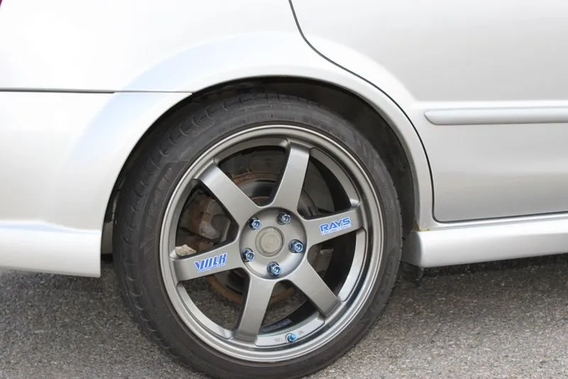

What a great thread! I just picked up some 18x7.5 +48 gunmetal Volk TE37s and I can't wait to mount them on my P5. Now I just have to pick some tires!
I have been reading some of the very informative threads on the forum and it would appear the safest size of tire to run is 215/35/18. It looks like at least ONE person is running 215/40/18. I have a completely stock suspension and I would prefer a 40 series tire over a 35. Why is 215/40/18 no good? Is it because the tire will hit the spring perch of the strut? Because there's plenty of room under the fender.
Input from anyone with experience would be greatly appreciated! Thanks.

I would run the tire size that is recommended on here if you don't wanna run into issues with rubbing.
Thanks Matt V. I lucked out a bit with the wheels. There was someone selling a slightly used set locally (wheels are date stamped Feb 2008) and they are in fantastic shape. He was running them on his Prelude.
I thought about it some more and you're totally right about the tire size. Besides, Tirerack is having a crazy sale on Hankook Ventus RS2's in 215/35/18. $71/tire. I couldn't believe it. So I just ordered a set! I'll have to post pics when I have the wheels on the car.

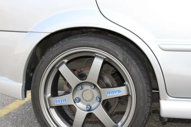

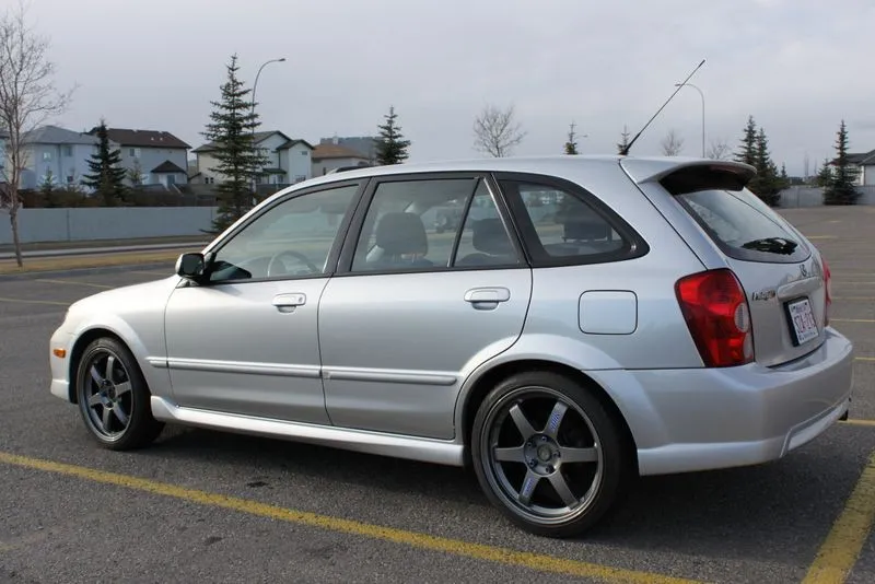

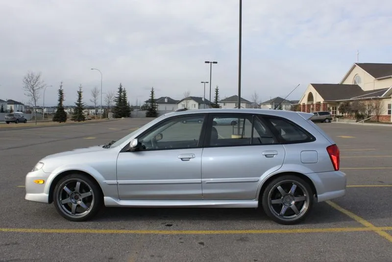

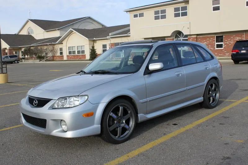

So I put the TE37s on. Overall, I am very happy with them! I was concerned that 18's might look too big, but I think they're alright. I'm also on stock suspension and the 215/40/18's on there right now don't rub at all and fill out the wheel wells quite nicely. However, the tires are worn and will be replaced in the summer with the 215/35/18's that I've already bought. If I would have known, I think I would have picked up some 40's instead of 35's. Anyhow, I think the wheels will be on for a week and then they'll have to come off before it snows.

Thanks. I knew the first comments would be to lower the car :). If I am REALLY to listen to what my car is saying, I would lubricate and change the rear sway bar bushings!

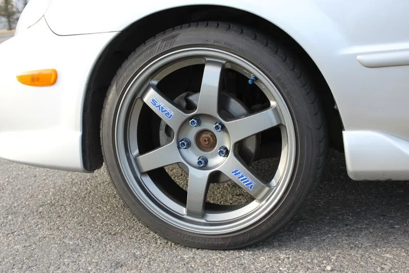

Anyhow, back on topic. I've added a couple of more close up pics of a rear wheel and one of a front wheel. You can see that with the 215/40/18 tire (Falken FK452), it gets close to the spring perch, but there's definitely enough clearance room. Same story up front. Also, there's no rubbing at full left or right turn. The wheel itself is 18x7.5 +48 and it gets close to the suspension, but it also clears.
So I don't know why the fitment guide says to use 215/35 and it looks like most people that run 18s do the same? I know every tire is different, but has anyone had problems with 215/40/18's?

the tires size is set up 215/35/18 so its closer to overall stock wheels and tires for better performance. But it up to you in the end in what you want. Im using 205/40/18 tires on my 18x8 rims=)
