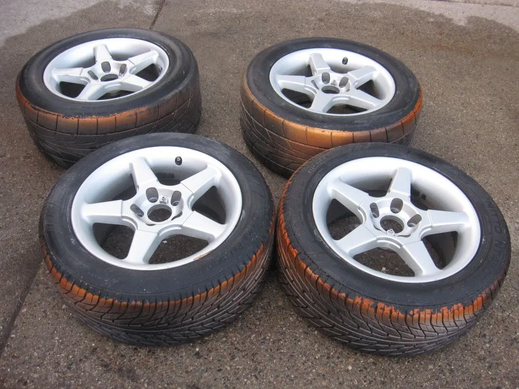

Hey guys,
I'm looking to put some new wheels on my 02 Pro5
four 16x8 OZ wheels
>5x114.3 lug pattern
>40 offset
Tires: 245-50
Will this setup work? What is the basic rule about offset?
Does a smaller offset mean that the wheels sit more inward?
I need some basic advice, cuz I need some new wheels badly.
Thanks
Also how do you think they will look?
i think 16x8 will be too big, especially at +40 offset.
from what i know (some may beg to differ) +45 is the lowest you should go for offset. and 8'' wide might be too wide.
if you already have them though, which it looks like, doesnt hurt to try.
if not, i would doubt they would work without a lot of work.
The limit without rolling the rear fenders, as far as my personal experience, on a 16x7 wheel is +42, and that had some decent rubbing already. Plugging that into THIS tool, a 16x8 +40 would stick out another 15 mm, which would likely require a SERIOUS fender pull to clear, not just a roll. And with 245s, you have exactly zero chance without doing some serious fender modification.

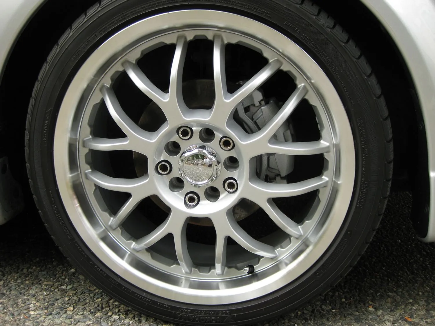

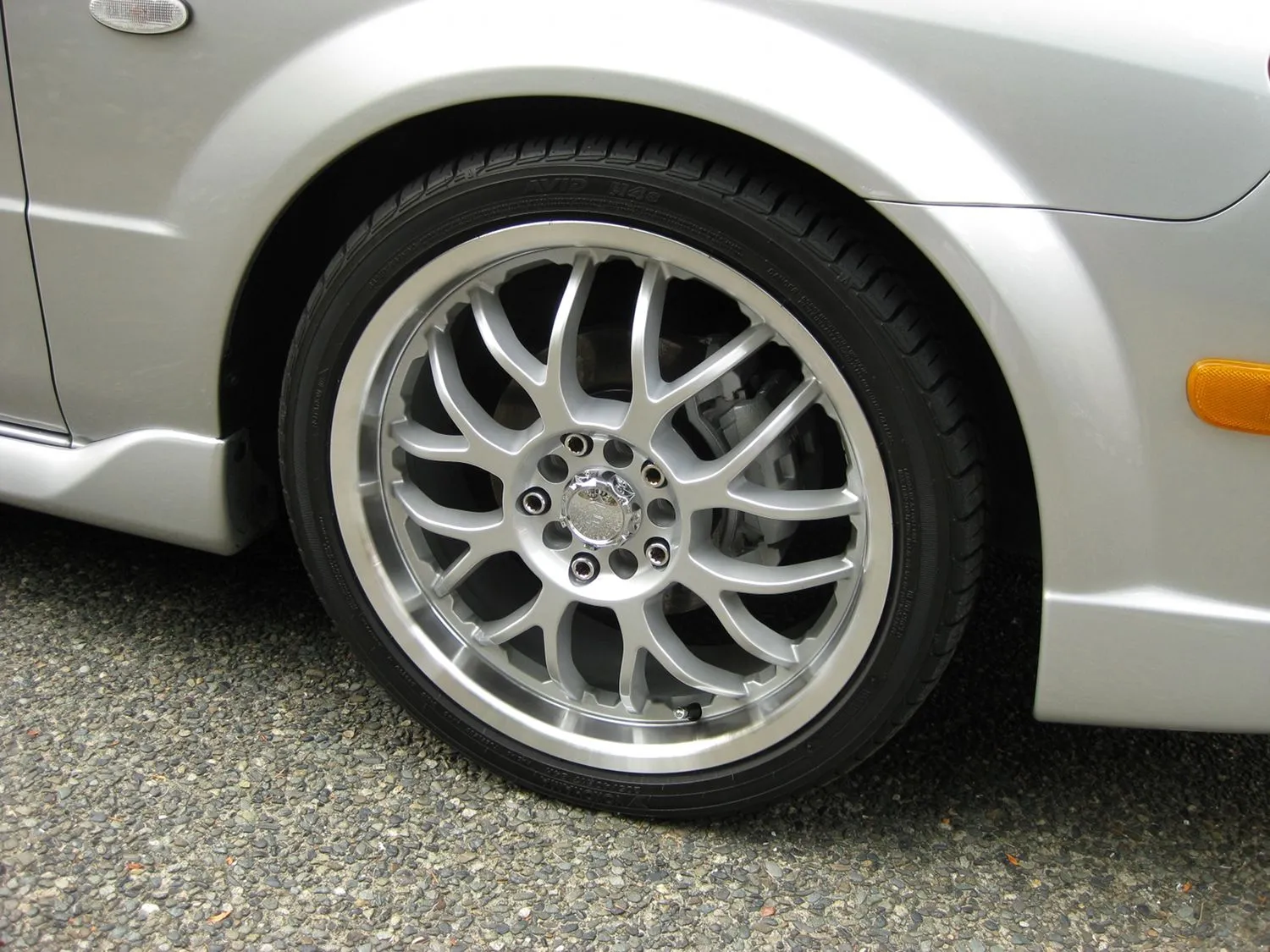

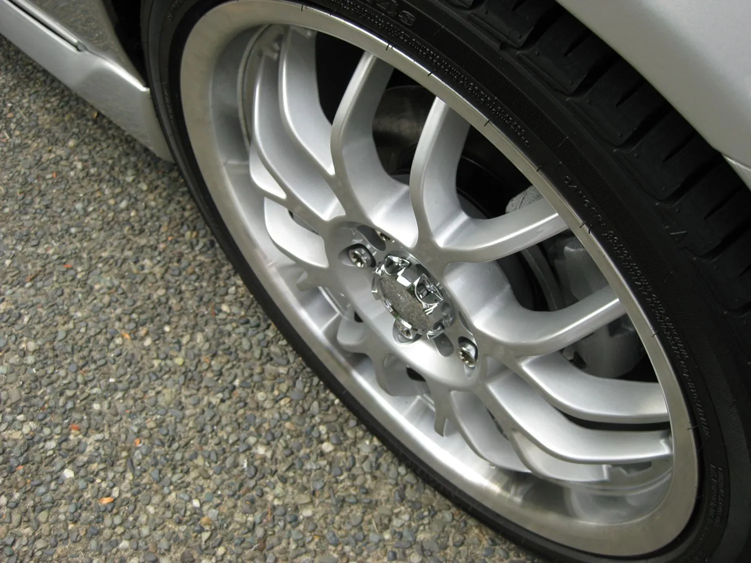

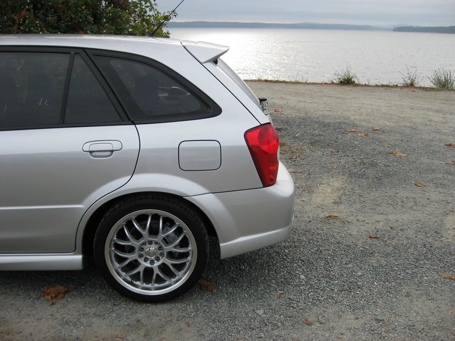

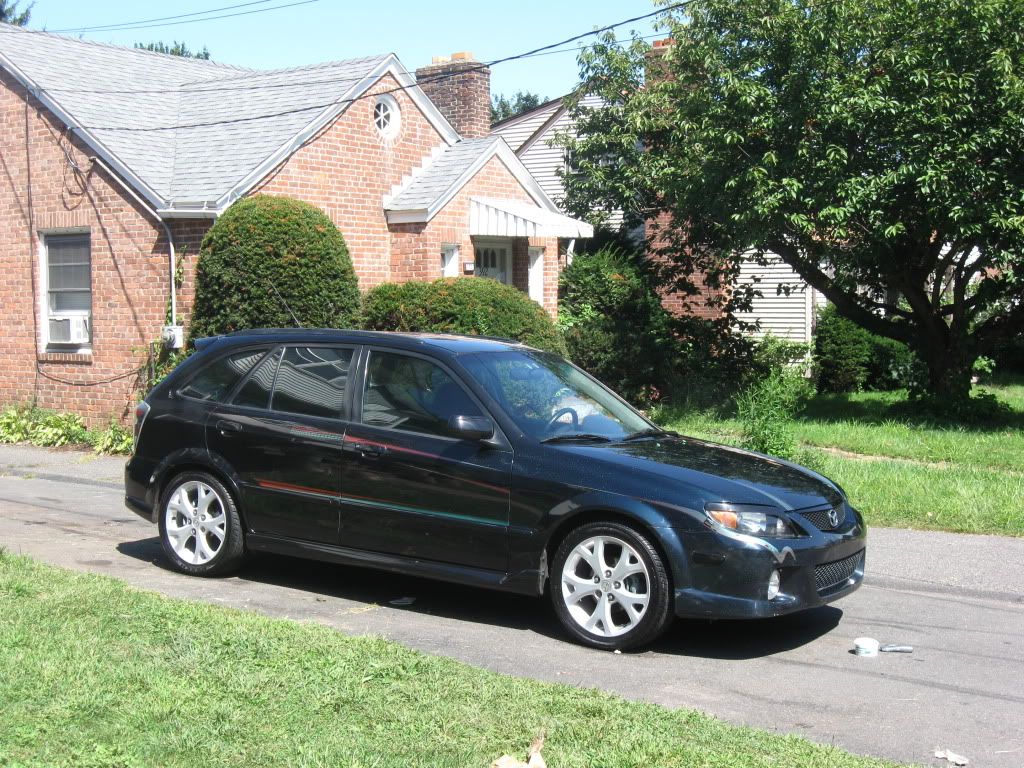

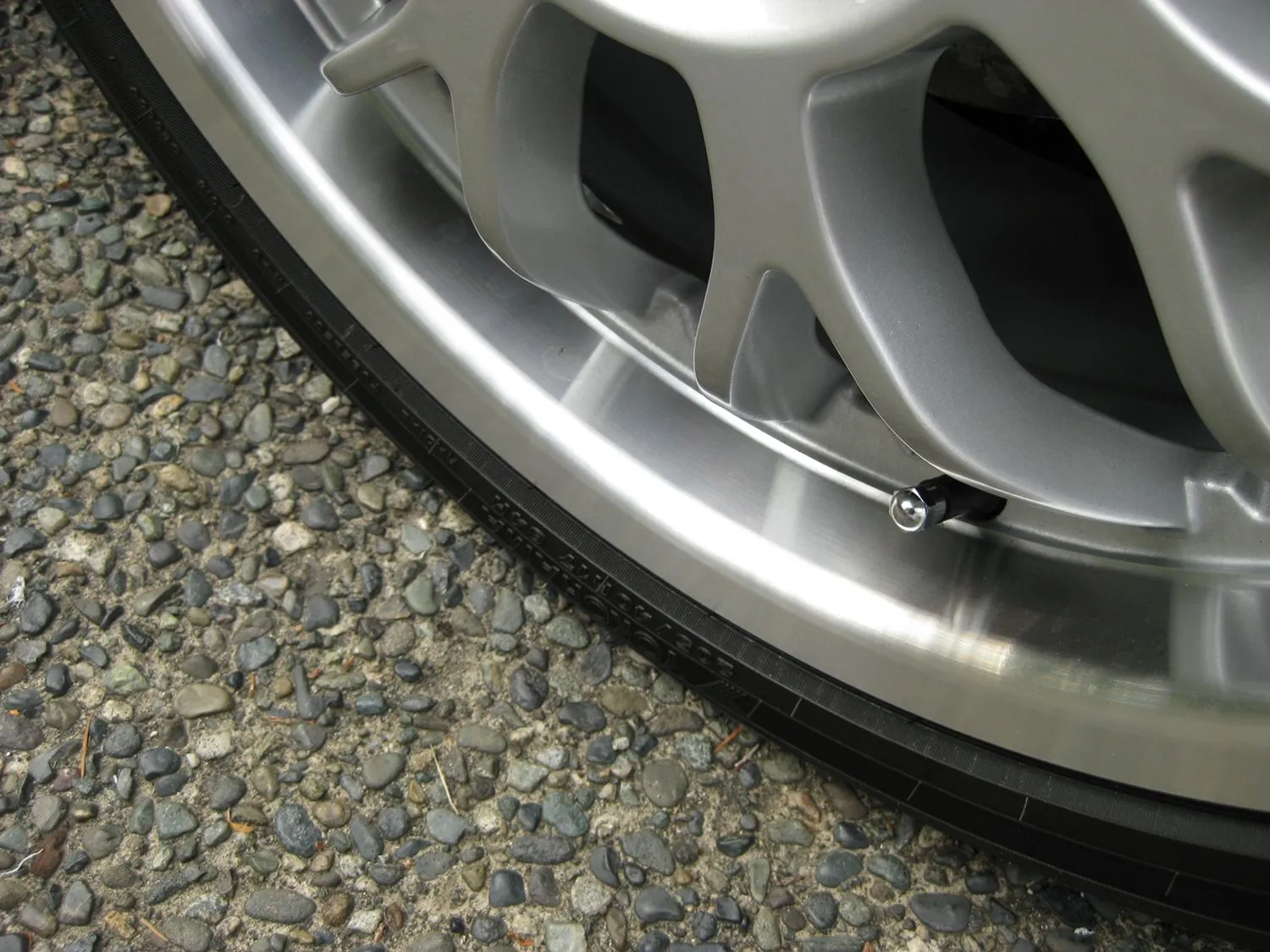

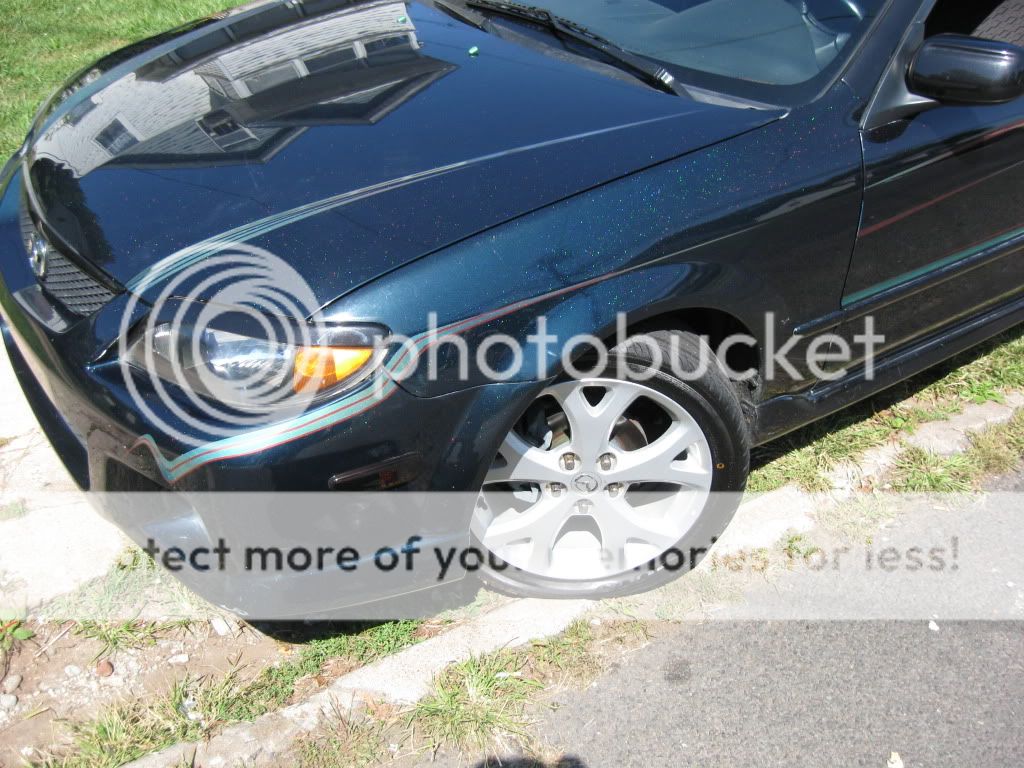

I bought new wheels and I'm bringing this thread back to life!
Akita AK-6
17x7 +40
205/40-17 Yokohamas
Fenders rolled, but still very slight rubbing.

17" Mazda3's 215/45/17 Nexen N5000s
Any issues with the 215's? Last year when I was looking into those same wheels I was worried about stretching the 215 on a 6.5" wheel.
nope, no issues whatsoever, I didnt have any problems mouting them and no issues driving on them either.
