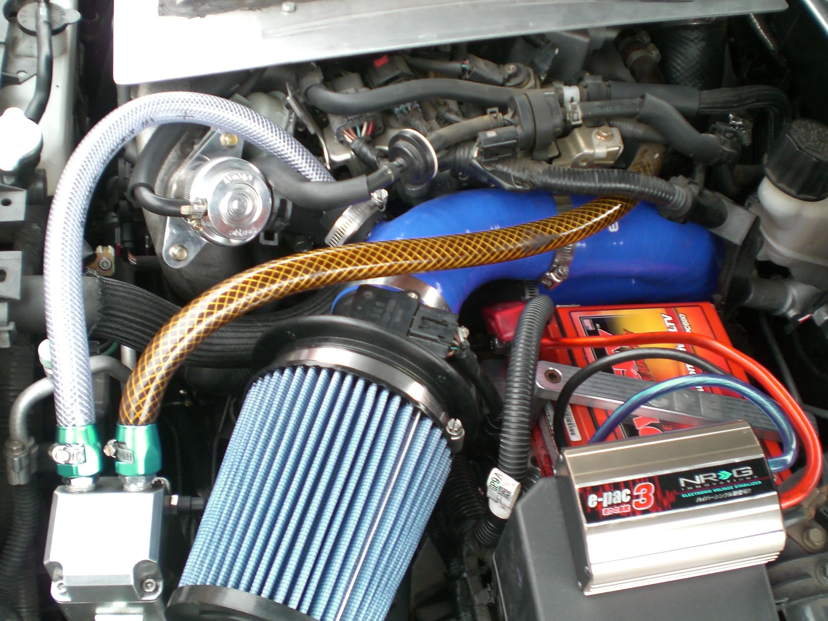

ok so this is where my oil can goes.. it collects about a quart or less every year maybe?? theres another spot for the can that also helps alot.. but, this is just my install pic for those who asked.. you can place it many ways on its side etc.. it just uses gravity to keep oil from, the return line..

Nice spot.
You do know you're missing a clamp on the SRI/TIP though, right? Should be 2 clamps where the metal sleeve meets the intake, one on each side.
Nice spot!! i made it work with a wider version of a silicone specific clamp.. the ones COBB gives you are too small and strip the silicone very easily.. these are wider and keep the worm part outside.. so theyre good..
Hmmmm? That hose is only the fresh air inlet for the main crankcase ventilation system. The PCV valve and OEM oil separator is located under the intake manifold on the block. In all actuality, that OCC isn't doing anything for you... A functional OCC should be in series from the intake manifold main vacuum inlet nipple(on back side of intake manifold plenum) and the PCV on the block. You can mount the OCC with long hoses in the driver wheel well, or use shorter hoses and mount it at the horns under the passenger wheel well...
Fresh air inlet?? huh?? air and oil is being drawn out from the crankcase.. not going in?? youve obviously got it backwards!! look at your hoses and their directionality.. the crankcase blows OUT hard on every shift and shoots oil out!! ive seen this many times on dyno pulls.. if you dont believe me run a crankcase breather and see how oily your engine bay becomes?? and like i said there is ANOTHER spot for running an oilcan.. which will catch even more oil.. but, this definately keeps lots of oil off the turbo and inlet.. if you dont believe me?? send me your address and ill mail you what comes out??
Yes, it is truely the fresh air inlet for the PCV system. I have no doubt you see oil/vapor come out of the hose when you let off the gas under heavy boost load, so you don't need to send email. I would post up the PCV system diagram/description so you can see how a PCV valve/system works, but I don't have it handy. You can search the web and find it I'm sure. In almost ALL phases of engine operation filtered air is drawn INTO the cam cover via the hose. Lots of people like to remove it completely and run a little colored filter on the nipple for looks.
That top cam cover hose will indeed vent oil/vapor under boost when the PCV valve is closed IF you have a excessive crankcase pressure or too much oil in the cam cover vent reservoirs. The excessive pressure can be caused by several factors, including compression ring blowby, oil too thick, oil level too high, and/or PCV valve either plugged or stuck open.
The point it that the upper hose is NOT the primary entry point for oil/vapor into the engine. Yes, there may be some oil/vapor injested into the main inlet post MAF, but that area is benign unless you have other issues.
Some people run OCC in both locations (PCV and top inlet) on very high boost applications that create a tremendous amout of ring blowby, but the top location would be the LAST place to add an OCC for actual excessive oil collection. I'm not going to debate with you about it further. You can do whatever you like... YMMV
+1 on what forzda says. that is not the ideal location for the occ. you want it in line with with the pcv which is down behind the intake manifold.

trust me i know all about it and so does forzda. you may catch some vapors where it is but air is pulled in through the breather when you are in vacuum and evacuated through it when you are in boost, its as simple as that. so more times than not it is used to pull air into the crankcase. if i have to draw a picture how it works i will.

Ha the oil that gets by that breather is negligible. I don't care if you put it there or not. I'm saying the occ you should be more concerned with is putting one between pcv and intake manifold where probably 100 times more oil gets by. but hey you think you know it all, thats fine. i'm not saying you aren't going to get oil there i just know that when i take my intake off and my intercooler pipes i don't have any oil in them there so i don't care to put a occ there.
that is correct, but his isn't incorrect, its just not as useful as putting it in the other location.

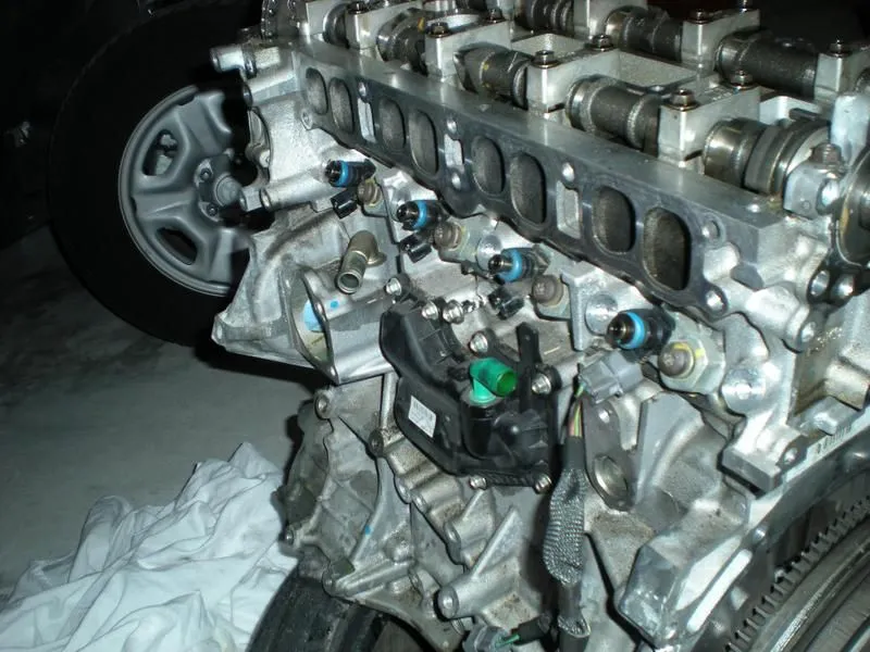

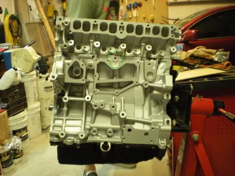

I've also attached a couple of photos of the engine block itself so you can see the OEM oil separator/PCV valve setup location. For those who may not recognize it, the black object is the oil separator/breather assembly and the little green doodad is the PCV valve. I also included a bare block photo to show the drain cavity behind the OEM PCV/Cover and the knock sensor location just above it.
