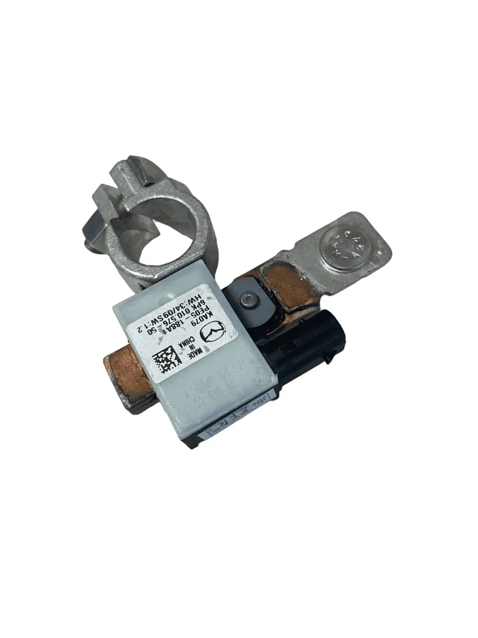

Batt temp ~~~ WHERE IS THE SENSOR FOR THIS?

There's a battery temp indicator? I'll ask the same question that you did, where's the sensor? I don't believe that there is one.
To answer some of your questions, Coupling Solenoid Duty Cycle (%) is the rear diff, Lockup Solenoid is TCC, your throttle will never hit 100%(this is an industry thing not a Mazda thing). Batt Temp is an actual value for the vehicles that have the load/battery temp sensor on the positive cable, some vehicles without that sensor will calculate a value. The sensor will resemble this if you have one.
