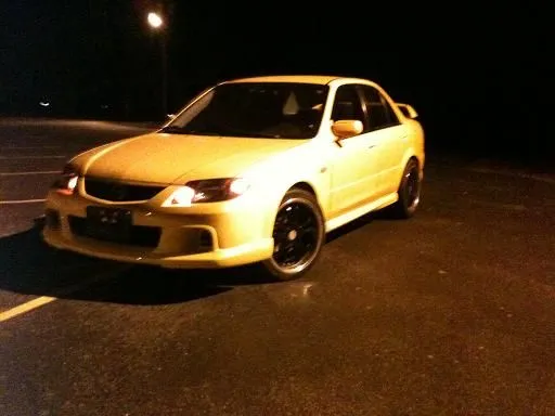

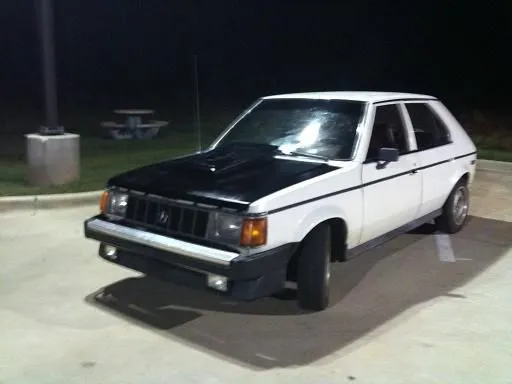

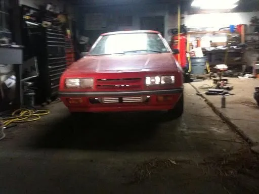

Here's a pic of 3 of the vehicles. I own around 10 cars or so right now. Oldest is a 79 T/A in need of paint and seals. Here's pics of the 84 Rampage, 90 "beater" Omni (about to get painted) and 03.5 MSP #205
I'll get better pics when the weather gets better and def. pics of the MSP when I take it to Cali in a few weeks.
