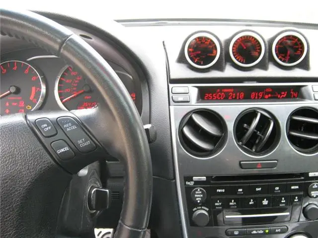

A/F gauge doesn't seem to respond, but couldn't find it's connections in the engine bay without taking things apart (didn't have time). It wanders occasionally, so I'm thinking bad connection to the O2. Not too concerned with it, as a wideband will probably be replacing it. The last gauge is an oil temp, that never responds at all.... not sure why they chose oil temp... I would prefer an EGT/pyro.

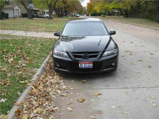

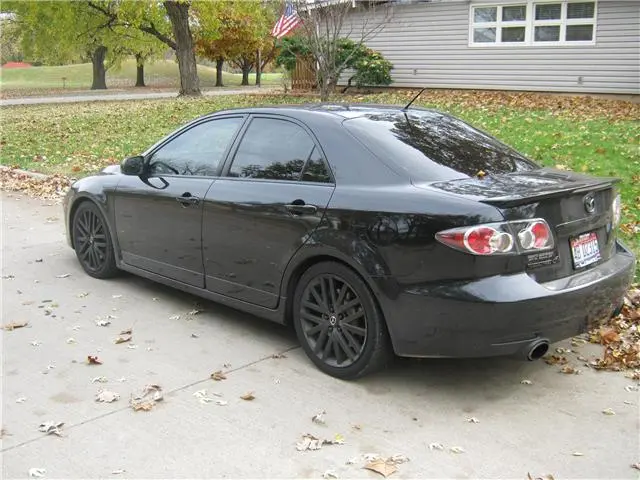

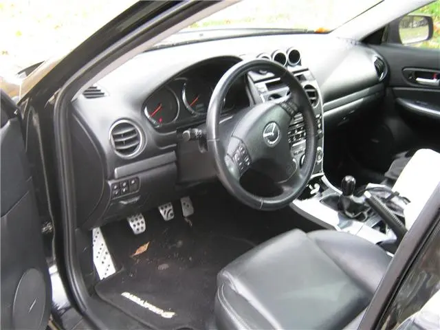

couple pics..
Here are a couple pics.... she's dirty though. Get some underbody's on Sun
