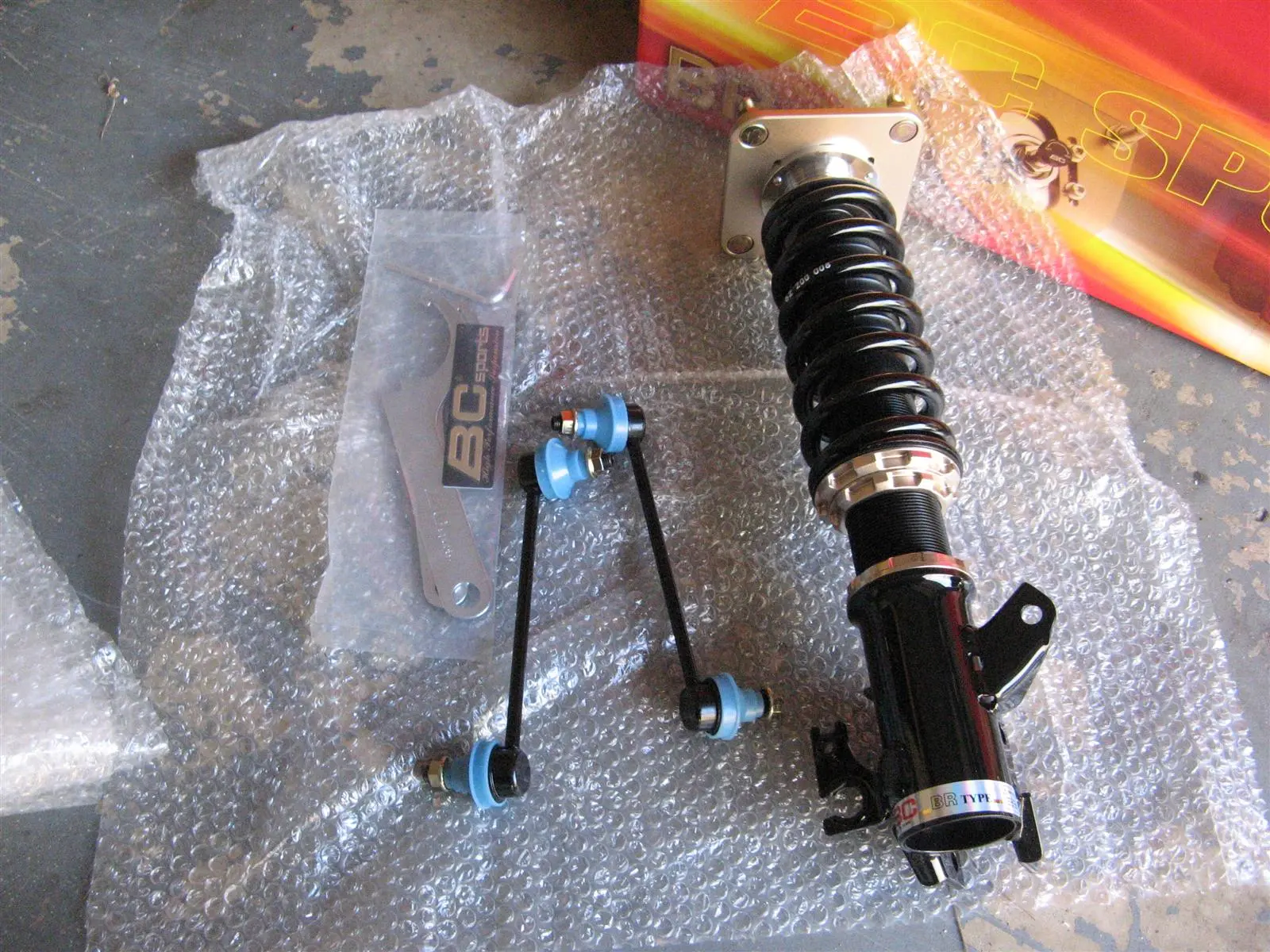

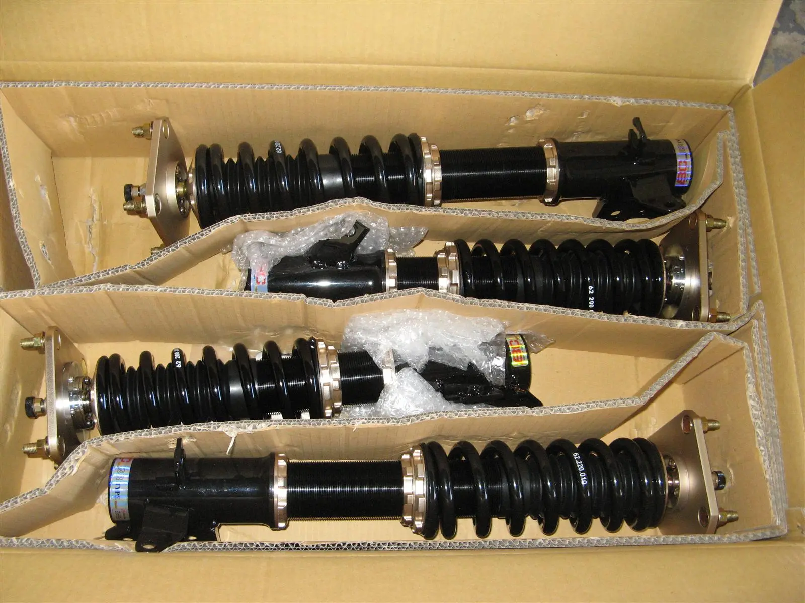

Here are a couple pics. In the box you get 4 struts, 4 springs, 2 endlinks, 2 spanning wrenches, 1 allen wrench, and a BC Racing emblem.
I'm thinking the endlinks are for the front because if they're too long, the front sway bar will hit the lower control arm.

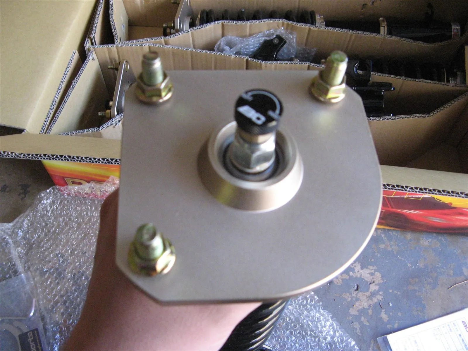

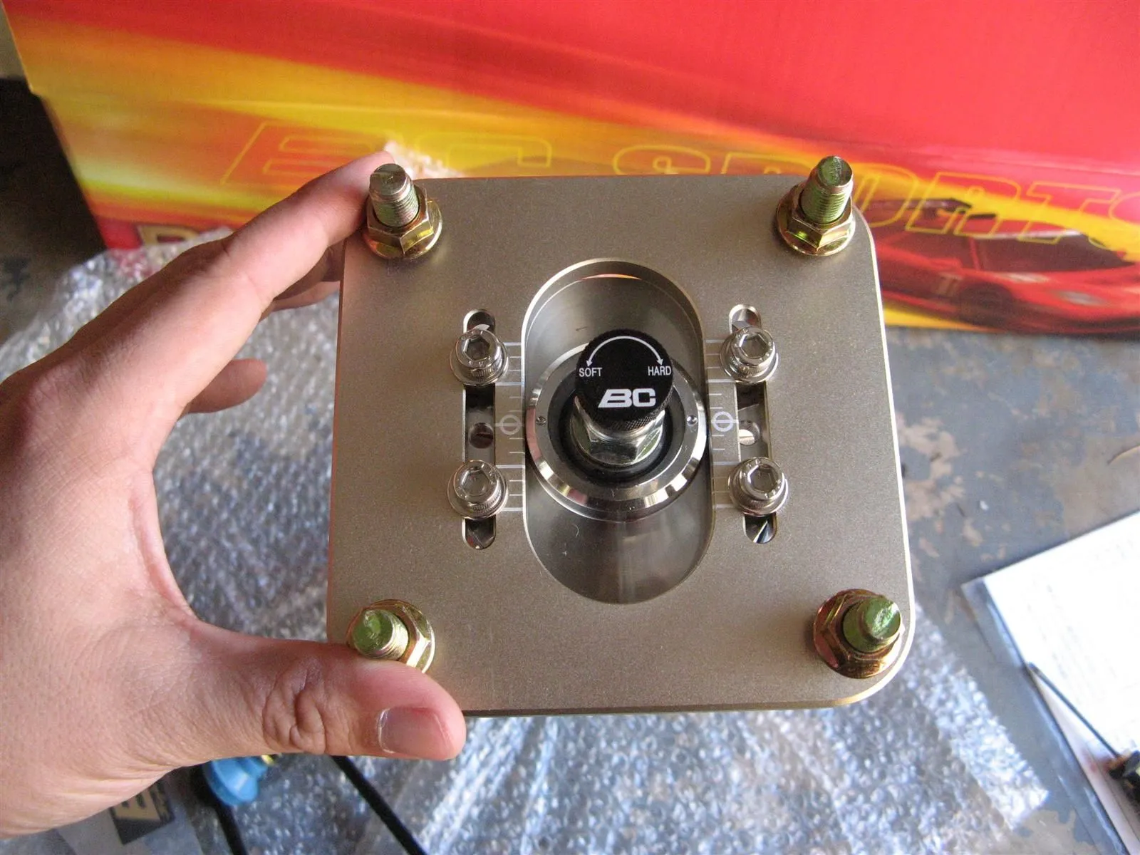

The front struts have camber adjustments. The rears are pillow ball upper mount. Where the strut attaches to the hub, the bottom hole is a little elongated to help get more camber.
There is 30 levels of damping adjustment. These actually click like the TEINs, whereas the K-sports I had before just spun.
Another little touch I noticed is on the locking rings. They have a little lip, making it easier to grab with the spanning wrench.

On the front camber plates, you can use the middle hole for the allen screws to give you maximum range for camber adjustment.

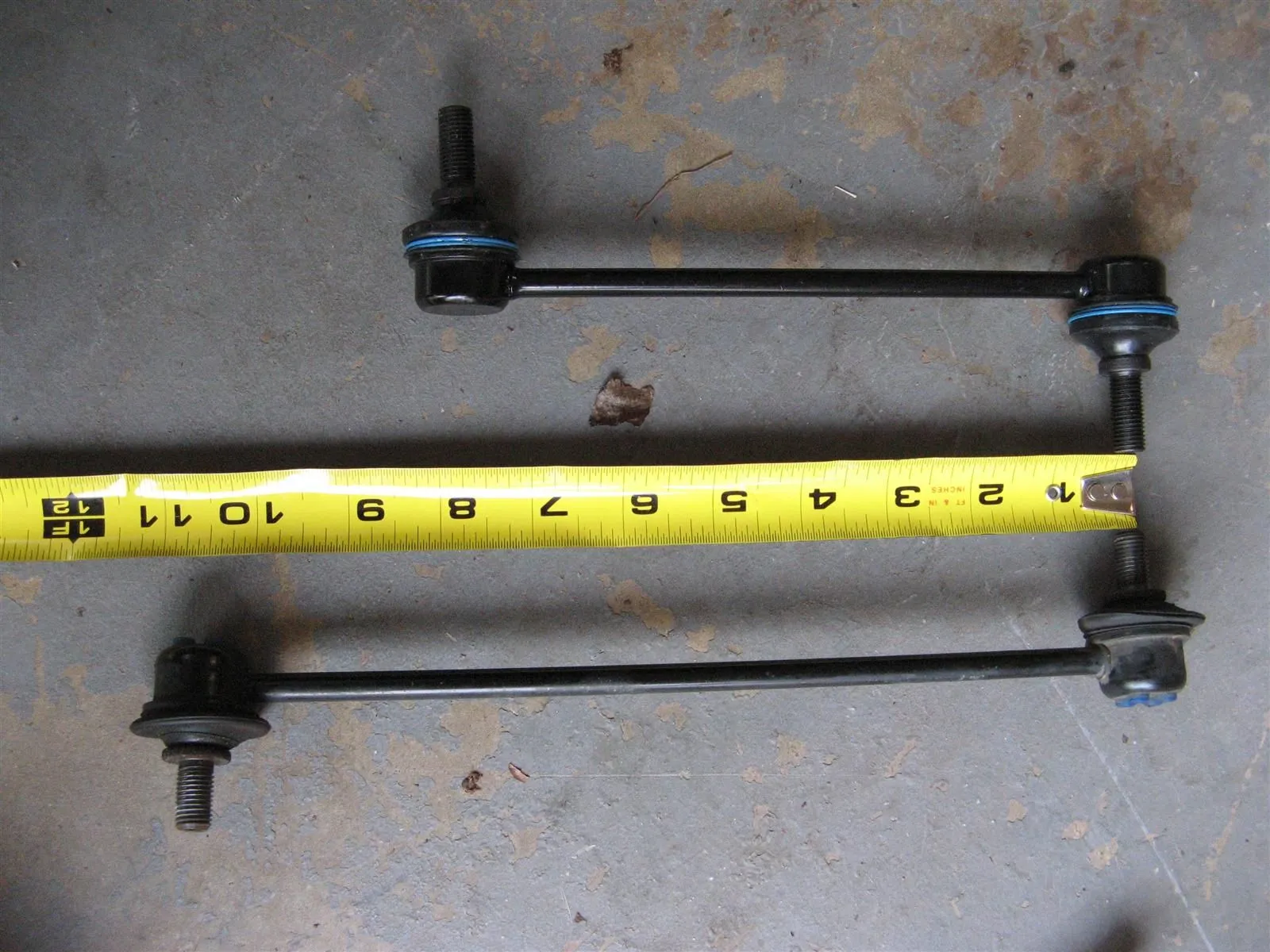

Helping another member out today, we installed the endlinks that came with the BC suspension on his MSP. The picture shows the size difference. Looking at the construction, the BC ones look thicker and don't have the plastic rivets sticking out the back.
