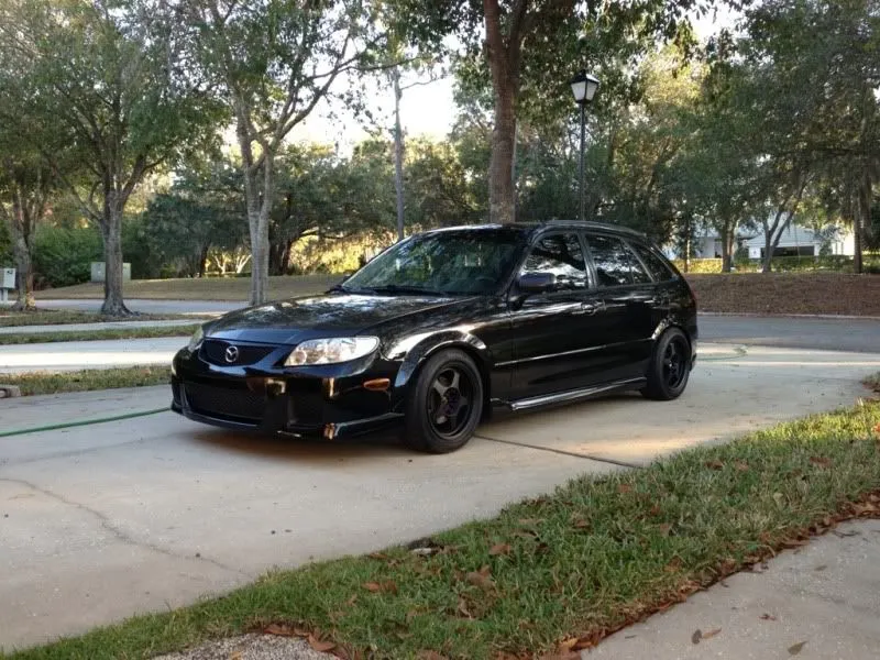

Yes this is what im looking for, this is a rota slip 15x8 +40 offset on a 205 50 15 im just wondering how come the black cars wheels poke out a little more then the silver one, maybe just spacers or?

Looks like the offset places the tires farther out. The lip is deep compared to the Protege5 factory rim.
I'm thinking the same. Lower offset will push the wheels out further.

Nice! im wondering if you had to roll your fenders? did you have to put wheel spacers in? thanks
I didn't roll them originally, no spacers.
But the rears do rub slightly without a roll. (at that height) If i raised it a 1/4th an inch it would be fine I believe
