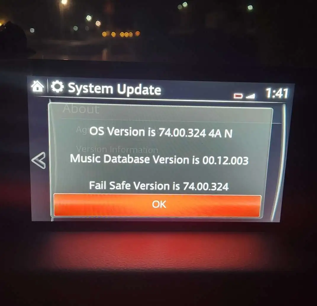

Hello,
I got a new Mazda CX5 AWD 2023 (new lights) - however the vehicle production year is 2022.
When I hit the Nav button - it shows me compass and "your vehicle isnt equipped with navigation...."
Now my mazda dealership sales guy is clueless, and told me for navigation I need to get the higher model (the price of which is significantly higher), and has no idea about the SD card for navigation.
However, from all the videos online, Mazda cx5 comes with 10.25 widescreen display - But, mine is the 4:3 or 16:9 and cant fig the size.
I want the navigation SD card for integration with HUD. I found one on navi-world for my region, But im unable to verify if it will work with this screen..
It has a "Suppression Code" : BHW666EZ1H [Note :Mazda Cx-5 2015-2022* (works only with 7.5-8.5 inches display with Mazda Connect System / main menu on photo above)]
Any clues to
1) how do I verify it for my Vehicle ?
2) How to fig my Vehicle infotainment display size/aspect-ratio/version etc ?
3) What suppression code should I be looking for ?

based on the provided pictures the car is the new fascia/model but the infotainment from the previous generation 6. In US that was in cx5 till 2020(incl). That makes me believe the OP is not in US. It is the infotainment system version/generation that matters not how big the screen is.
Yes - both me & vehicle in GCC.
The reason I posted this as the SD card in question mentioned 2016-'22, not compatible with '23 10.25" display.
Wasnt sure how they measured the display, incl bezels or without. Besides no clarity on the display from mazda even in their manual/spec sheet.

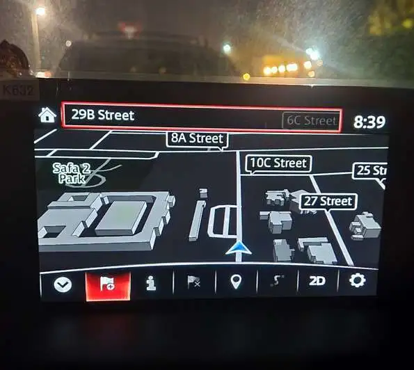

Quick update.
Received the email with instructions and file.
Transferred to SD
Downloaded the mazda toolkit, registered, updated etc..
Popped in the SD in cx-5.. as soon as I turned on the vehicle .. NAV came up and all set in 10 Seconds.
Took it for a quick spin, HUD info looks lovely.
Navigation is not as great as the beemer.. but none the less.. pure eye candy & thrill.
Thankyou all.

Quick update.
Transferred to SD
Thankyou all.
Then time for playing around in settings, lots of thing to adjust. :)
