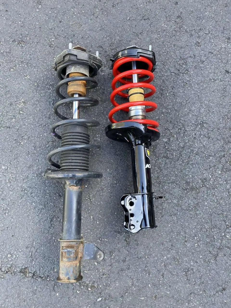

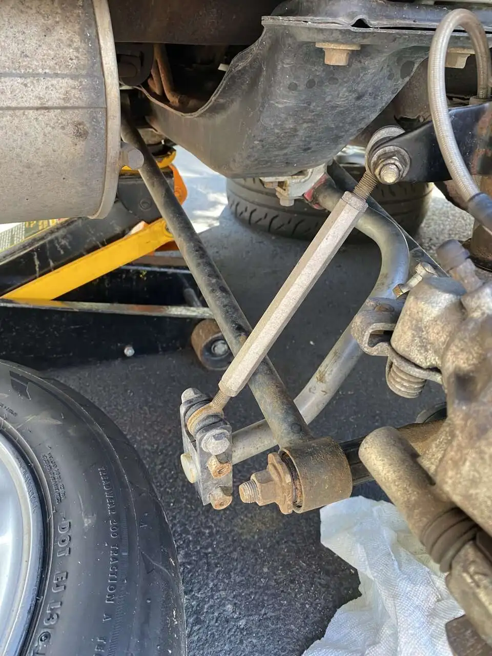

On my 2002 P5 I have installed the AWR trailing arms, and adjustable rear sway bar and racing beat springs with Koni 8610 single adjustable race shocks (yes, the suspension is worth more than the car). The rear sway bar can be mounted in front (stiff) or behind the lateral lower control arm. I have set mine behind the control arm, and the car is very neutral, such that you can actually use the throttle to rotate the car. I drove the car at a couple of Porsche club driver’s education events. It is especially a blast in rain on the track. I have only installed adjustable links on the front bar, but the Racing Beat springs only lower the car about 5/8” all around but it makes for the right height.
