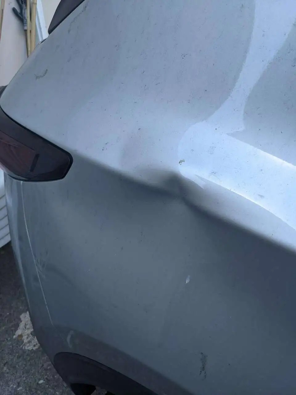

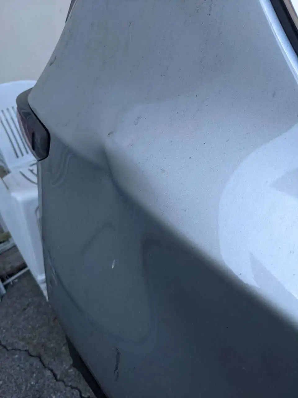

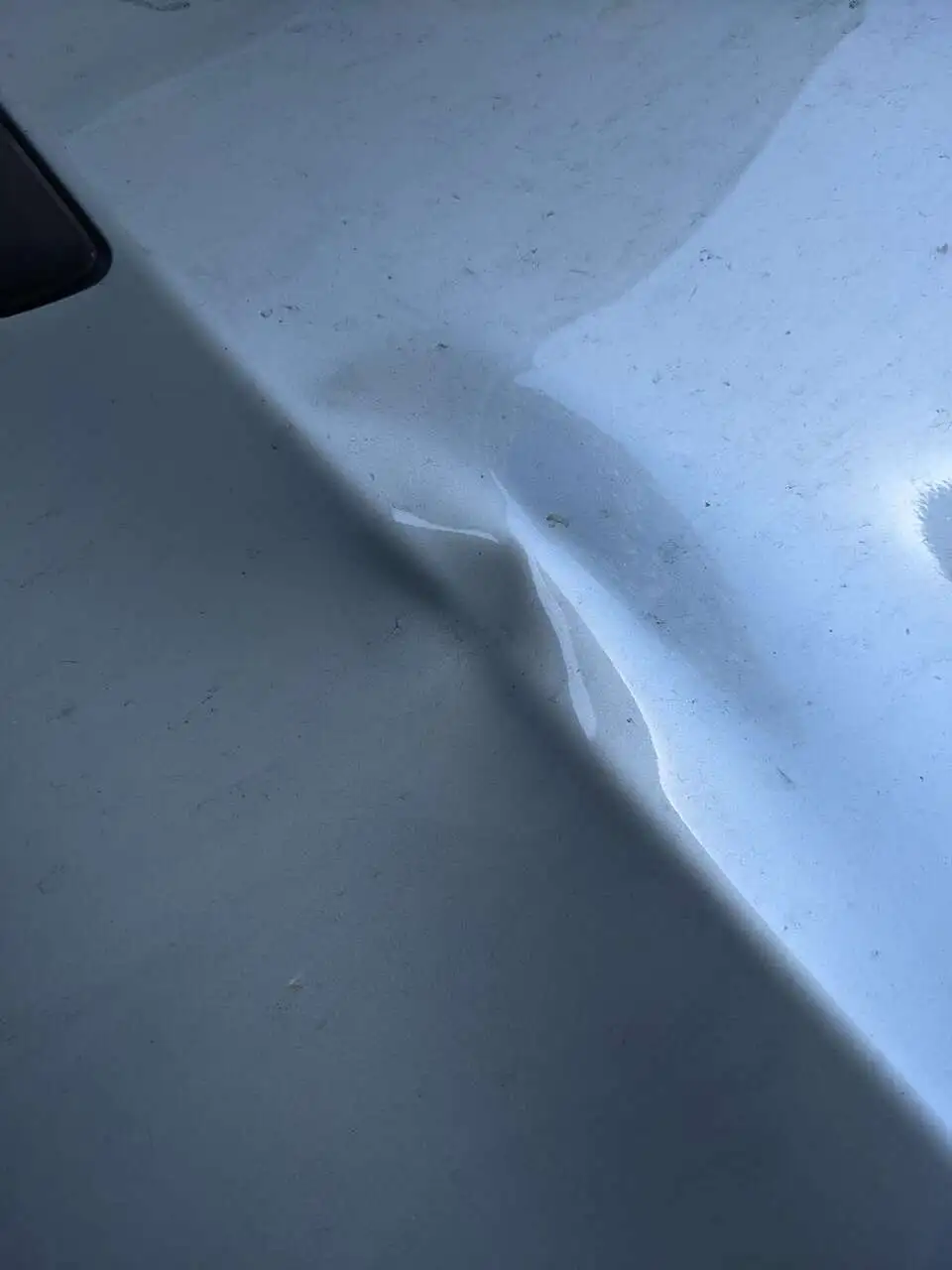

Hey guys,
Hope everyone is enjoying a three day weekend. I came out to my car to see this after parking. Any idea on a cheap fix? I prefer not to spend money I don't have to fix a cosmetic issue. I appreciate everyone for any helpful advice. Thanks

Since the paint appears to be intact, I would get an opinion from someone who does paintless dent removal. They could tell you what is possible especially along the fender crease. It's still going to cost you but not as much as typical body work. I was skeptical the first time I had it done & was amazed at the results. It's definitely an art form. It's very interesting to watch the work being done.

Because the top near the crease looks scrunched in...
Preferably, you should pay the deductible and get it fixed by body shop.
It's may be a $2000 job so let insurance pay for the hit/run.
In the old days we used hot water and toilet plungers to pull it out.
Nowadays they sell auto suction devices so maybe buy one of those. Saw one in autostore and they seem better than a plungers.
If that didnt work, a short 2 x 4 wood block up against the inside lined up @the corner/crease and hit the wood with hammer. This may not be as clean and possibly leave some bare spots in paint as well as the scrunched section near top crease may not straighten out completly.
If a newer car , make the insurance claim.
If over 8 years old, then maybe consider DIY.
Hit and run, use your insurance and pay ded. No way that's coming out with pdr for cheap. On body line and stretched metal = Bondo & paint after working out panel by body guy. Entire quarter needs painting and blending into rear door and roofline. Tail light, all trim and moulding needs to come off, along with quarter glass and wheel well liner for proper repair from a high quality shop. It is a $1500+ job. Eat the deductible. Then go back to parking lot and see if there are any cameras anywhere outside and try to get video from store.
Thanks guys! It's a 2018 Sport model and I have a $1000 deducible. As much as I'd like to fix it, it's not my top priority as it's only cosmetic. Upon further inspection, it may appear to be intentional.

Damn, that's rough. Personally I'd at least show those pictures to a PDR tech to see if they can work it out. Doesn't hurt to try, and it doesn't hurt to ask for a quote either.
I had a nasty dent like that in my Tacomas door a few years ago. PDR did a lot to make it look better but it was still pretty obvious it had been hit. Depends on how tolerant you are. The crease at the top will make PDR very difficult.
