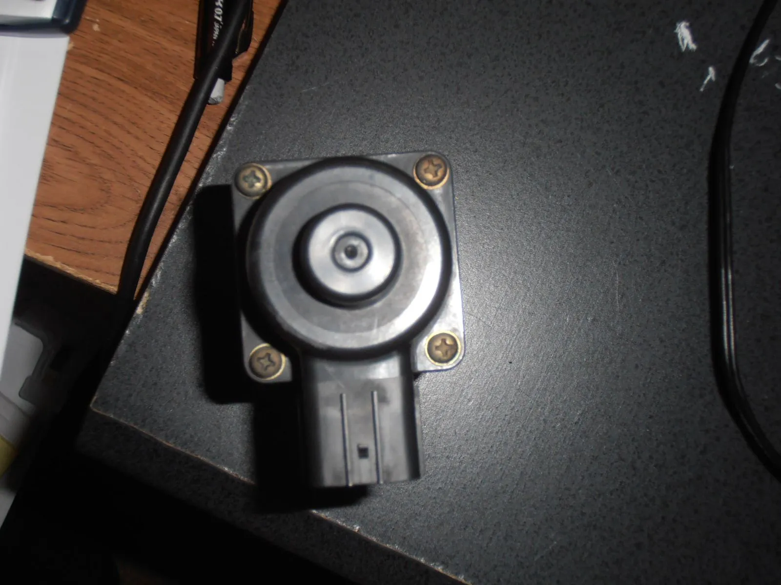

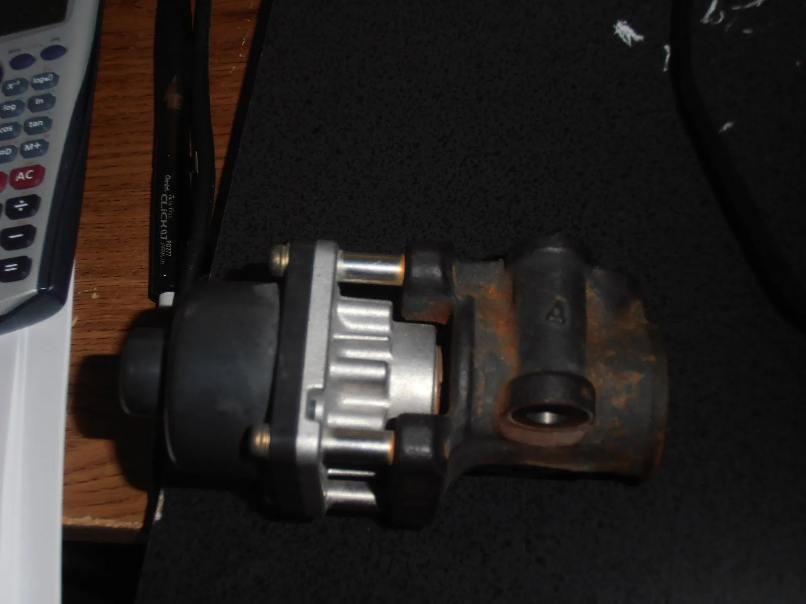

Well here are the pictures for the old EGR. I'm waiting to get payed from my job to order a cheap SRI see if the tubing helps, and also found the reservoir in rockauto for 36$ cheapest price yet.

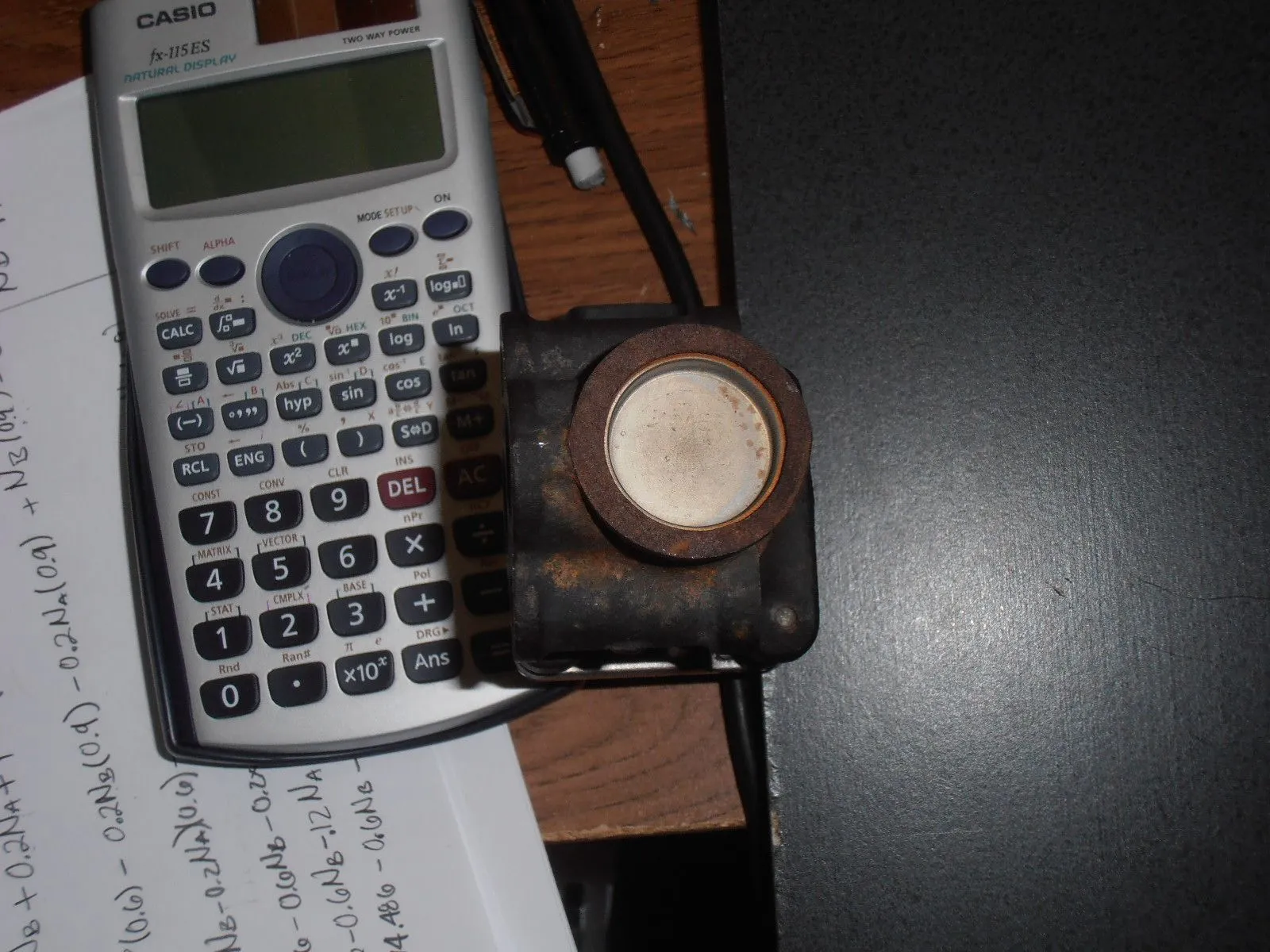

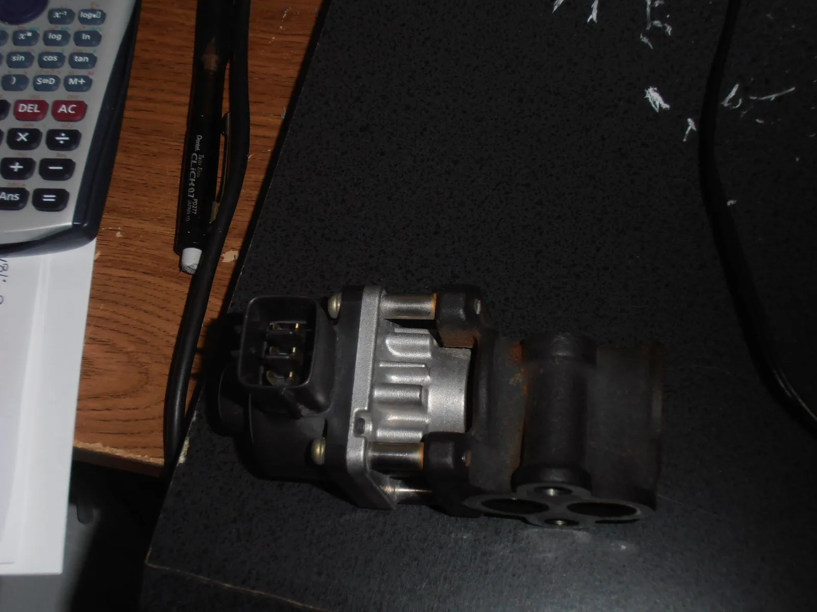

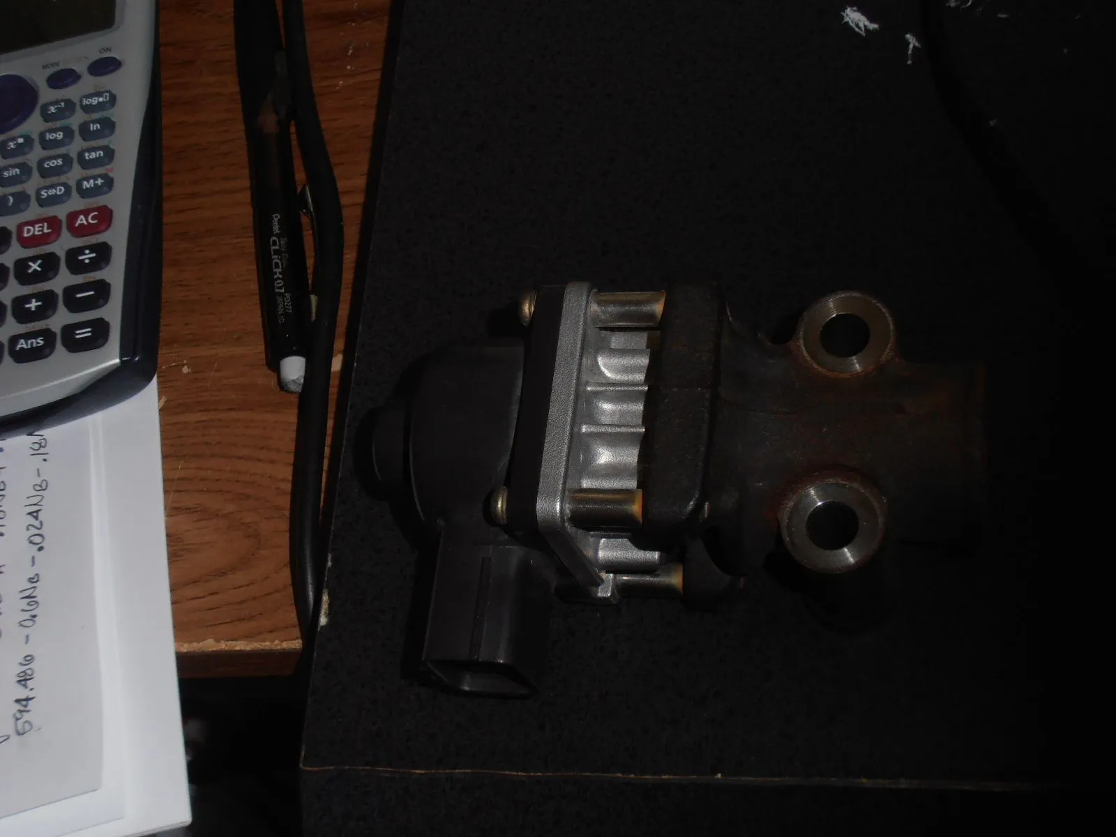

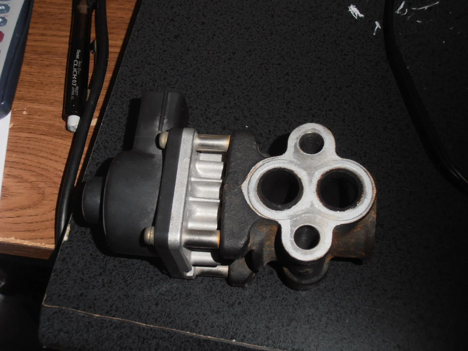

1st pic) Another pic of the old EGR from top view.

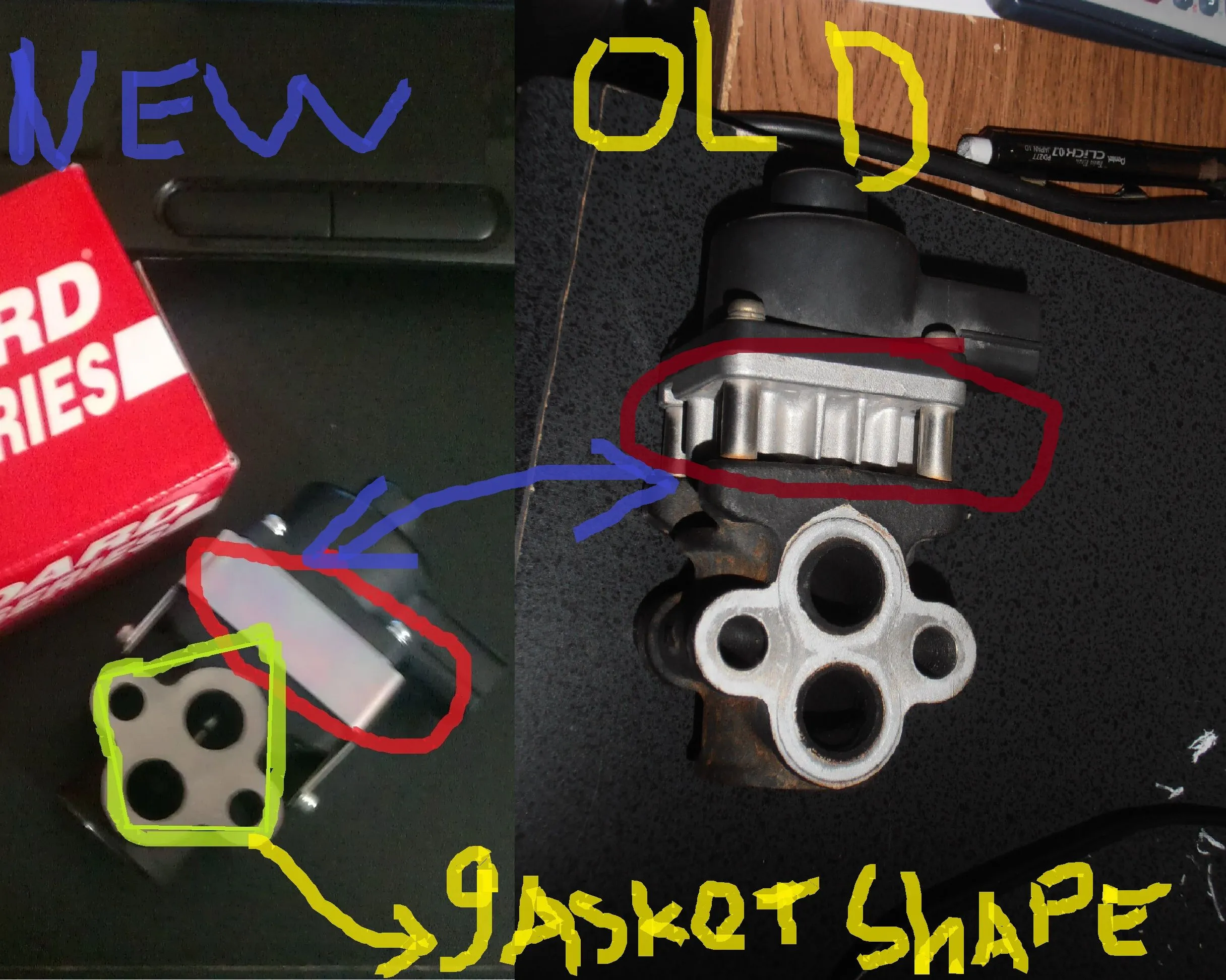

2nd pic) The new EGR compared to old but in red I circled the NEW aluminum cover that goes in the middle which the old EGR did not have. Pardon my pre-school drawings but I am not great at 'MS paint' Effects lol.
The yellow is for the gasket shape and you can see where I think the sharp triangular top side of the gasket may be laying on top of the new rectangular aluminum cover, and maybe letting air in through there.
3) Gasket change?
Any one know when it's recommended to just change the EGR gasket?? I could get one from advanced auto for around round 6$.

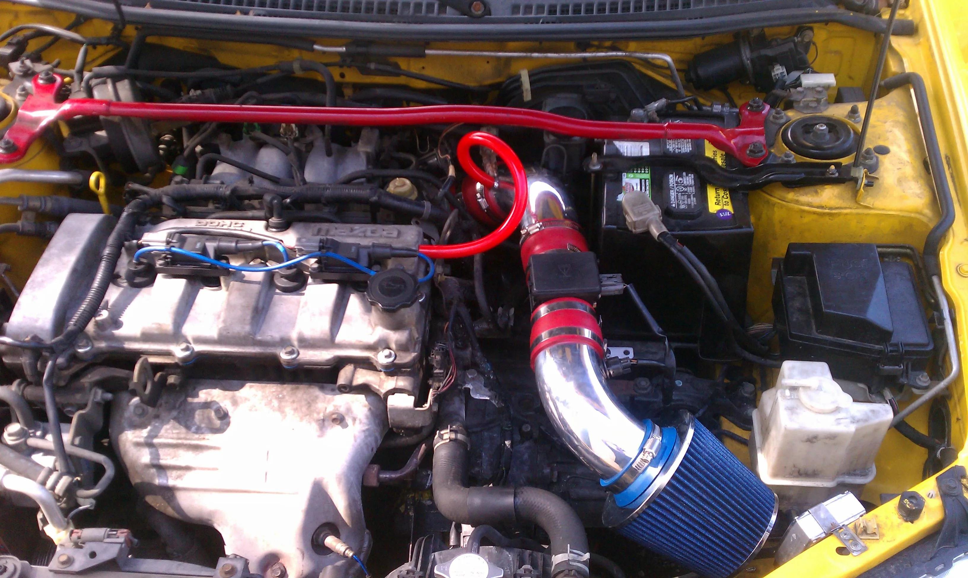

Replaced the vacuum hose and air box with an SRI from ebay, I made sure there were no leaks. The car runs A LOT better however it still does the idle problems on start up, and I did reset the ECU.
One new thing I noticed is that its now making a rattling noise from under the hood. It sounds like if you have stones in a tin can and then ever so often another noise that sounds like something that flips open and close and gets stuck and eventually the unstuck sound.
I suspect it's the throttle body itself. I was planning on taking it out to clean it next week, but how common is it for the throttle body to require replacement ?? and are these sounds likely from the Throttle body?
