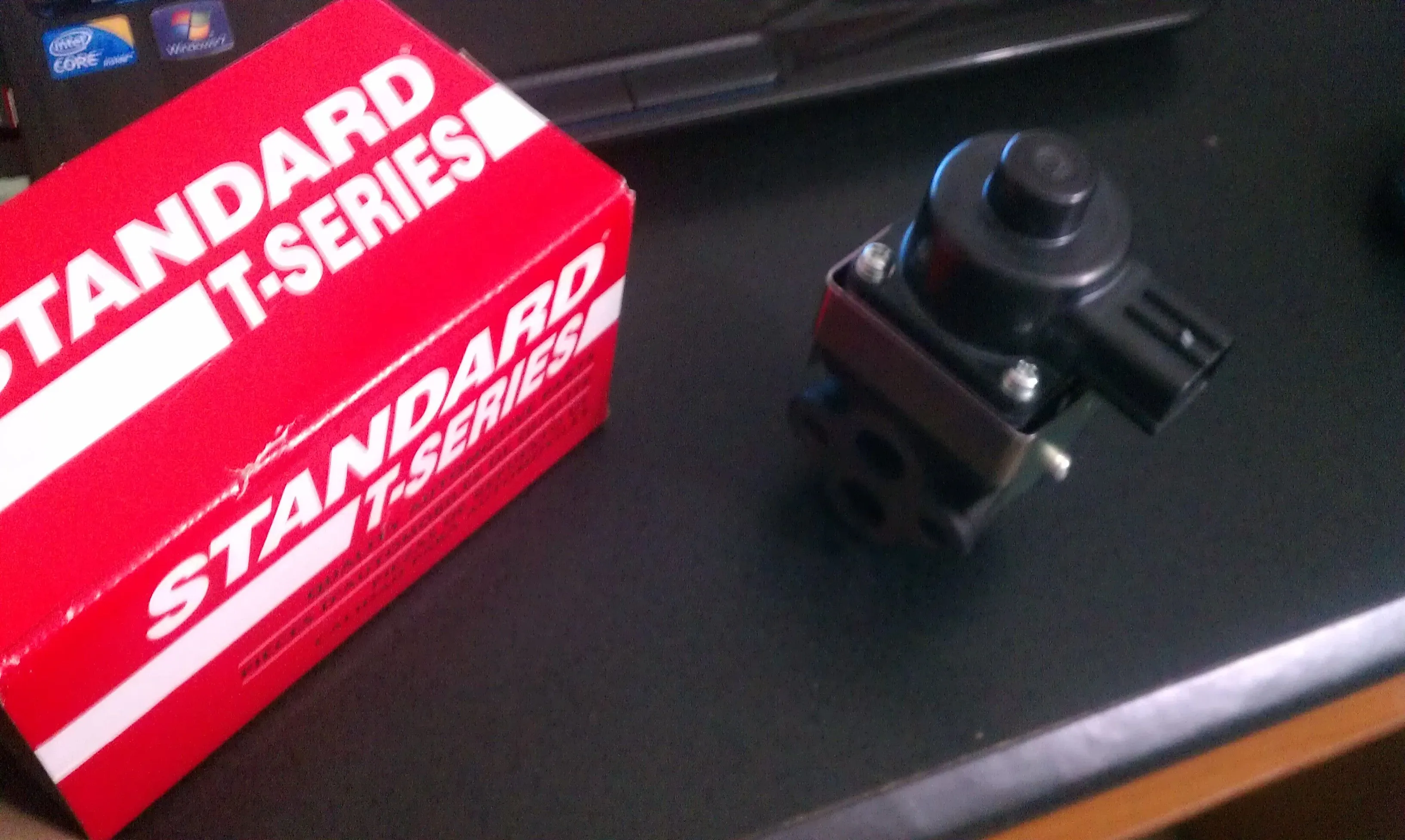

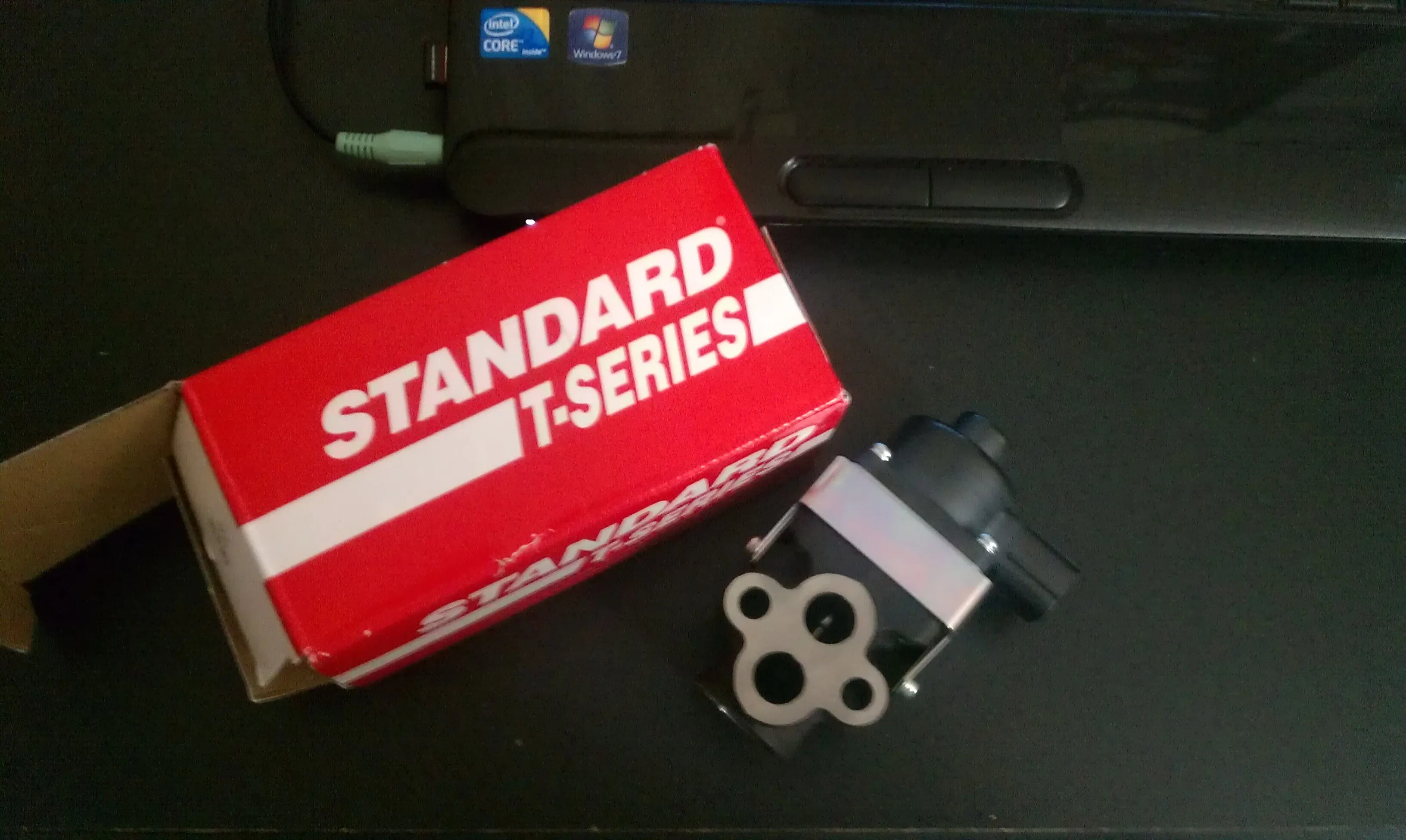

  • EGR- got EGR from rockauto (~$93 shipped). I may keep the car for only 2 more years & the other EGR seemed like more of a head ache.

Got the EGR pretty fast. Ordered Friday morning and got it today. I'll attempt installing it later in the week, never thought i'd end up enjoying some of this mechanic work lol.
You'll be regretting that :P
Wear gloves if you can, and give yourself some time to figure-out how to get it loose. I'd recommend using the lowest profile 1/4" ratchet you can find, you can do it with a spanner, but it's more of a pain.
I can take mine off with a ratchet and socket blindly in well under a minute. Not bragging by any means, but it is a fairly quick and easy task.
