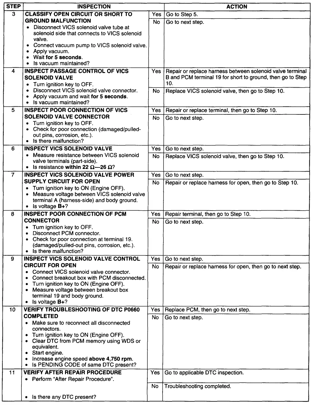

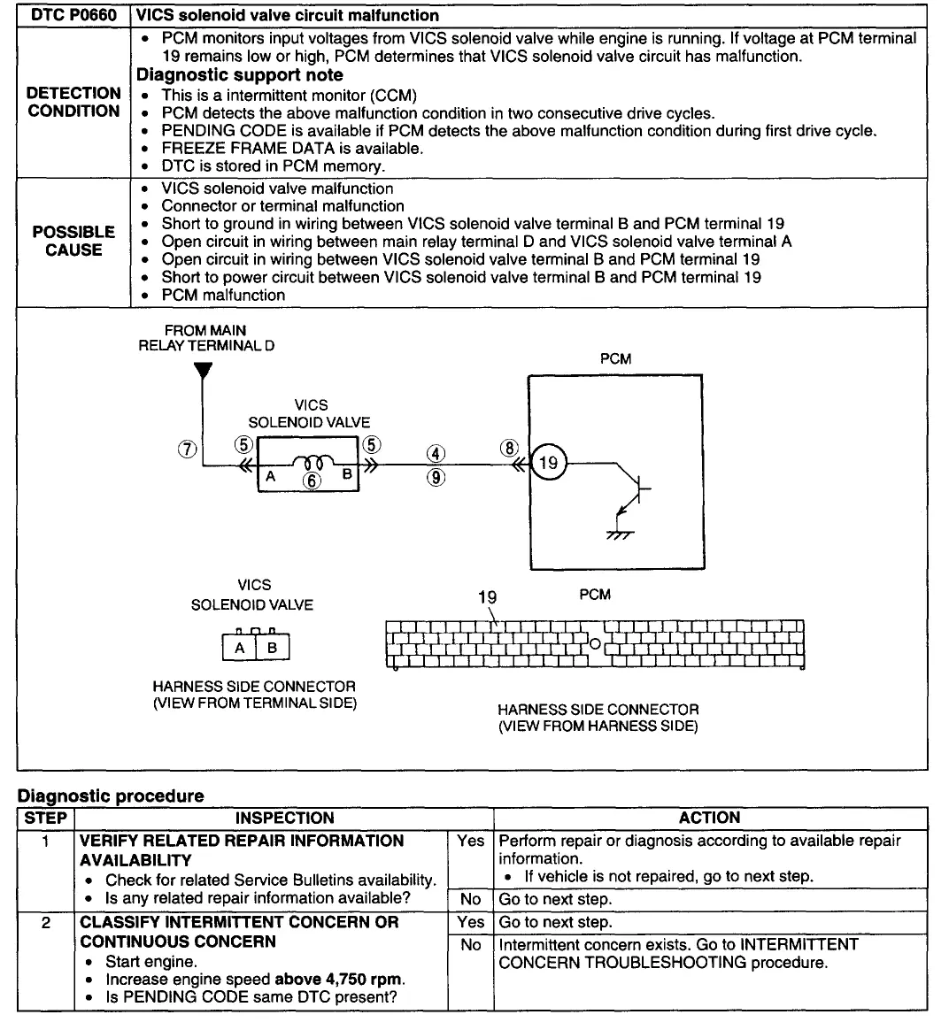

i have the P0660 too
Good find. Hopefully its just some smeg on the connectors that can be cleaned off. What kind of boost gauge do you have because you should see 20-22 a/c off or 18 or so with a/c on?
