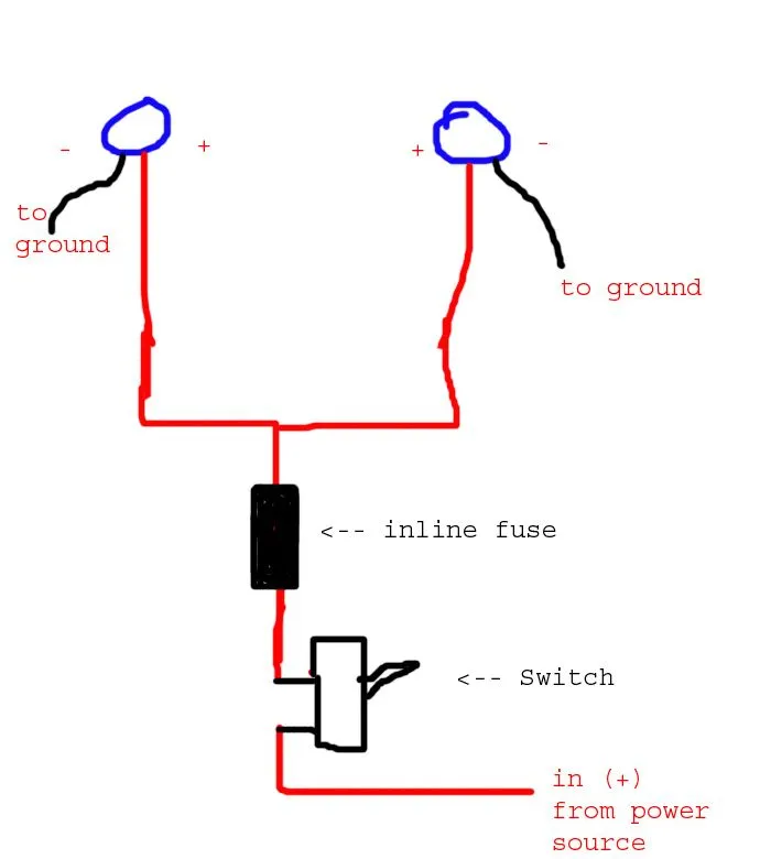

here is a diagram of how it should be
sooooo i should just run the power to the toggle and the eyes to the toggle and ground the eyes?
ill give it a try. so is there any way i blew the angel eyes? or shoud i check along the line somewhere for.....something thats blown if it wont turn on? well.....ill start with wat you told me and ill go from there.
correct
MAKE SURE YOU PUT A FUSE IN THERE!!!!!!!!!!!!

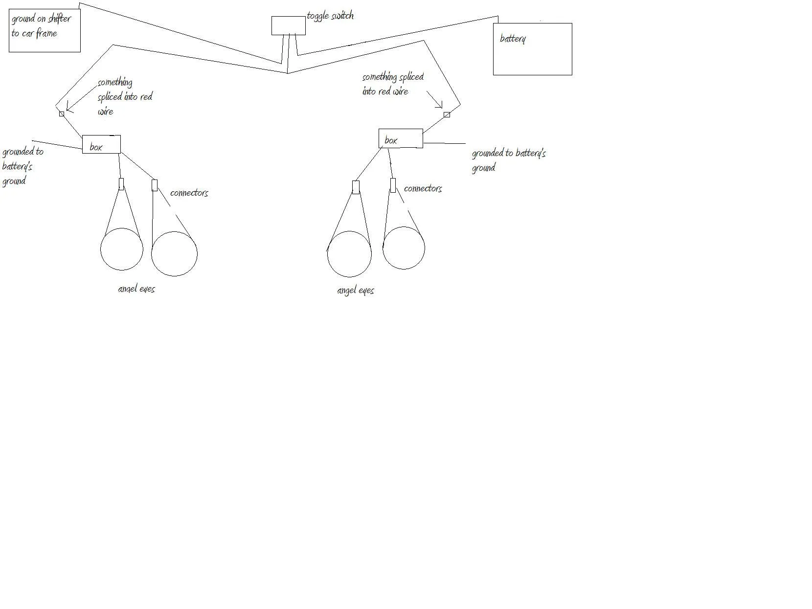

alright so i grounded the angel eyes to where the battery is grounded to insure a good ground...the only reason the toggle switch is grounded it so the light on the switch turns on...(i think because the light wont go on without that ground.) and upon turning on the toggle switch the wire starts to get hot and i dont even let it get to smoking.
(and where the hell would i replace a blown fuse along the way to the eyes?) ill draw a quick diagram so yoi all know what im talking about.
heres how it is.
i have a blown fuse or something because they ownt turn on now. i hope i didnt blow them because it was to my understanding the eyes already had a fuse built into the power wire. i may have to cut and splice and new one in each because of this problem. but the power was the only wire to get hot from the battery. the rest were fine.
have you tested ur angel eyes to make sure they still work? u can use the battery jst to see if they light up still.
the angel eyes do come with inverters, but even then... with too much power, the inverters can blow out.
the inverters work just like a resistor. it gives u resistant from drawing too much power. u could of blown those out.
if that's the case, it's hard to tell if the inverters are bad, or the angel eyes.
yea i tested them and they worked for a little but like i said they stopped and after a few minutes the wire started smoking. the resistors prob blew. should i just buy new resistors or should i just splice in a fuse box near the toggle? m pretty sure they do the same thing pretty much correct? if thats the case i should just cut out the resistors esp. if theyrr bad and use the fuse box i splice in as the fail safe....
if you can, replace the resistors. maybe the person u bought it from can also sell u some new inverters.
What size wire did you use. You should have at least #18. Note, the smaller the wire number, the bigger the wire and the more current it can carry without getting hot.
i ran 18 gauge. i checked the lights and they still work. i bypassed the resistor with a direct current to the battery for a split second to make sure i didnt need to replace the whole thing. were good to go. i just need to replace the resistors and figure out why my s*** fried itself. i gave a diagram on how i have it set up with 18 gauge wire as of now. any input on what i can do to fix this would be awesome. any questions will be answered within an hour because im fixing this tomorrow....or rather....i have to fix this tomorrow. lol. thanks for all the help guys.
aside from what rotus said i have no more ideas. But judging from what you said and the wire that actually burnt up i would say you need to get a heavier gauge wire. you did say that the wire from the battery to the toggle is the one that went up right?
yea thats right. none of the others showed any signs of problems.
i dont know what kind of current the battery to the toggle switch is but im going to try a thicker wire with a better insulation and see how that goes for now. its a cheapo wire i have had from walmart so im sure its garbage. ima go down to radioshack or something and try some better wire and re-do it all. ill let you know tomorrow afternoon how all goes.
btw its a diode thats spliced into the red wire. dont cut that out...ever. theyre good for like 1000 v. those will prob never blow.
