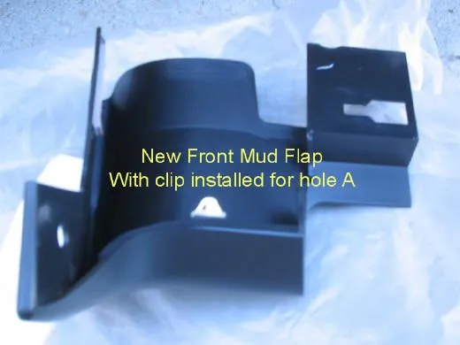

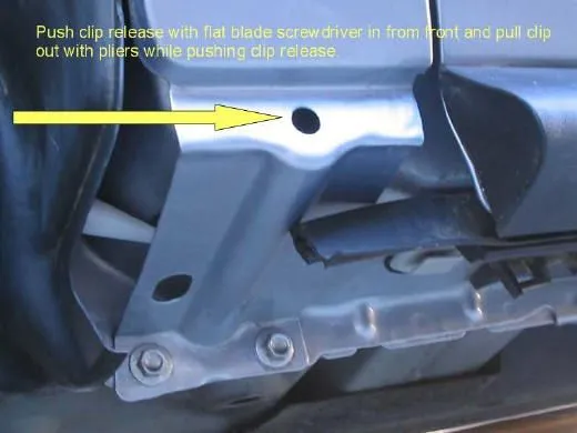

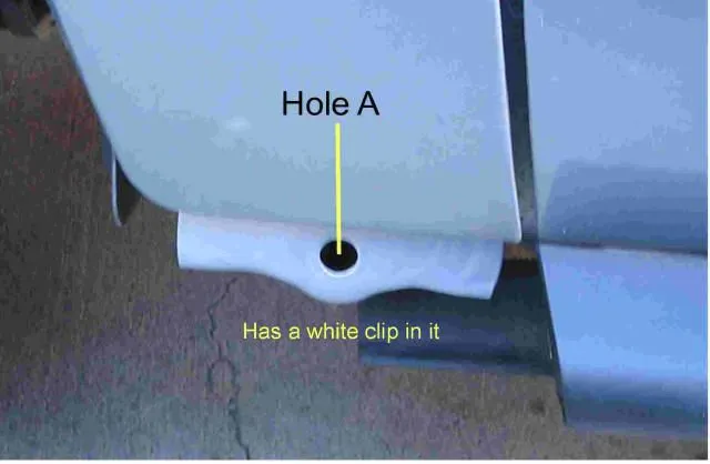

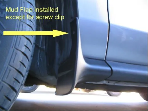

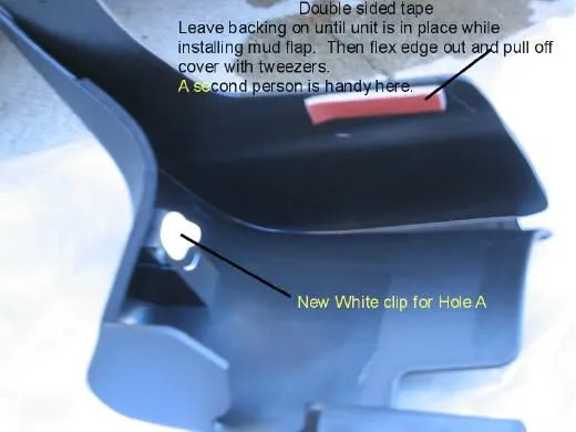

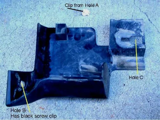

I installed the factory mud flaps.
The rear ones use 1/4 turn fasteners
The front use screw out fasteners.
Rear took about 30 minutes, including staring at them and going slow on the first one. You do not need to remove the tires or the fender wells to do these.
These pop off. The driver side rear have an extra box covering a portion of the well that you need to get loose so having that wheel off would have been quicker than fooling with it to get it off.
The fronts took longer as I did not want to damage car/stock covers.
The instructions tell you pull forward to release the clips after removing fasteners and screws. But you cannot as the rear portion of these are behind the fender sheet metal. Rotate enough to unhook the clip on the bottom then just pull out to pop cover off the clip on the side. Then use a screwdriver and push clip taps by inserting it behind fender from wheel well and pull with pliers. After learning that it took about 5 minutes to do the other side.
The originals do not have tape holding them. The new ones do. You do not need to paint the wheelwell where they go. Just clean really well and then go over it with alchohol. Leave strip covering the tape on until mud flap is mounted on both clips. Then flex the front edge forward and pull off cover strip with tweezers. Done..
