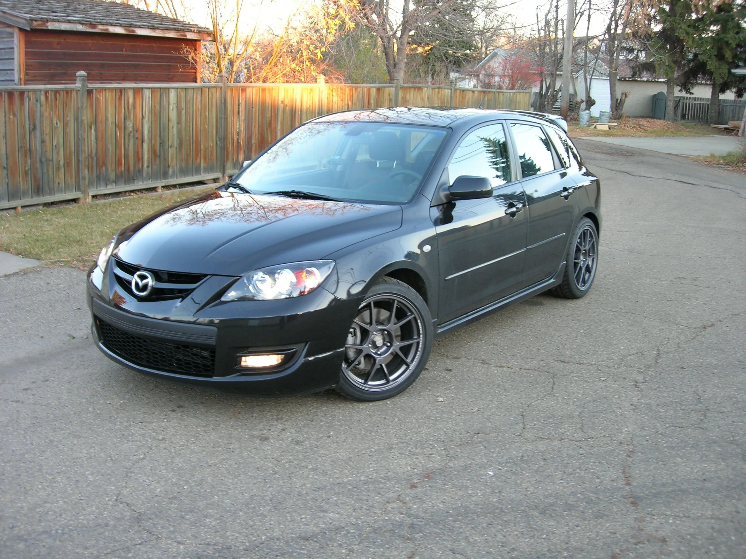

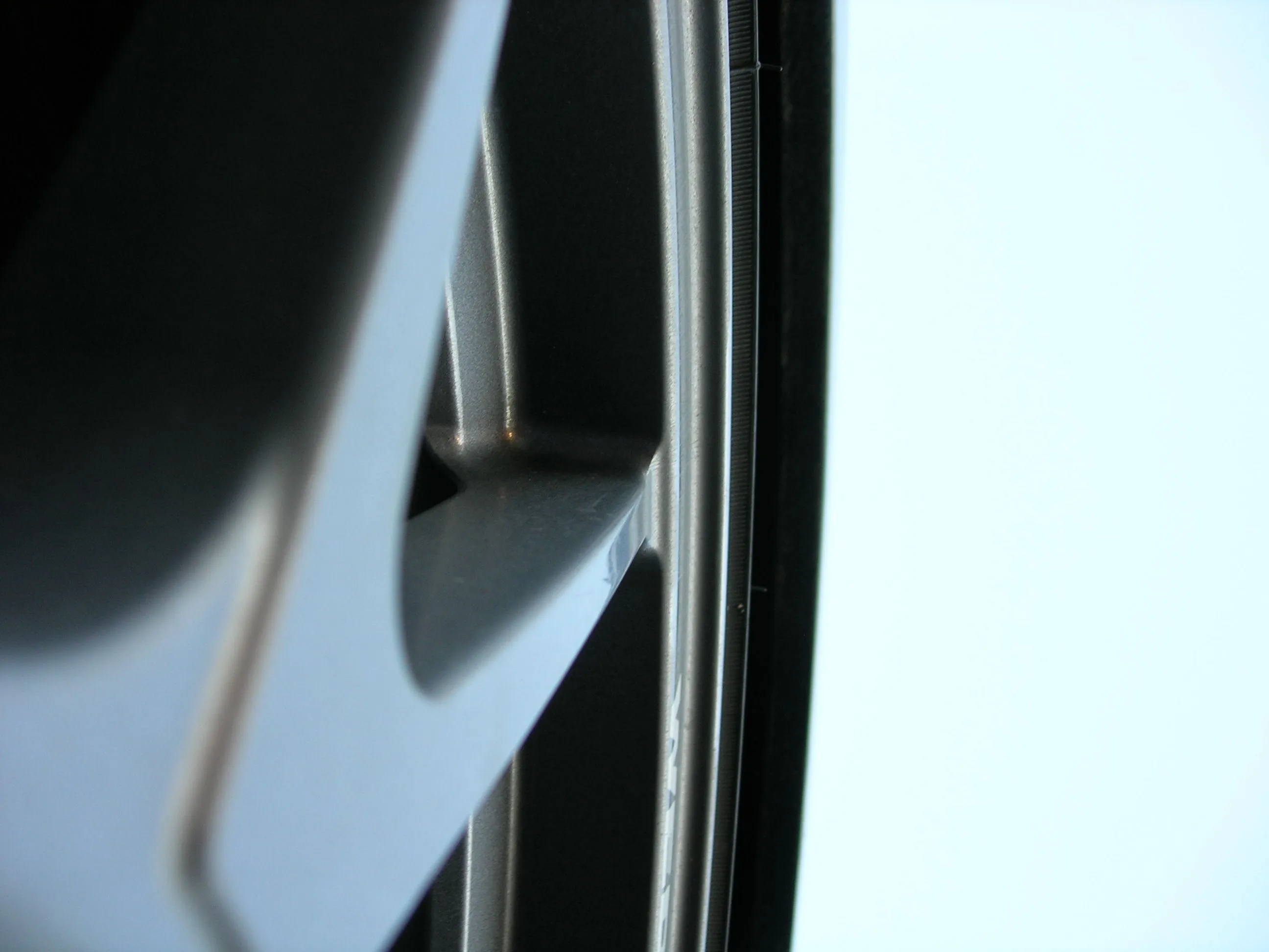

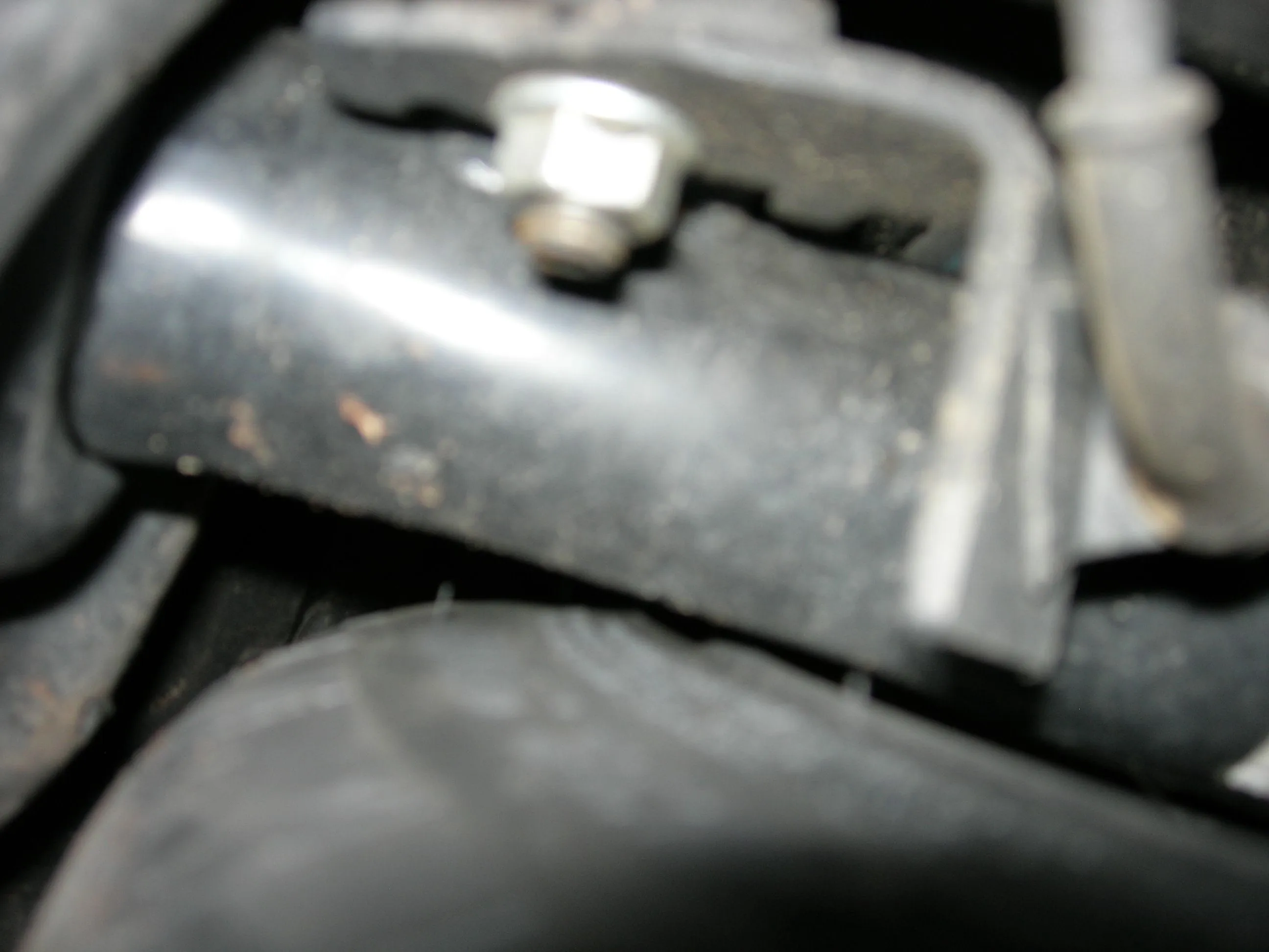

18/8.5 53mm. The widest that will fit with proper factory offset.
NICE!!! That is bad ass! Thanks for the pics man! that is awesome. How much room did that leave to outside in the front and back?
Also, are you running stock suspension? And how much do you think that you could lower now?
I am looking to run either the Tein SS coilovers or the KW variant2 coilovers... both have pretty high spring rates, but i would still be worried about destroying the fenders without rolling them.
Thanks
It is stock till the snow melts; I have a set of tein ss coilovers waiting to go on. The front looks like it will be fine, however the rear may need A role to clear, it will be close. The pic I took show rear fender clearance did not work very well. I'll post it anyway.
If it does rub I might just have another excuse to dial in even more redicoulous amounts of negative camber(shady).
