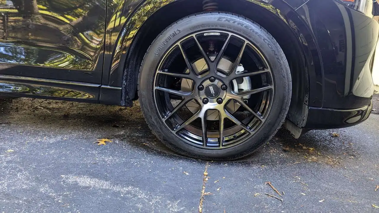

I have upgraded wheels, brakes, and tires. Running the Continental Extreme Contact DWS06 Plus after a lot of research.
If you run in a lot of snow, I'd say get the Michelins. Otherwise, the Continental is the better tire from all of the data I've seen (and I do love them so far).
