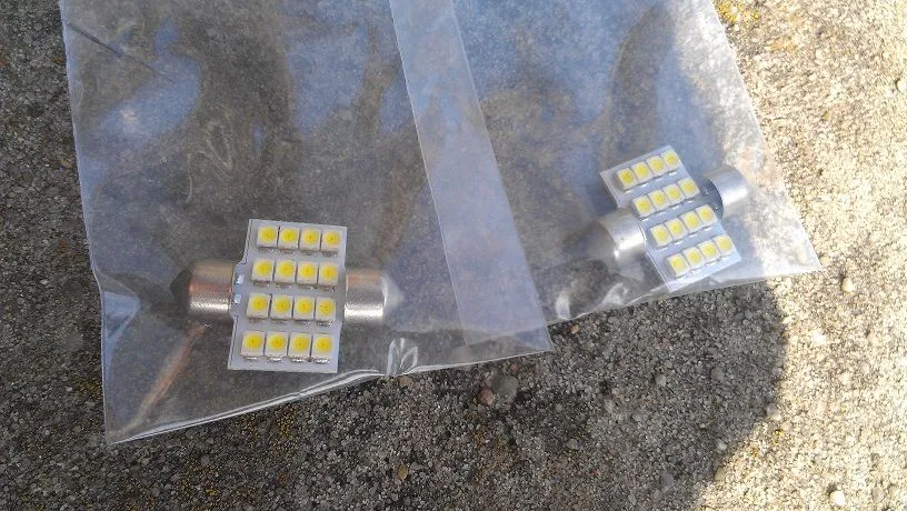

So the interior lighting for the front map and rear dome lights are all festoons. I ordered two extra pairs (4 total) and have no use of them. New. Direct snap in replacement for the festoon dome light. 16 LED's, color output is PURE WHITE.
$12 shipped for each, $20 shipped for a pair, or $30 shipped for four... U.S. buyers only, don't want to deal with international shipping.
