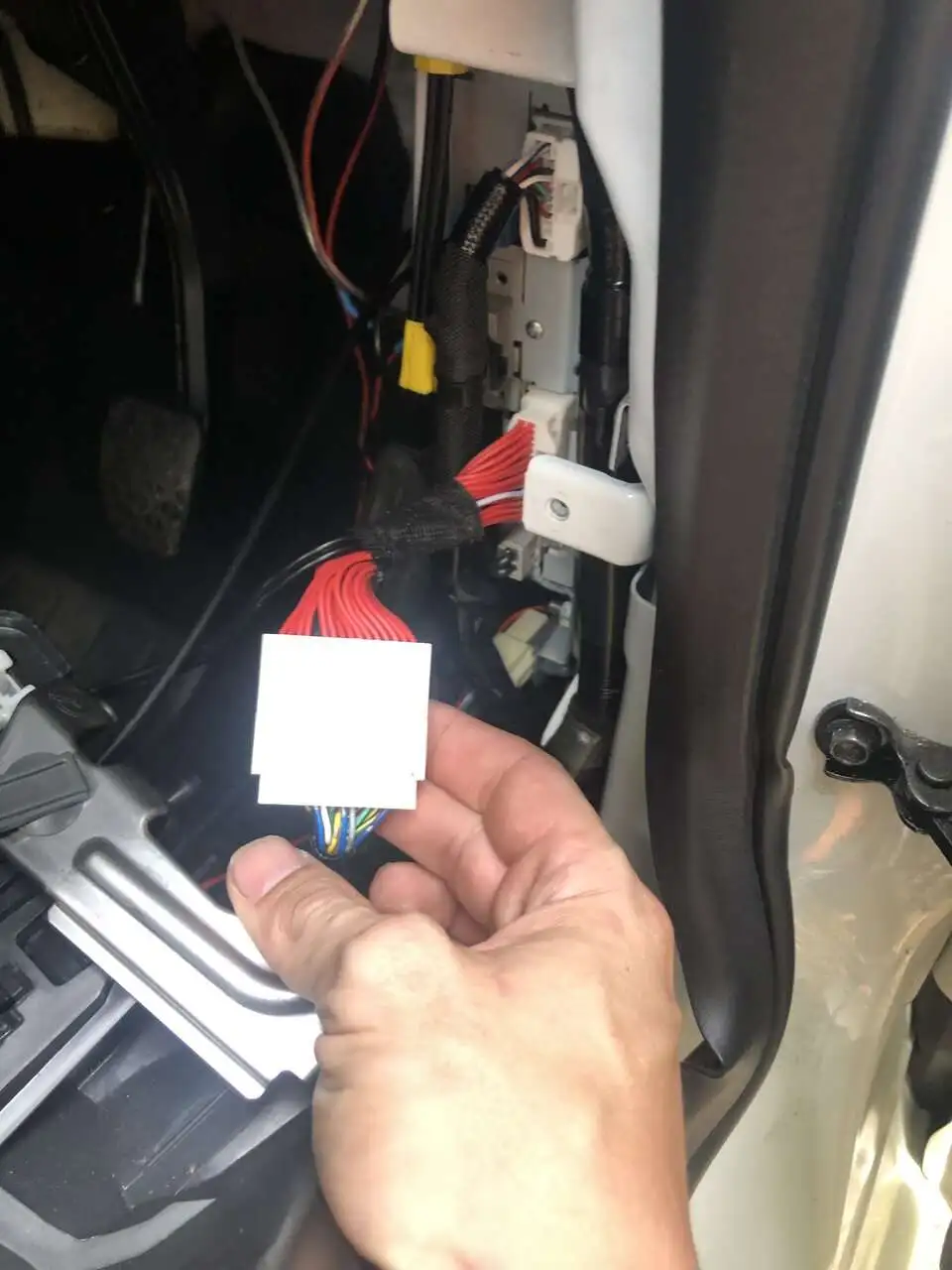

All functions working normally. I completely bypass the boss amp using my own DSP- digital signal processor and amplifiers. We cut the wire from the bose plug and run new wires to the amps and new aftermarket speakers and sub. Later i noticed the Mazda 2016 + up has TAU - pre amp which probably manages to work radio and CD player.

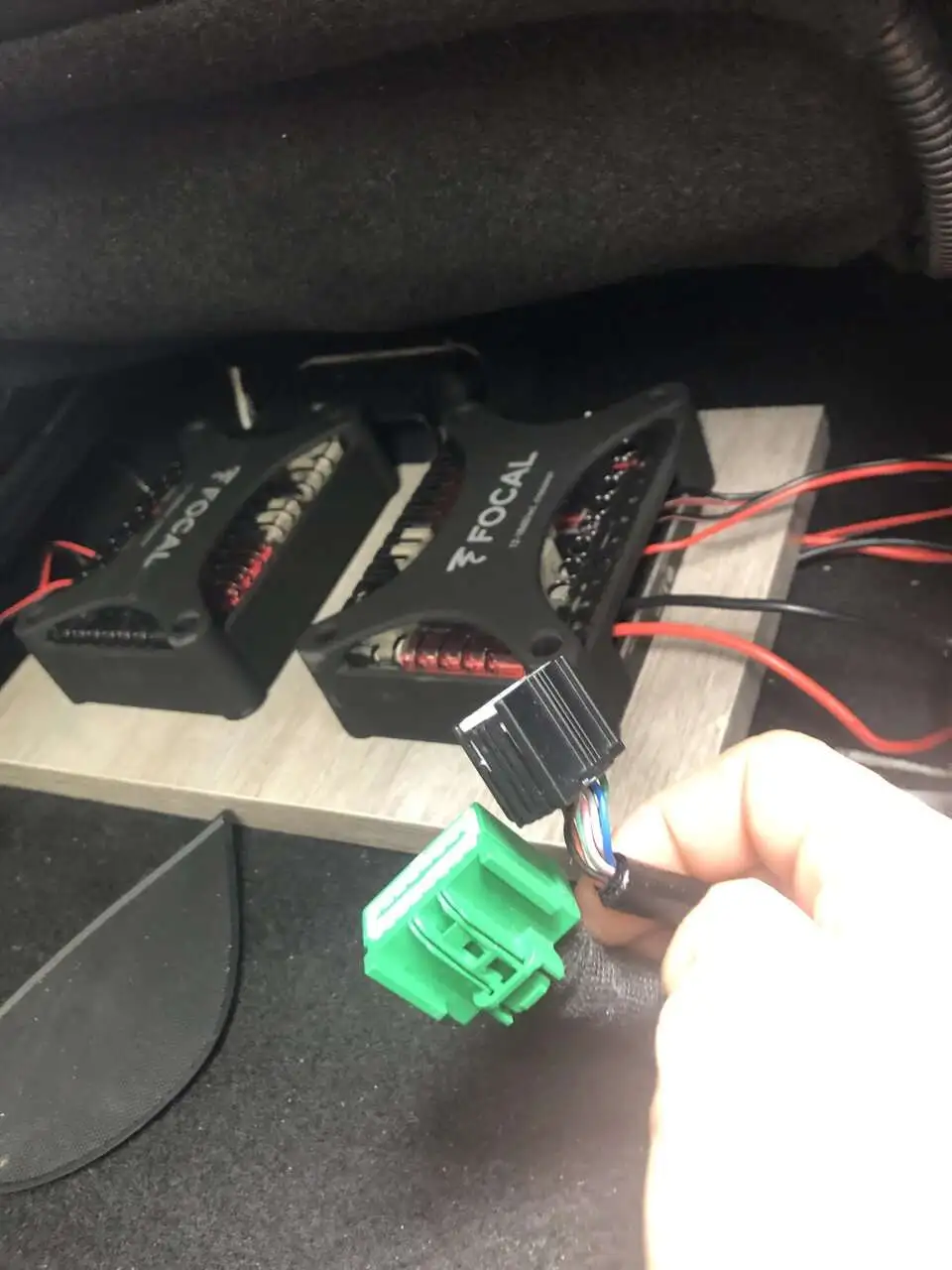

Does it have to do something with the black and green plug which originally went into the bose amp?

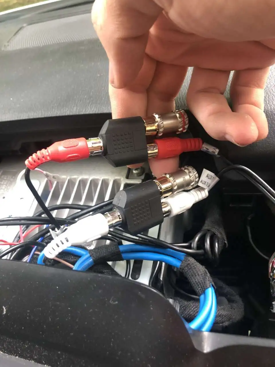

I as well attach pictures of when i connect the aftermarket plug with RCA to connect it to the AUX output radio using a splitter from the Aux output im running 2 RCA into the DSP input. I would really appreciate the direction and help as I'm getting completely lost and I'm not sure what I did wrong.
