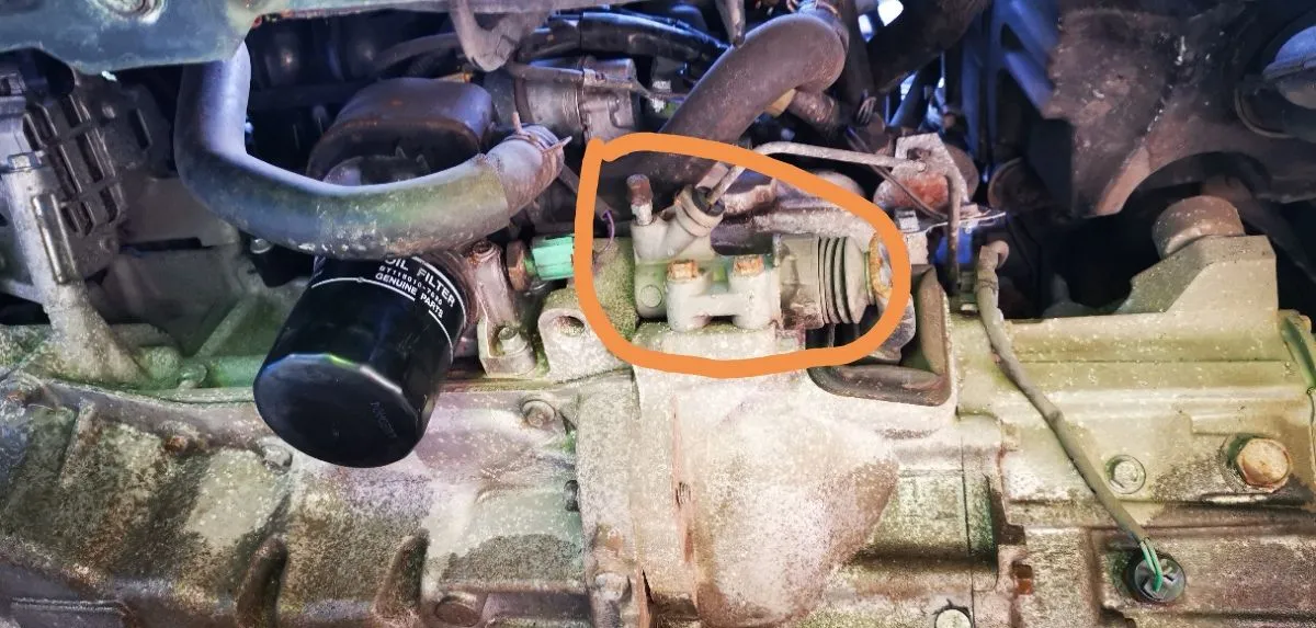

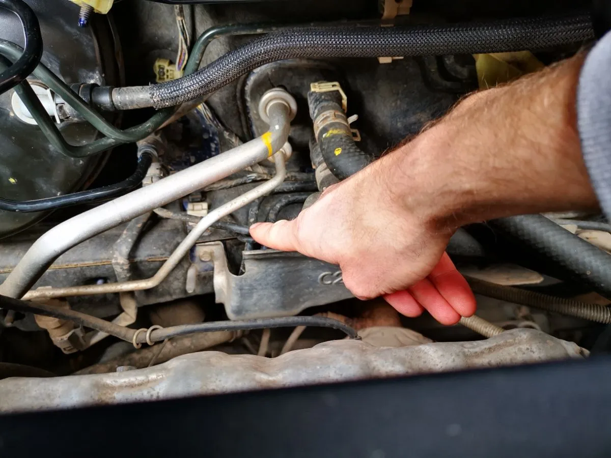

Hi I will check clutch slave cilinder this usually cosing problems to change gears. Just follow metal pipe coming from clutch see my pictures is probably under battery by gearbox. I can't show you exactly as I will have to remove all plastics.

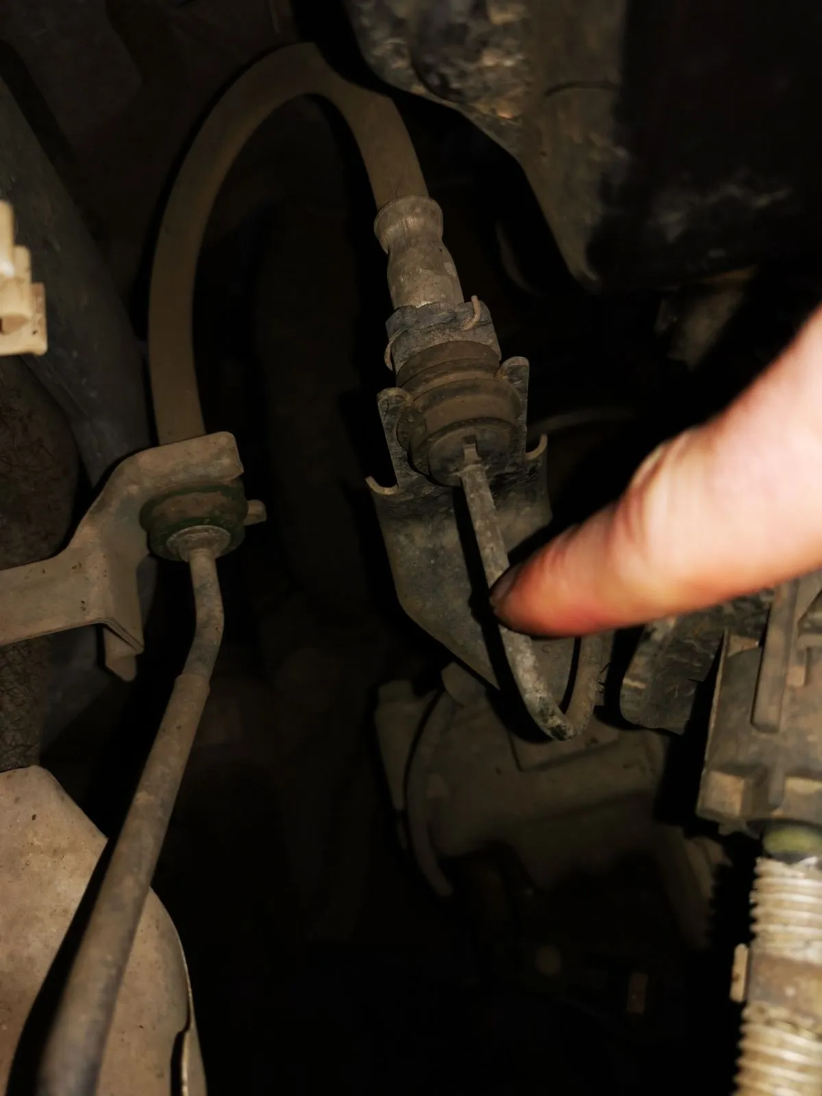

I have bottom cover off today so I took picture for you, please check this part.
