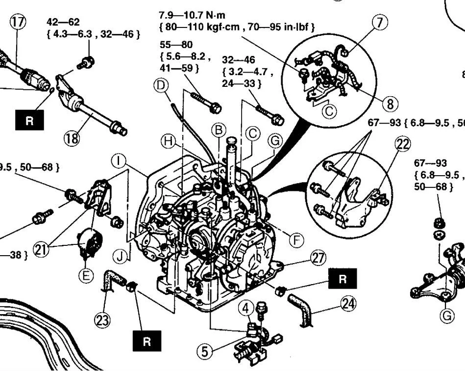

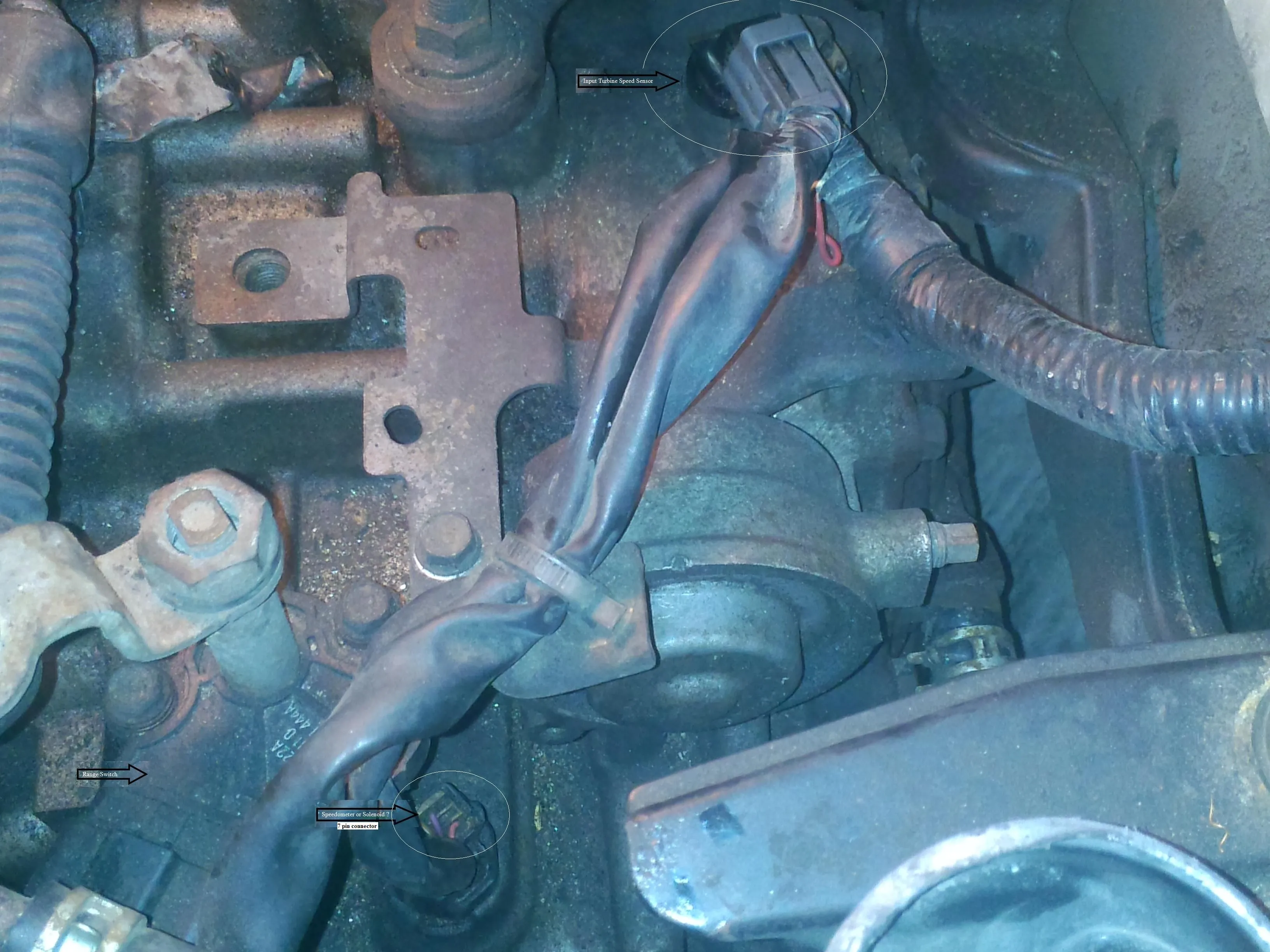

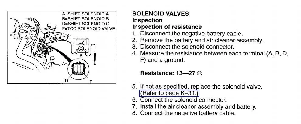

Hi everyone, I have Mazda protege 97 lx 1.8L and I want to inspect the solenoid valves, but I can't locate the connector. The attachment diagram shows the connector of the solenoid, but after searching I didn't find any connector on that locations. I noticed one difference that is the the diagram shows two wire harness for the speedometer but there is a connector of 7 pins instead of 2 pins connector. According to the following attached diagram the solenoid connector should be 4 pins and the speedometer connector should be 2 pins as mentioned in both the following diagrams. Here is confusion whether they have combined both connectors and made one connector for speedometer sensor and solenoid valves. Can any one help me to solve this puzzle? Thanks.
