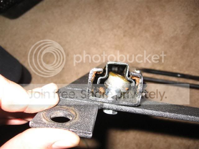

As I mentioned before, I ordered new seats. They should arrive tomorrow, and I won't be driving Dory for a while, so I decided to pull the seats tonight. Working on the driver's side, I noticed a ball bearing on the floor. Uh oh.

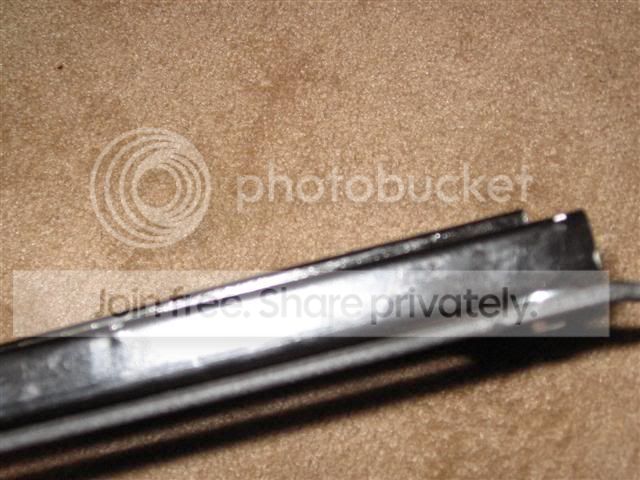

I took the corbeau slider off the driver's seat and noticed something was definately wrong, as that slider should not be crooked.
Took a peek inside, and found this: That roller is supposed to be at about 90* from where it is, upright, not flat on its side (like the 1 at the far end). Anyway, e-mailed corbeau w/ pics, and I hope to hear from them soon.
Fortunately I've got 3 weeks before the next event to get these situations sorted out. Hopefully the clutch will be done by this week. I can go ahead and mount the seats as well. The passenger side should be 100%, and I still have the 'KCBHIW special' bracket that will mount up to the new driver's seat and use the stock sliders temporarily. Hurray for spares. Now I just hope I can drive the car just long enough over to TinmanMS6's house to borrow his garage for a night and get the new hydraulic bits on the car.
