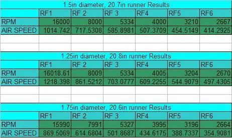

I've also been making some progress on the new intake manifold!
I've been playing around with the formula's, Trying to work out what the best balance between runner length, performance and airspeed is going to be. I'm trying to keep the airspeed at some sort of reasonable level because i'm concerned about airspeed impeeding flow. I need to find some formula's that equate velocity to flow in a given sized pipe to help me get a better target. Obviously once i've got a ball park on actual flow, i'll be able to see if a) the head is going to be able to flow that much air, and b) if the runner diameter i've selected will be able to flow that much air also. Both of these are critical factors - because if there is a bottleneck in the runners, or in the head, the whole thing won't work as intended.
I'm also having to make some compromises on the manifold design. Due to the length of the runners, I can't make them straight and thus I can't taper them. Idealy speaking, a 1% to 1.25% taper should exist along the length of the runner - I simply can't do this because of the path the runners are going to have to take. So to get around this, I will be using some rather aggressive velocity stacks in the plenum chamber to further assist in ramming the air into the runners. I need to find some formula's to see what effect these trumpets will have on the runner length - because in theory they should make the runners shorter (and it may simply be a case of getting the same overall runner volume as if the velocity stacks were not there). Any help would be appreciated :)
Another problem i've got is measuring the distance from the centre of the intake valves to the centre of the port they belong to. This distance makes up part of the runner (so with 20in runners, if the distance from port to valve is 3 inches, i only need 17in runners from the port to the opening of the velocity stack....). Kinda hoping Kooldino has a head off a car right now and can measure this for me ;)
anyway, attached are some runner calcs I've done. This first set of 3 calculations is done tuning the 2nd reflection to around 8000rpm to get a runner length, and then working out where all the other reflections occur. As you can see by these numbers, I will not being using reflection number 1 with these runner lengths. These numbers are tuned to my cams and i'm not 100% with these numbers yet so don't go using them because I can't be sure they will work! :P But it is interesting to see what effect runner size has on where the reflections occur, and what the airspeed (in ft/sec) is.
My next experiment with the math is to tune to the custom headers so the kick occurs at the same time that scavenging is due to occur in the headers. This will result in a bigger overall kick, but will probably also mean longer runners.
Other considerations
Just putting some things to consider in here:
Observations
1) the larger the pipe diameter, the shorter the runner needs to be - I believe this has more to do with the change in the overall volume of the pipe than the length of the pipe, but I'm not 100% sure of the relationship.
2) the higher the cam duration, the shorter the runner needs to be
3) the larger the diameter, the slower the velocity at the same RPM and volumetric efficiency.
Consider
1) What effect would a trumpet/velocity stack have on runner and ram tunnel length (given that it is effectively increasing the volume of the pipe) - In theory it should shorten it - but by how much?
2) What effect will pressure drop through the ram tunnel, plenum and runners have on the final pressure at the valve (the longer any of these are for a given diameter, the more the pressure drops. The larger the diameter for a given length, the more the pressure drops.). What effect will this have on the overall effectiveness of the manifold in generating positive pressure at the valve?
3) what is the maximum airspeed through a pipe of a given size before turbulent flow and restriction is introduced? What effect will air horn's/velocity stacks/trumpets have on the airspeed and will they work against me by exceeding the maximum flow of a given pipe (i.e. will i need to run larger pipe diameters if i use velocity stacks)
4) i'm of the belief that the resonance will occur more than once at and around each of the RPM points. Reason being that there will be a period of valve open time at both as it starts to open, and almost closes. What effect will this have? how wide will these "kicks" be - and should I alter the target RPM points to attempt to get a level of overlap between each pulse - what effect on the power curve will this have?

Are the calculations for runner length after the throttle? Will you go MAP and individual throttle on this project? Since you're running Microtech, it's possible, and it might make custom runner design much much simpler (although it might take some work to fit 20 inches worth of runner under the hood and still put an air filter on them.
I can't answer any of your conundrums, but I have to say...
I can't wait for you to post up on headers... :D
Headers are completely designed, no more conundrums on those, i even have the pipes bent, ready for cutting and welding..
The intake manifold - well... thats what i've got the conundrums on.... I already run MAP (microtech wont tune on MAF) runners are after the throttle. And after the plenum. It goes, Ram pipe, TB, Plenum, Runners.
I'm not going individual throttles. Reasons are 2 fold. Firstly, the car is driven (mostly) by my wife. She couldn't handle the obnoxious sound of individual throttles. Secondly, it would appear that a ram tunnel single throttle design will yield a far broader power curve, and in some cases, more peak power (if tuned correctly). I considered ITBs. I even have a set of throttles under the house ready to go (donated from a 4age 20 valve blacktop).
Another potential problem with quads/itb's is tuning. You can't tune on MAP because you can't get a consistant vac signal. So instead, you tune on throttle position, which isn't the best for street driving.
so for now, its going to be a single throttle, Helmholtz resonator, ram tunnel manifold.
And yeah, 20in of pipe is a heck of a lot to fit under the hood. One saving grace is that the runner length has to encorporate the distance from the port opening to the valve opening - so that may allow me to shave a few inches off the actual pipe i need to fit under there.
