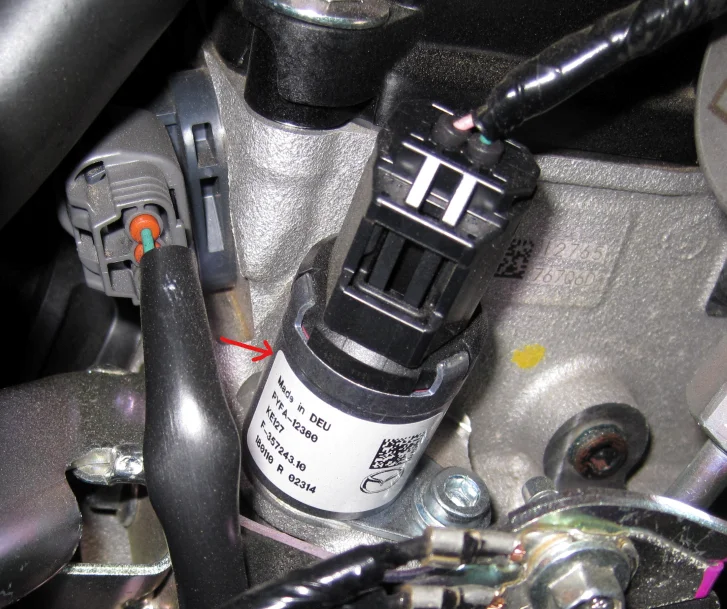

As far as I know, the 8th character VIN method of determining whether a CX-5 has cylinder deactivation is reliable (L = without CD; M = with CD), but if you want another way to tell, look at the cylinder head. If it has one of the things in the attached picture on each end, the engine has cylinder deactivation. Those are solenoids that control oil flow to the switchable valve lifters that turn CD on and off. They're both fairly easy to see, but the one on the driver's side (assuming USA models) is toward the front of the car and the one on the passenger side is toward the back.
