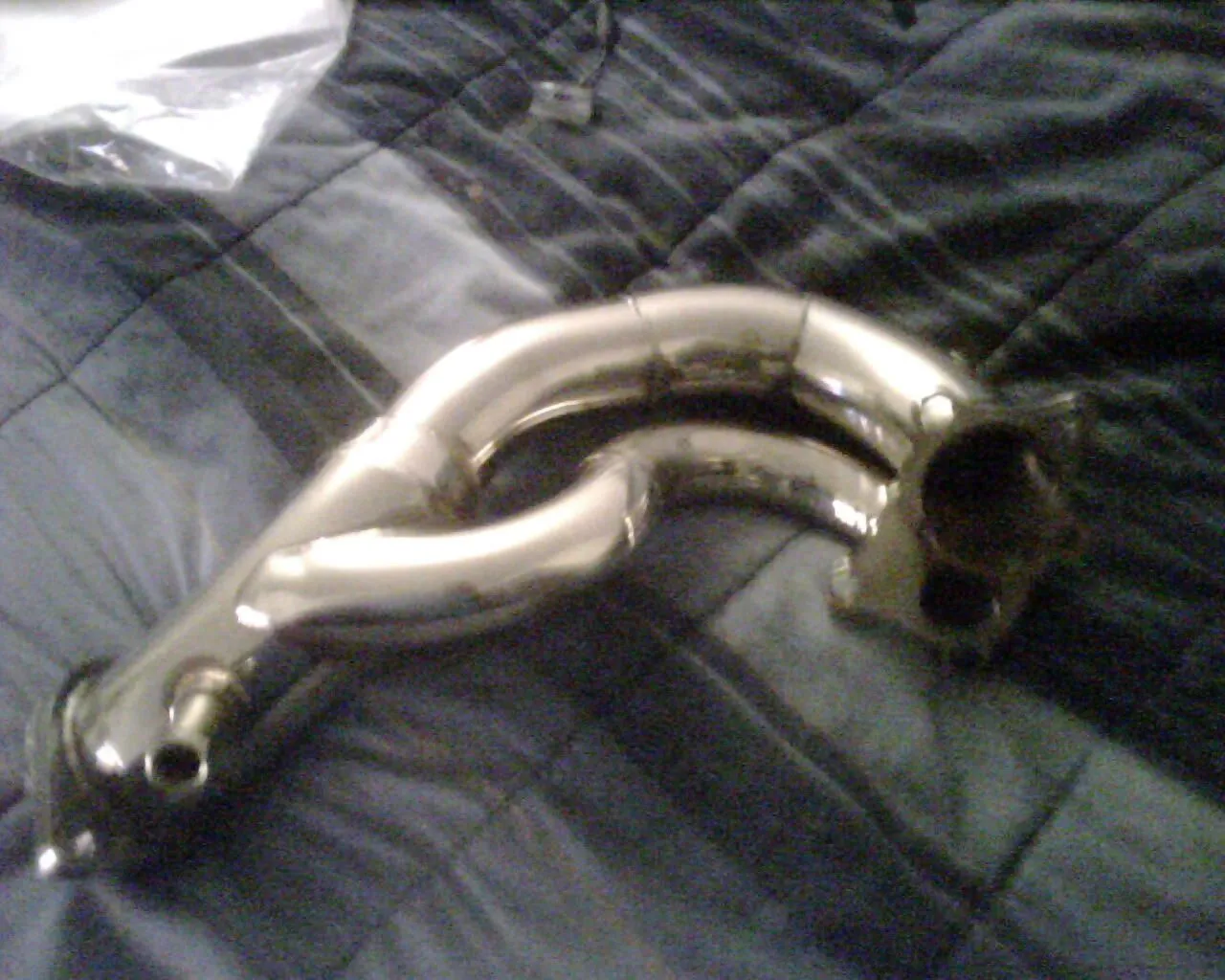

Look at what UPS dropped off. Courtesy Of PG
oskinosmee
07 mazdaspeed 3
Does anyone know how much it will cost to put this on?
PBblaster and PATIENCE for the 02 sensors. rent the 02 socket from autozone if you don't have one, and return it when you're done.
No air tools needed. Patience is the main theing you'll need though... :D
follow corksport's instructions and the O2 is easy to get off. I used pb blaster instead tho
I see you have it on your bed. I know it's really cool and has lots of holes and you're very excited to get it.....but man do you really need to sleep with it?
Okay maybe i will try.
Thanks Guys
