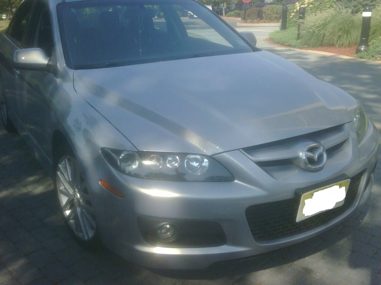

I've had an MS6 and been a member of this forum for more than 2 years now. I hadn't really been a part of the forums except for getting info and parts, but I want to finally introduce myself. Name is Mike. My car is a daily driver, I haven't really modded it much since college keeps me broke. I actually decided to mod a little bit when I had my VVT actuator replaced with the DCR just within the past week. I just past 111111 miles on the odo, so parts probably need replacing soon.
Actually, when I got my car back after the VVT replacement, the mechanic said that the car had a huge loss in power throughout the entire range. Yes, there was boost; timing is perfect; compression is good; there was no CEL; I couldn't find any leaks; and clutch was fine. When i drove it, there was no power at all. I even struggled to go up a hill in 1st. Mechanic was a great guy and offered to pay for the diagnosis at a Mazda dealership. I dropped it off at Mazda, and Mazda just told me that the catalytic converters were red hot. So, I guess they're crapped out and need to replace them, but I'm going to check it out myself after I get the car from them tomorrow.
So, yeah, that's my story. It's a pleasure to be finally part of this forum. From what I read, you all seem like great people. So, I'll contribute where ever I can. Pic of my car is attached.
