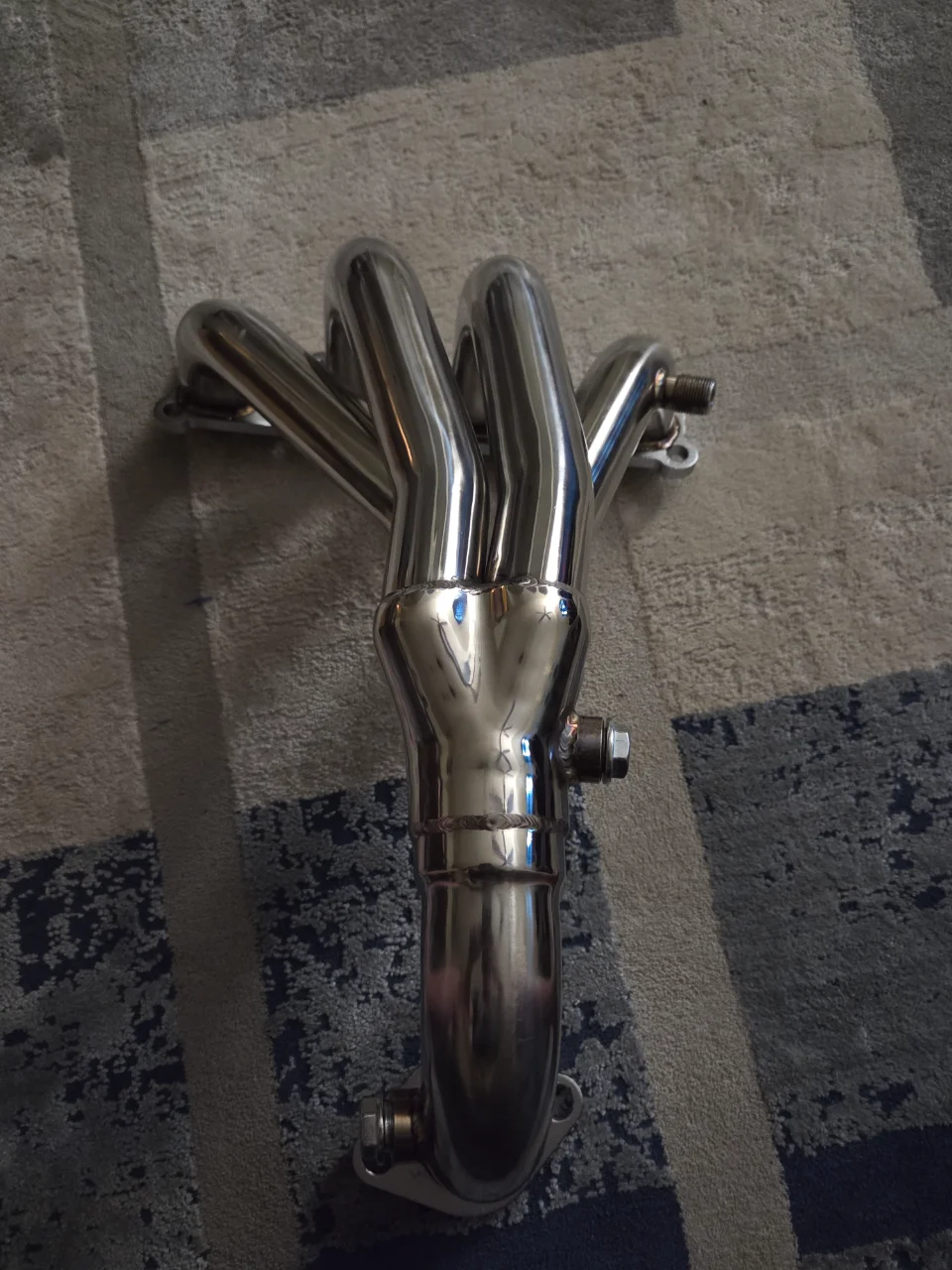

This is the headers before install.

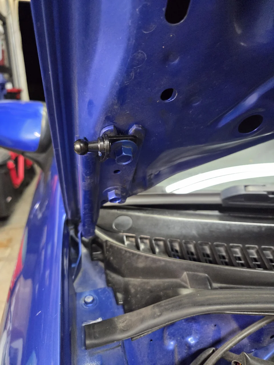

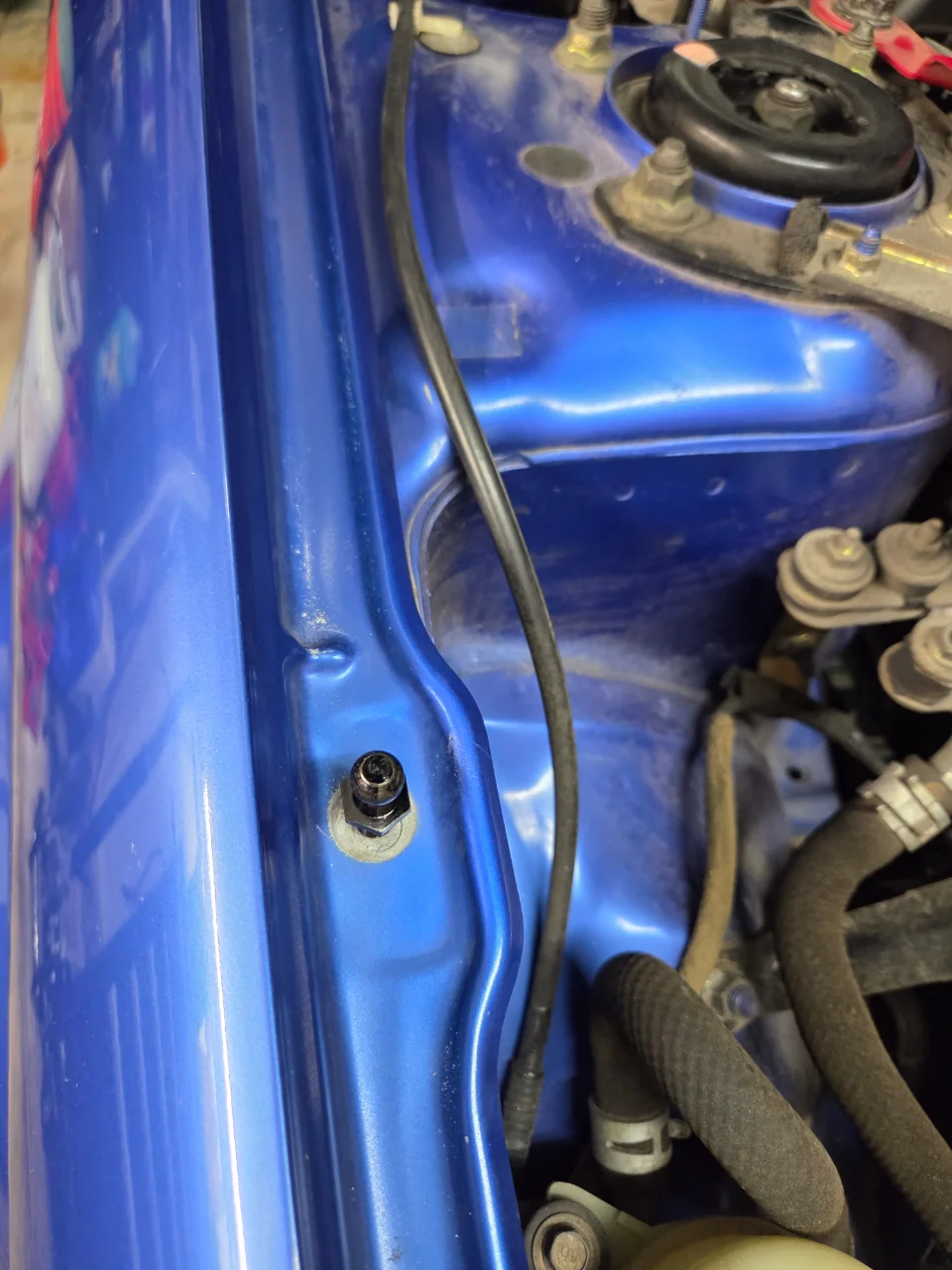

I'm fixin to do another thing. Found these on Amazon and I think they will work. The top one clears the inside of the fender with just a little light tapping on the metal and the bottom one will screw right in after I drill and tap the existing fender bolt hole. I will get gas struts extending out to 20" and retracting to about 14.5. I just have to figure out how strong they need to be then goodbye prop rod.
Links for the ball studs:

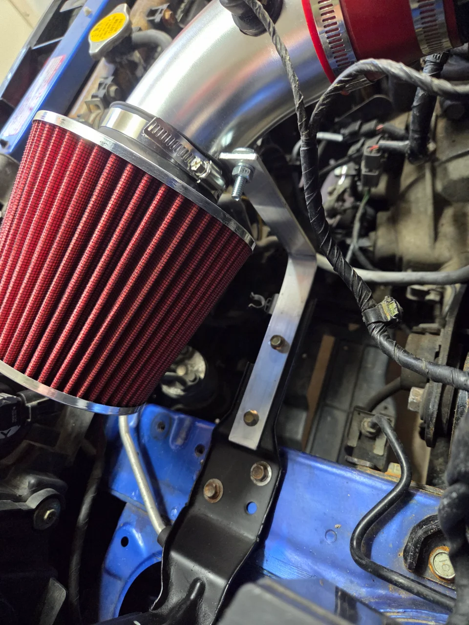

CAI was a little wobbly at the filter end so I fab'd up a little bracket. Cleaned and painted the overflow bottle bracket and used it to mount the support.

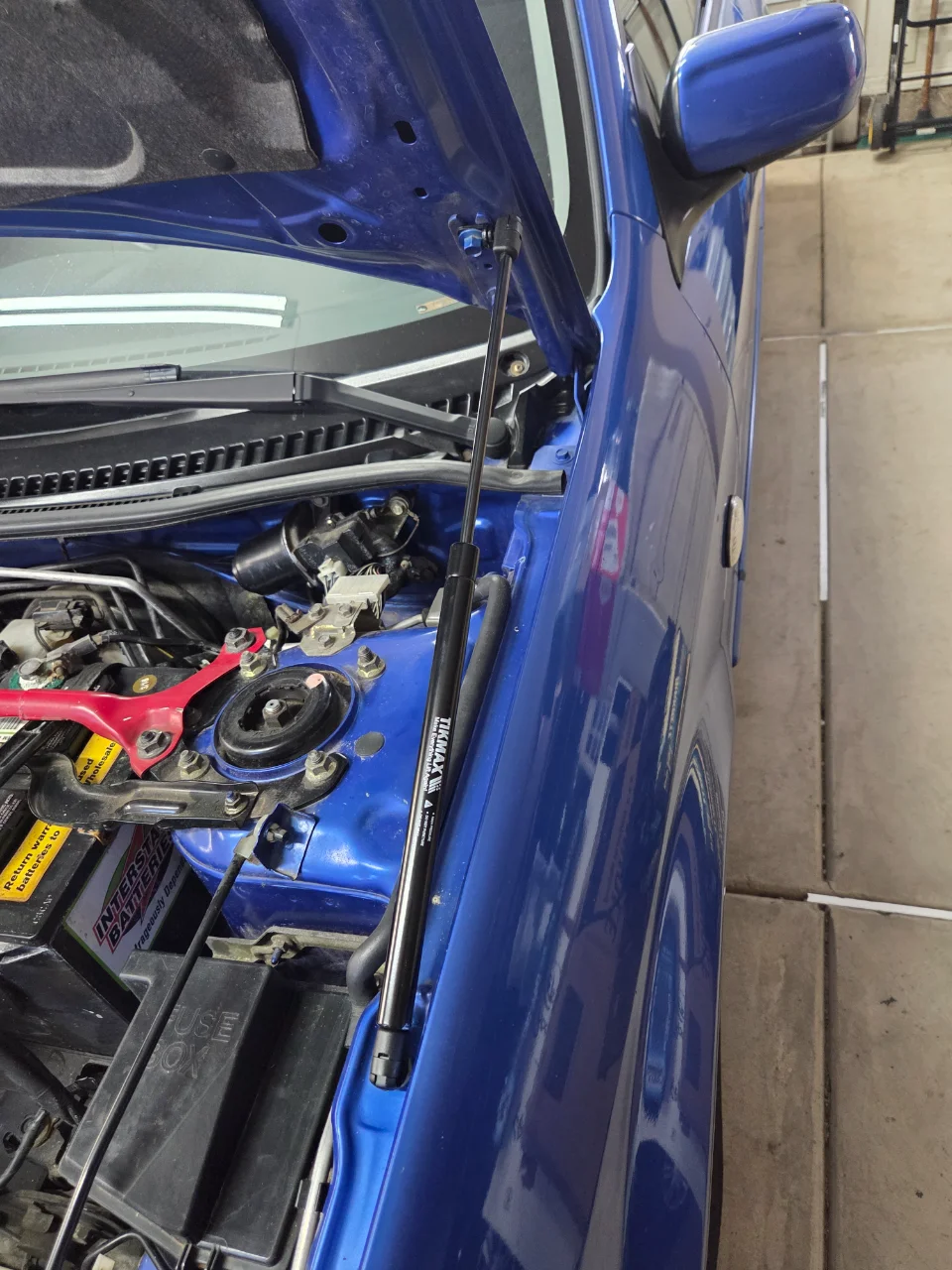

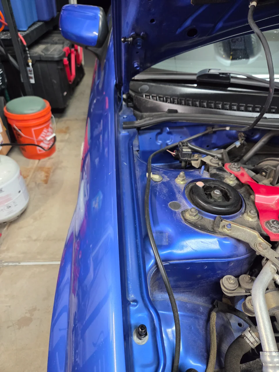

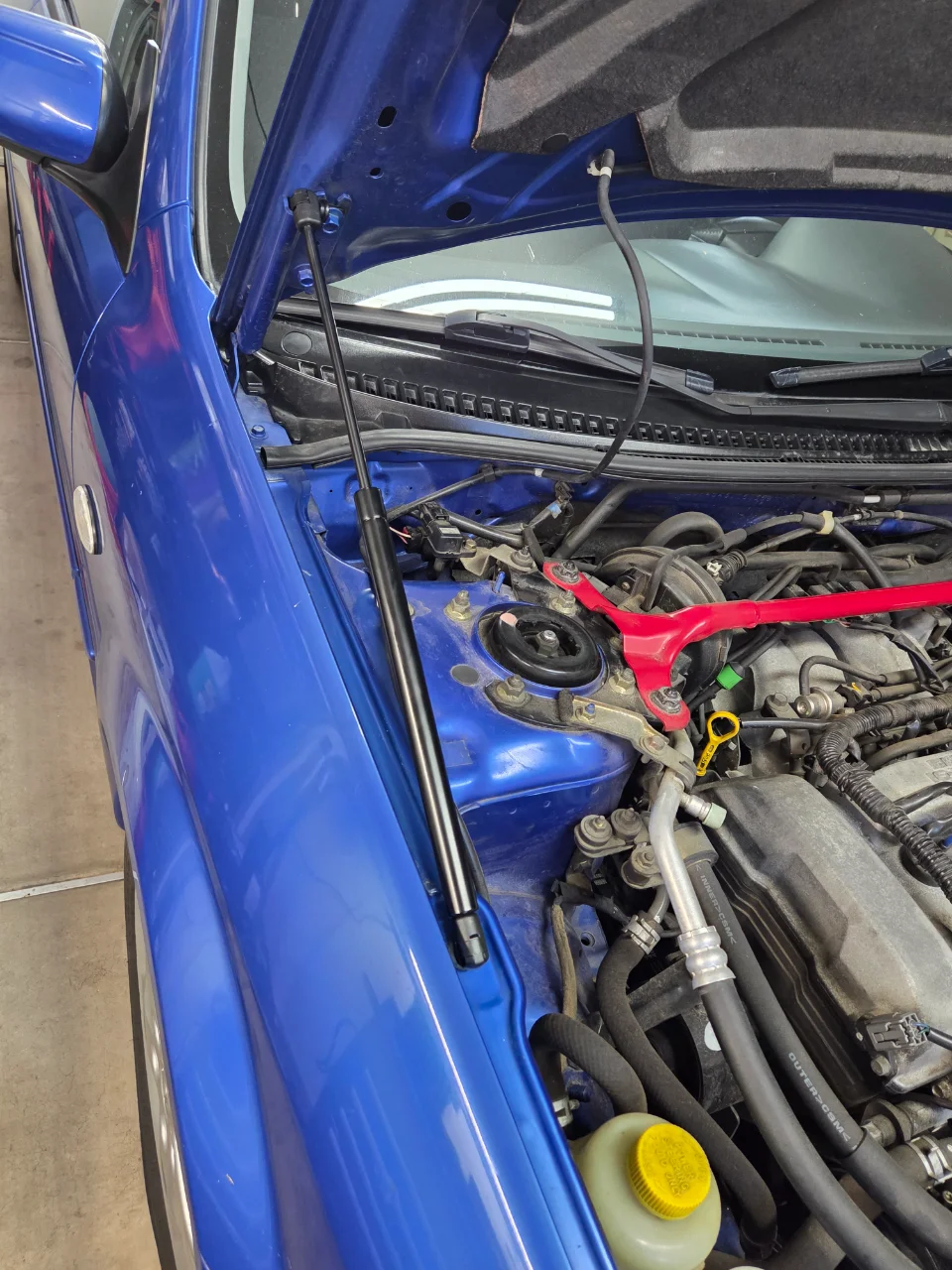

Got the struts in. They lift the hood easily and put it just before the hood stops it upward motion. Slight clearance issue when I close the hood, pushing the back edges up slightly. I will either live with it or clearance the fender metal below. Haven't decided yet.
These are the struts I got:
Nice work and looks great.
The only reason why I hate them is when needing to get to the engine compartment from the sides of the car.
Dang struts get in the way. 😂

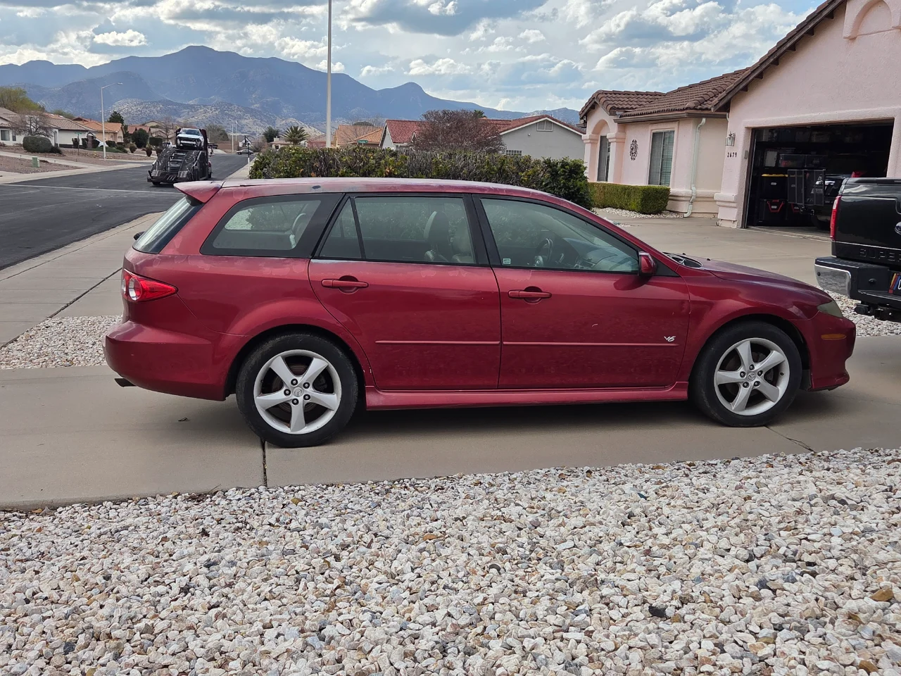

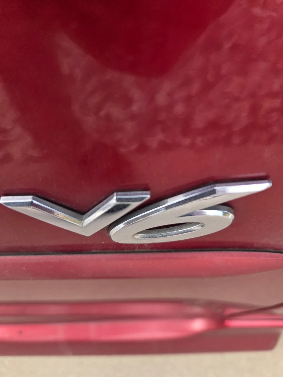

Not just any 2005 Mazda6 V6 5-speed though........
An S Wagon! Or would that be a Swagon?
Just rolled off the auto transport from Stockton, CA (can actually see him rolling away in the background).

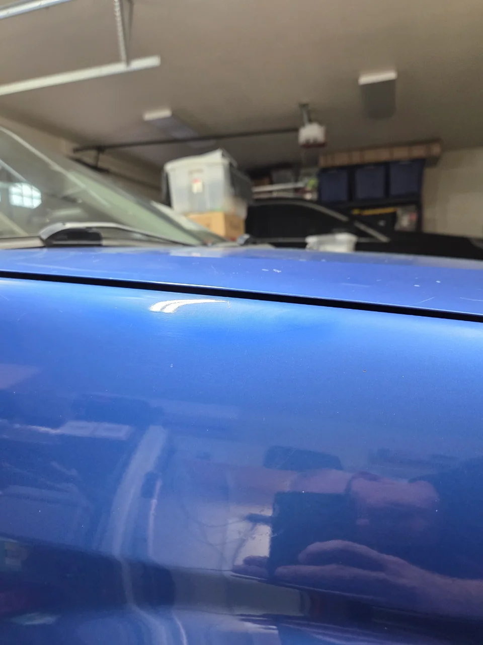

Paint is a bit rough on the horizontal surfaces, but there is a Plastidip sprayer on the way as well. Rest of car will take some work too, but it does run and nothing majorly bad sounding coming from the engine bay. Now I have 2 money pits to work on.

Nice! My favorite Mazda6 model (even more than the Mazdaspeed6)

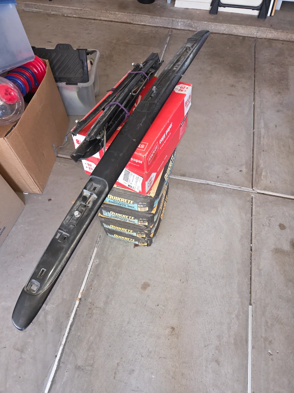

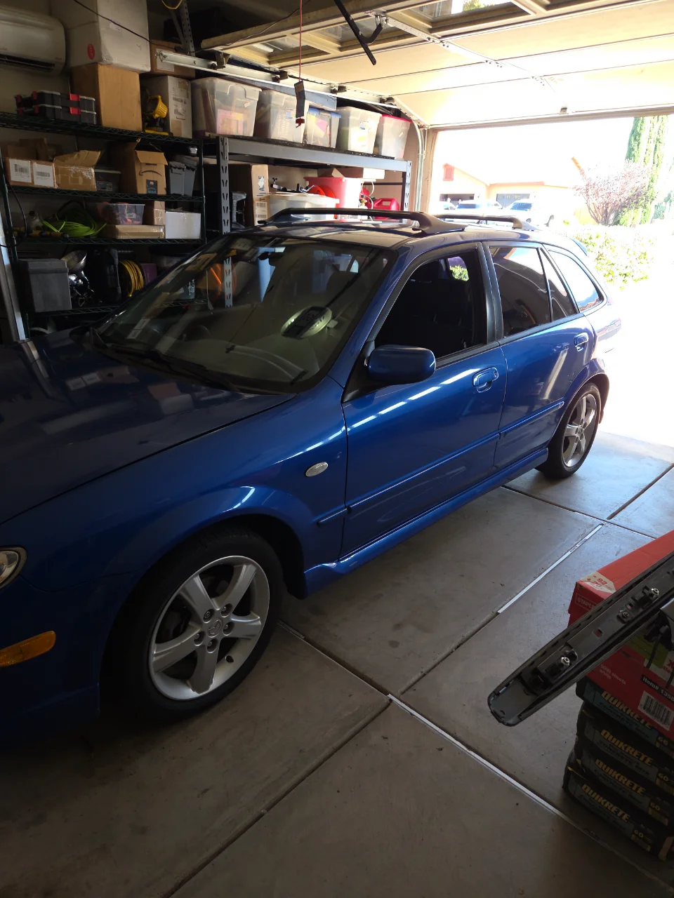

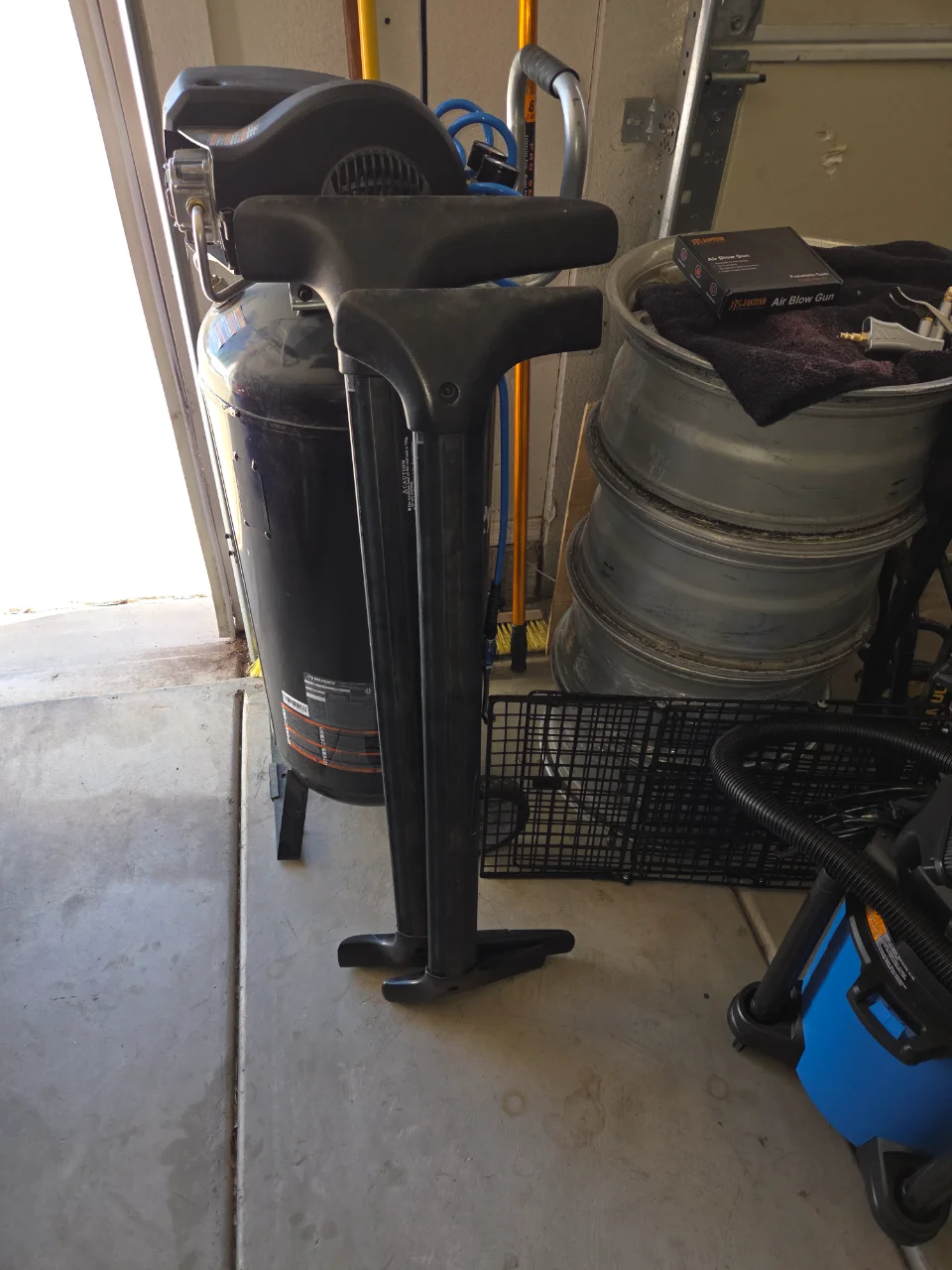

Got lucky that the Tucson Pull N Save got in a wrecked P5 about 2 weeks ago and it had the full roof rack on it. Just went this morning and got it. 50% off first Sat of the month and it got me the whole setup for $30. Quite a good day if I say so. The driver side plastic is all in one piece, but the plastic on the passenger side was sun weakened and came apart a bit. I will see if I can salvage, but I at least have the metal bits to bolt the cross beams on. I may be willing to part with the roof rack delete strips I currently have. Not sure yet, have to get the rack installed to make sure I like it.

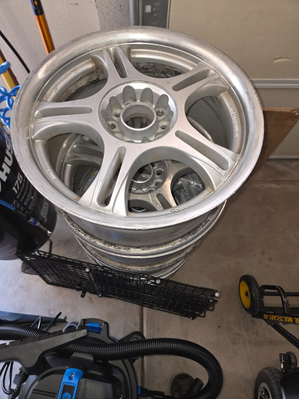

The stack of wheels next to the air compressor is a set of 17" ARE AR95 Estrellas that I picked up for $50 last year. They are destined to make it on the P5 eventually.

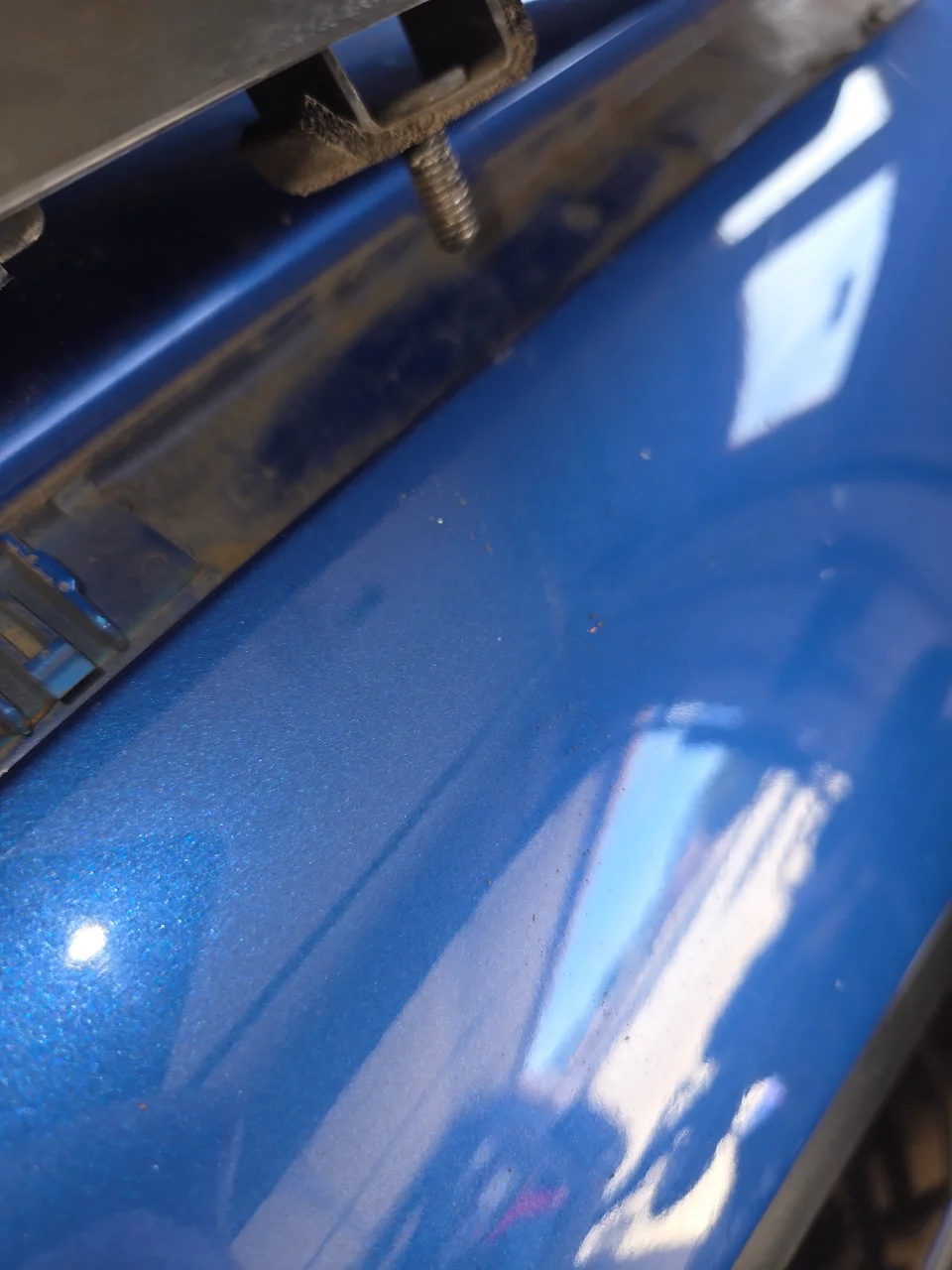

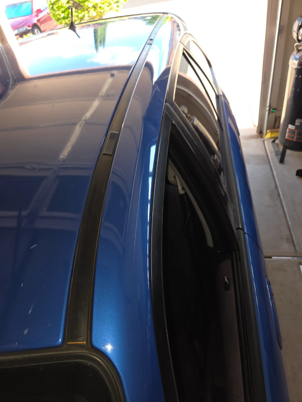

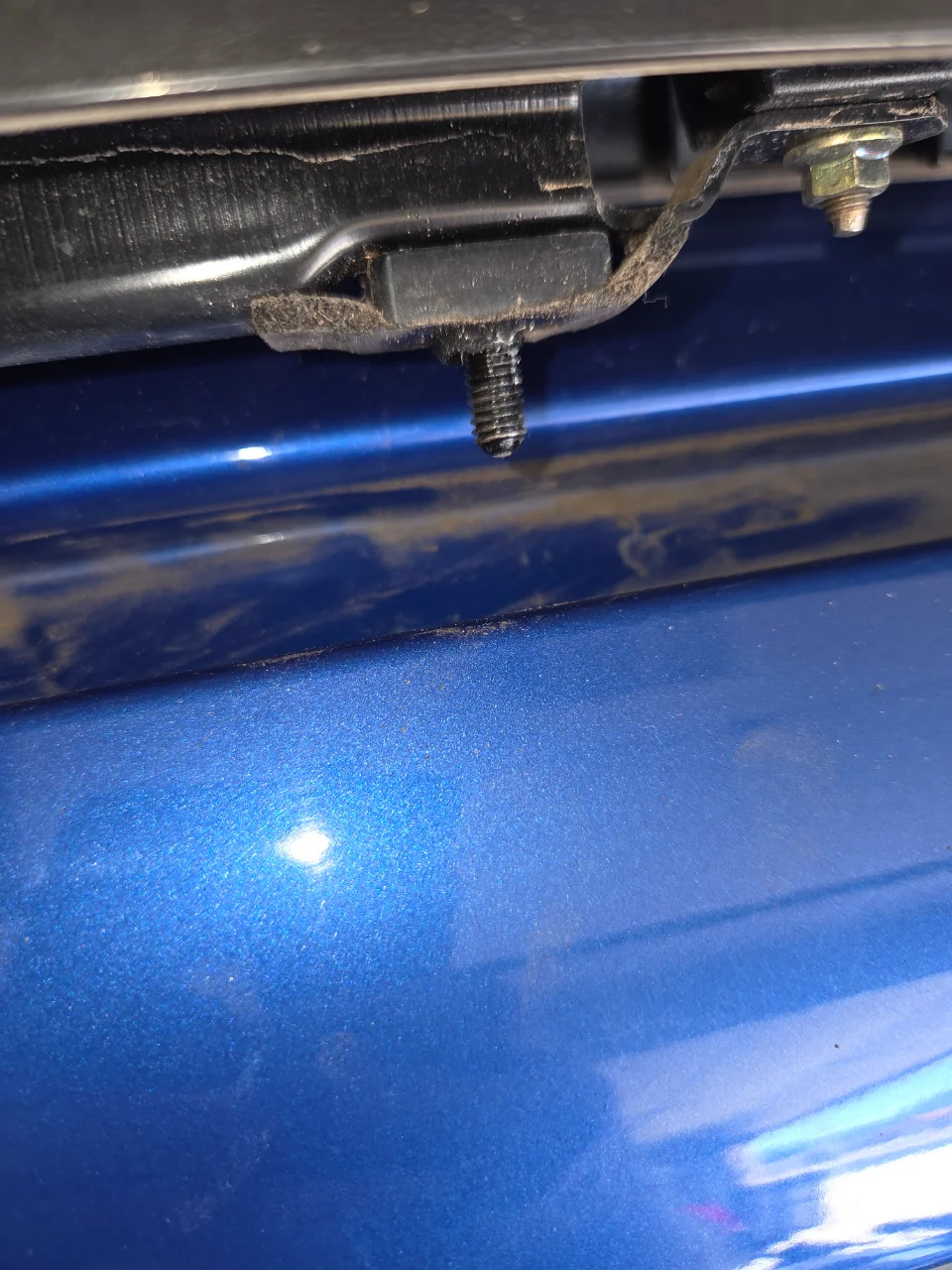

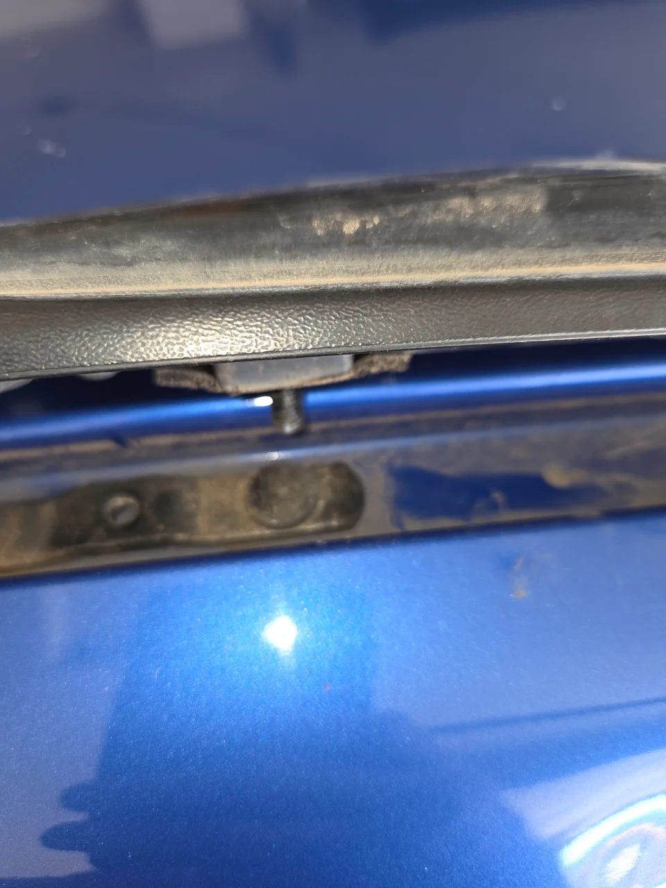

Ok, we'll i guess I made a big assumption. I thought there would be mounting holes for the roof rack runners. It seems that roof rack optioned P5s have the holes drilled and mine does not. I suppose I could drill them but I need to be exact. Damn, there's always something.
