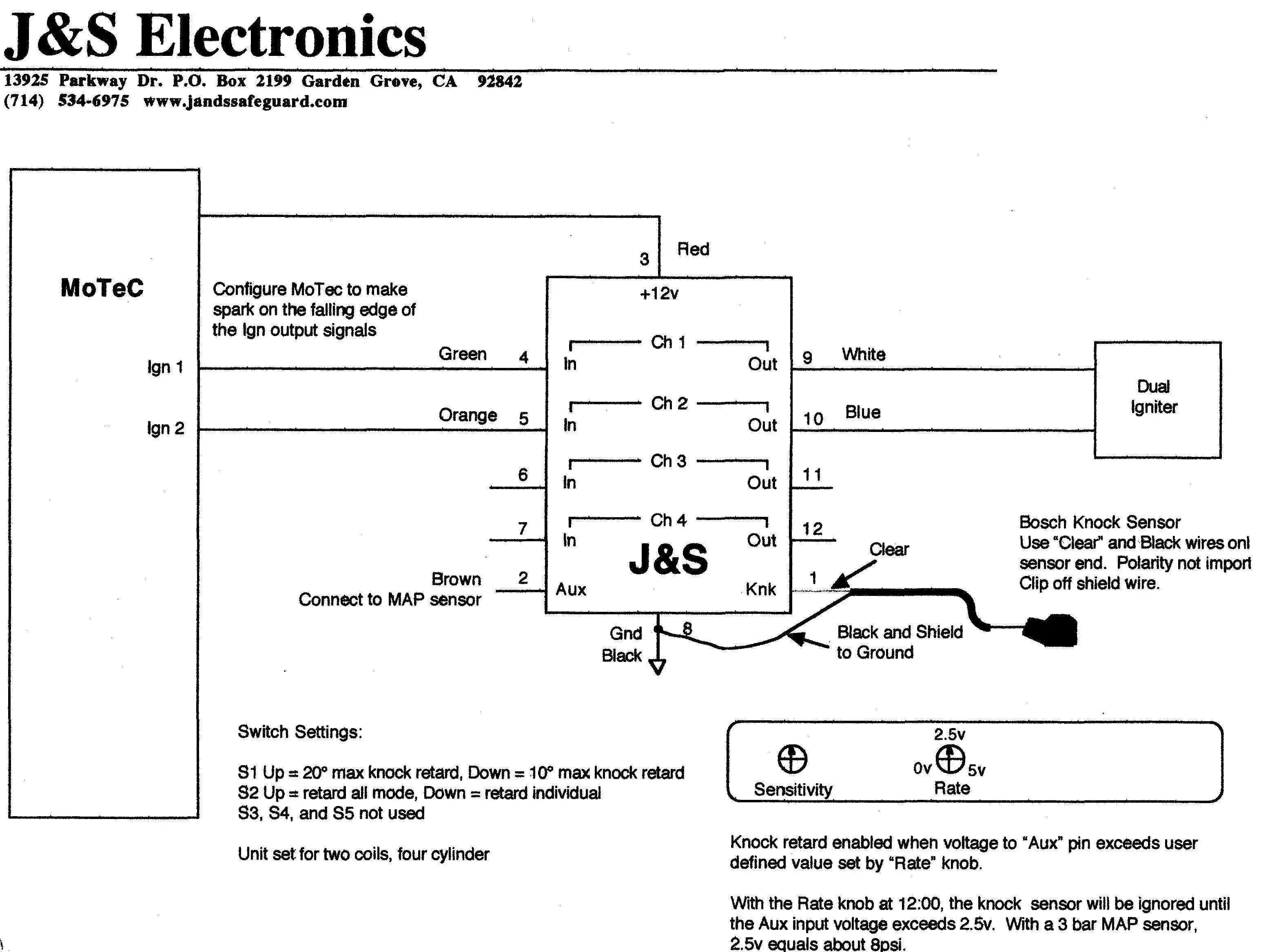

This is just a quick writeup of the install. The unit comes with instructions which i will scan in if you really want me to.
1) I tied into the fuel pump power feed (only supplies 12v when engine is cranked.)
2) Wire to ground.
3) Vacuum input from manifold.
4) Spliced j and s timing control wires between my MPI SMT6 and coil packs.
5) mounted sensor to block
6)ran the sensor wires from the unit to the sensor (it has harnesses so its pnp)
As for tuning, the directions give you steps to make sure it is working, like you tap on the sensor with a screw driver and the car should stumble pretty badly while sitting there and revving to 2000 rpm.

here are the instructions:
