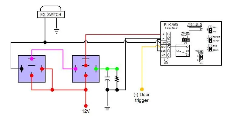

Yeah, there are plenty of dummy switch locations to put a light switch. Does anyone know of a switch from Mazda that would fit in there that can be used? Where the four slots are to the left of the wheel?
I've been trying to work with the guys over at the12volt.com at a solution, but think I've confused them.
I've determined that I want to quickly turn the driver's map light on/off to activate a delay-off timer which would turn on the dome light. Then turn on the map light for 1-2 seconds to turn it back off. If the map light switch is held ON for more than that same 1-2 seconds (like when you want to use it), the timer relay (and therefore dome light) won't be initiated at all. What you think? This method wouldn't require running any additional wires or finding some stock switches for the blanks in the dash.
There are lots of 555 timer kits that will work well for this.
Here's a diagram to show you a possible solution I came up with using an ELK-960 timer for a home security system...

For what it's worth, I can reach back and turn it on/off while driving, but I do agree that it is too far back and there should be a switch near the driver.
