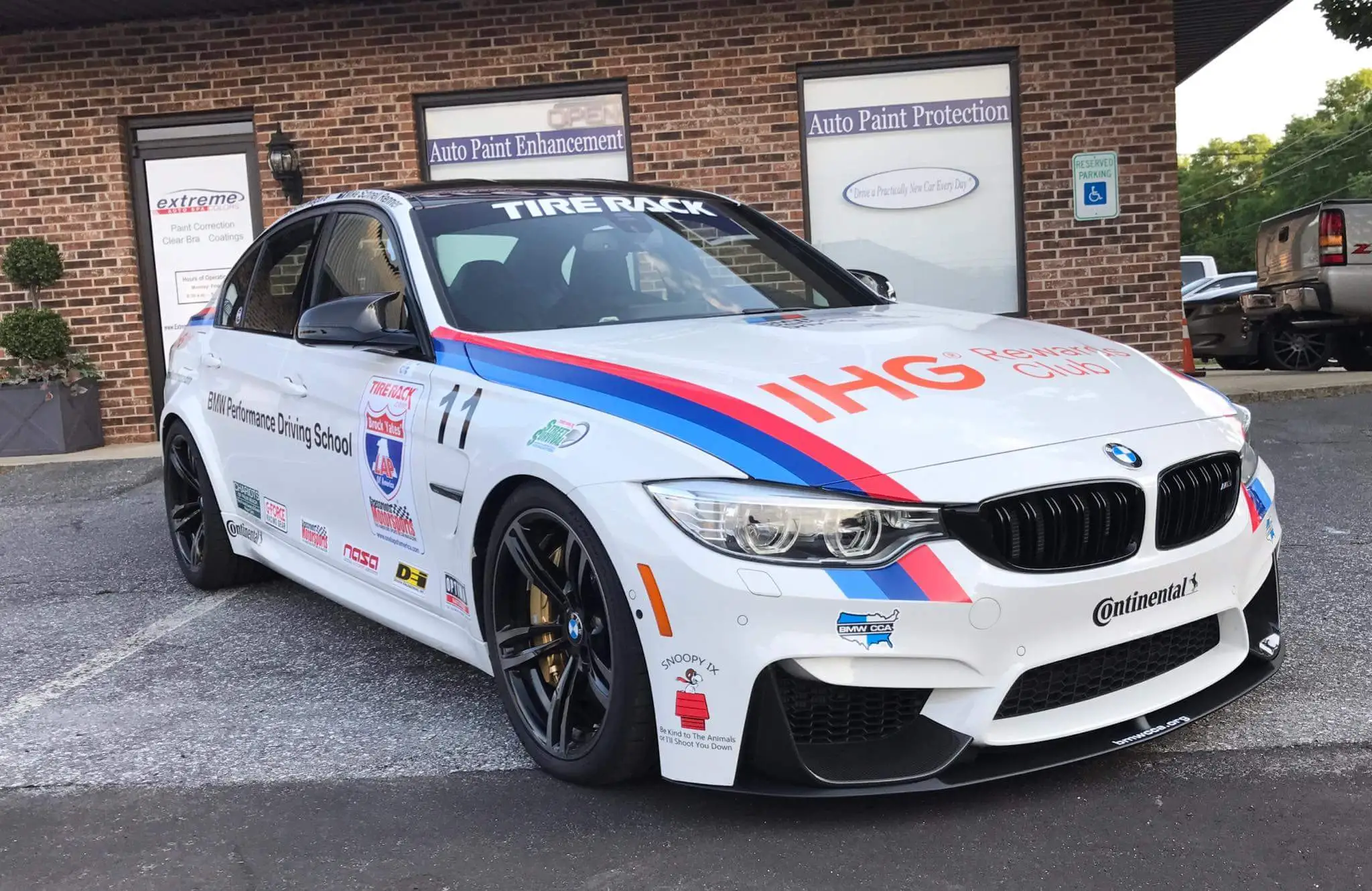

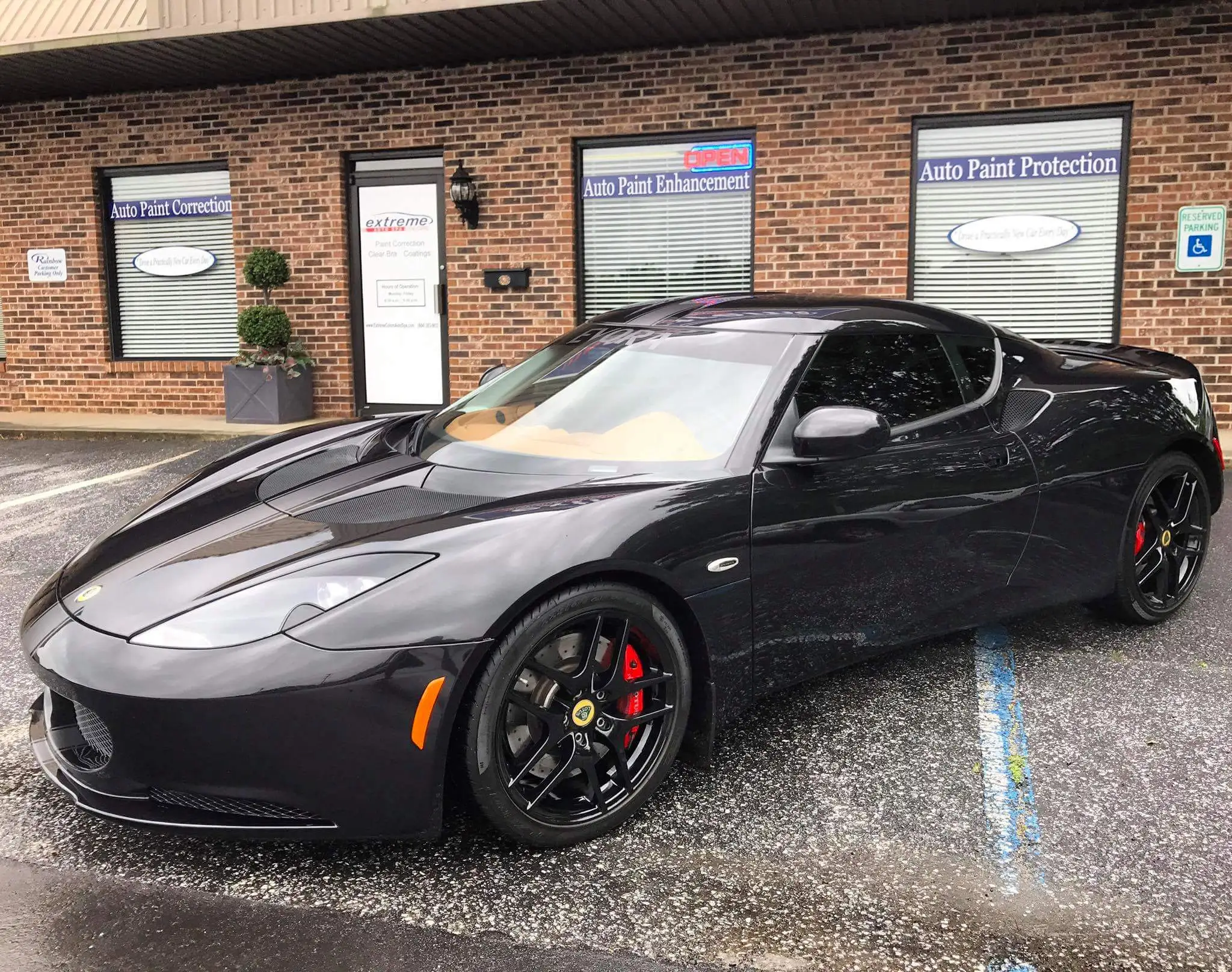

Think all these places cater to high end clients, and it's no surprise with a full job costing several thousand...These guys use XPEL products and it's the official one of BMW Performance Driving School as well.
