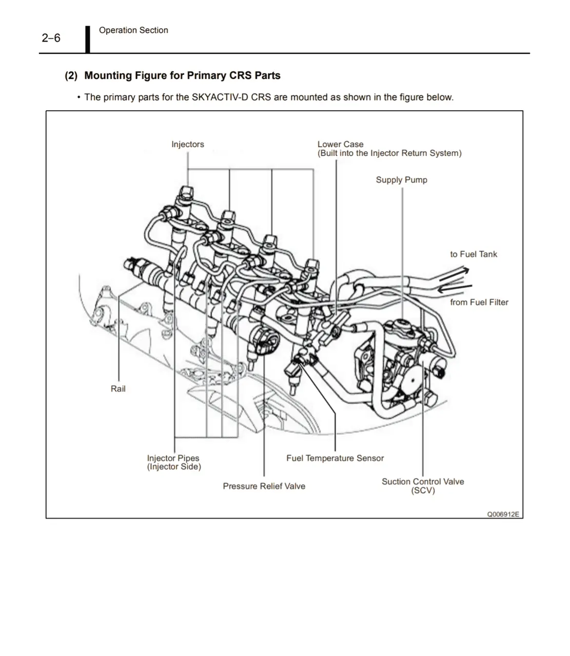

Sorry to hear of your trouble with the car. I see you indicate that you changed your "sensor". Perhaps it's the fuel pressure control valve that has failed rather than the sensor?
I've attached a PDF manual of the fuel system for your reference.
  • MAZDA SKYACTIV-D Engine (EURO 6).pdf

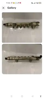

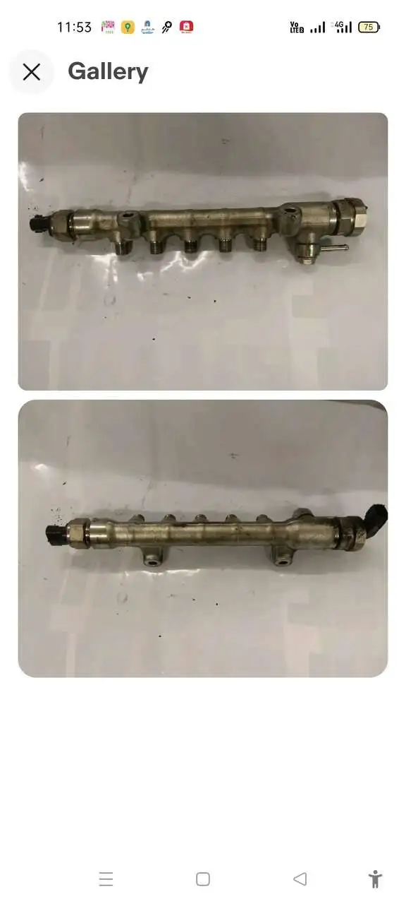

Hello sir. I just wanted to confirm. A fuel pressure relief valve and a pressure regulator are 2 different things correct or are they the same. And confirm it is the one which sit on one of the side of the fuel rail/common rail while the other one is a sensor.
I have attached a pic
Thanx for the help

Hello @Mohamed, I would think pressure regulator and Pressure Relief Valve are the same thing. I only see one of those parts on the common rail diagram from the manual.
In your photo, it looks like the pressure sensor is on the left and the Pressure Relief Valve is on the right.
If you are having trouble sourcing a part, you could try taking it out and cleaning it. With your problem being intermittent, it may just be contaminated or dirty/gummed up.
I'm not a professional mechanic, just a thinking man :) . I'd try cleaning/soaking it.
