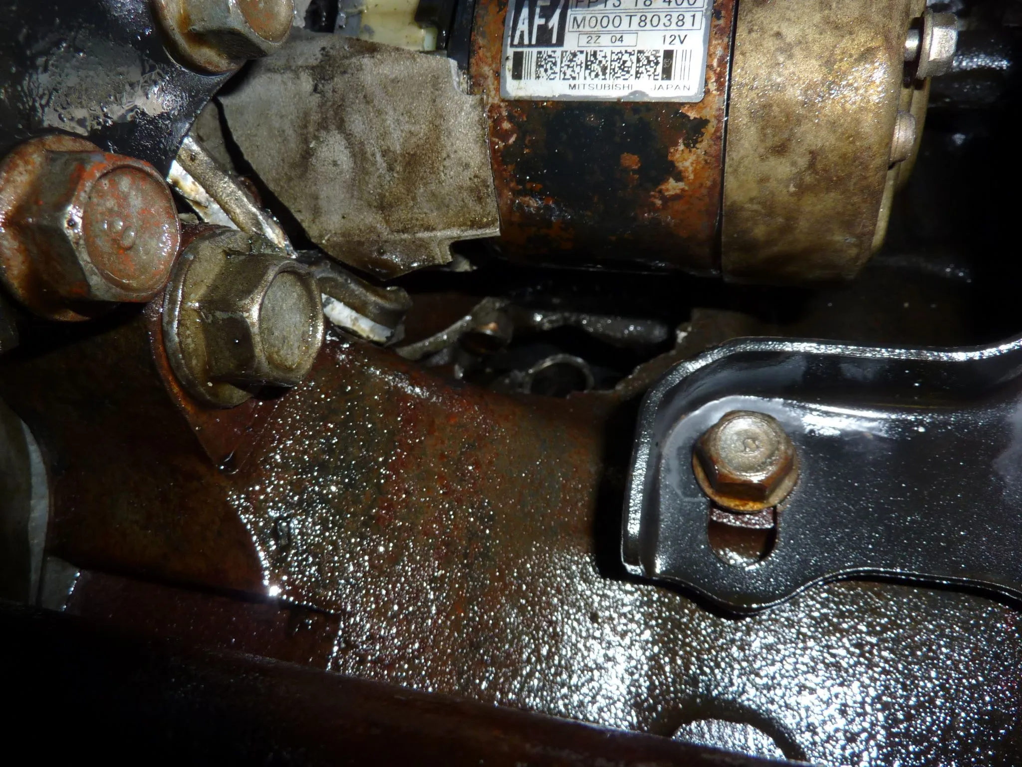

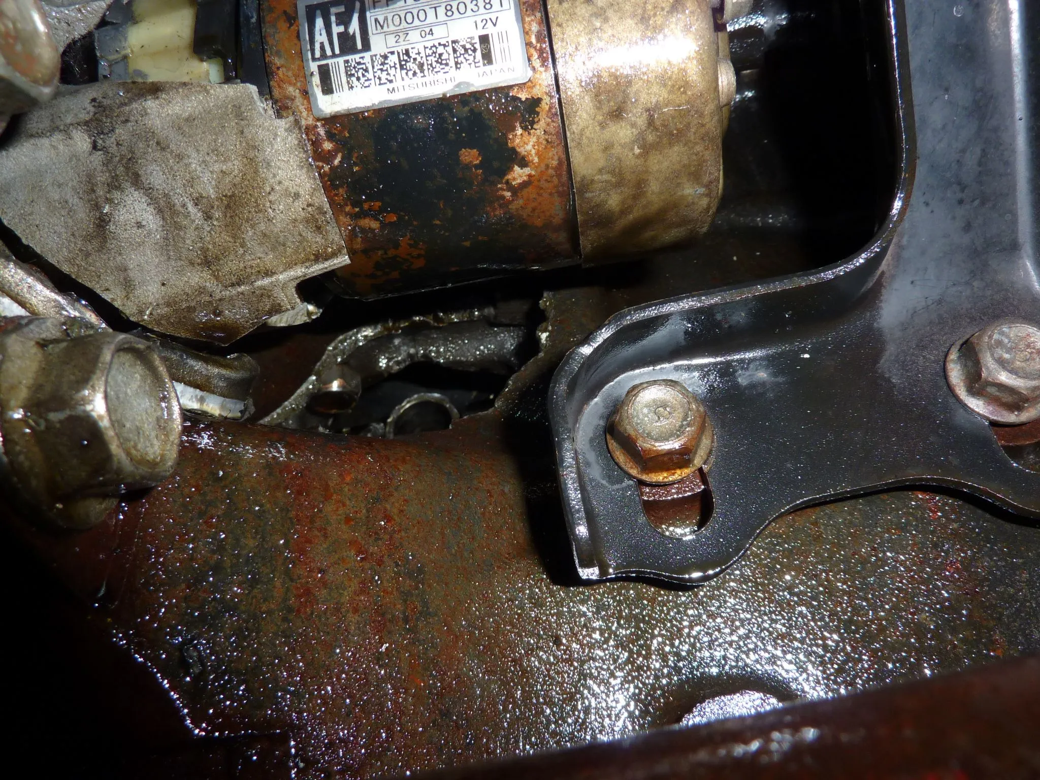

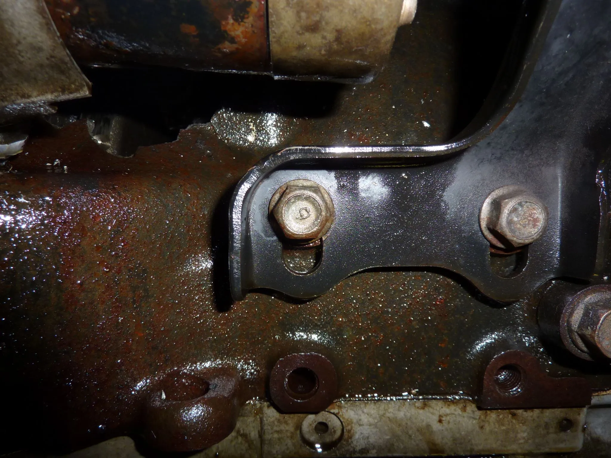

You might be able to get that welded back on. If it took part of the tranny right next to the bell housing.
What grade oil were you running and last change?
What spark plugs and about how many miles on them?
How much boost are you running?
How much boost at time of Failure?
What gear? this was answered 3rd
what RPM?

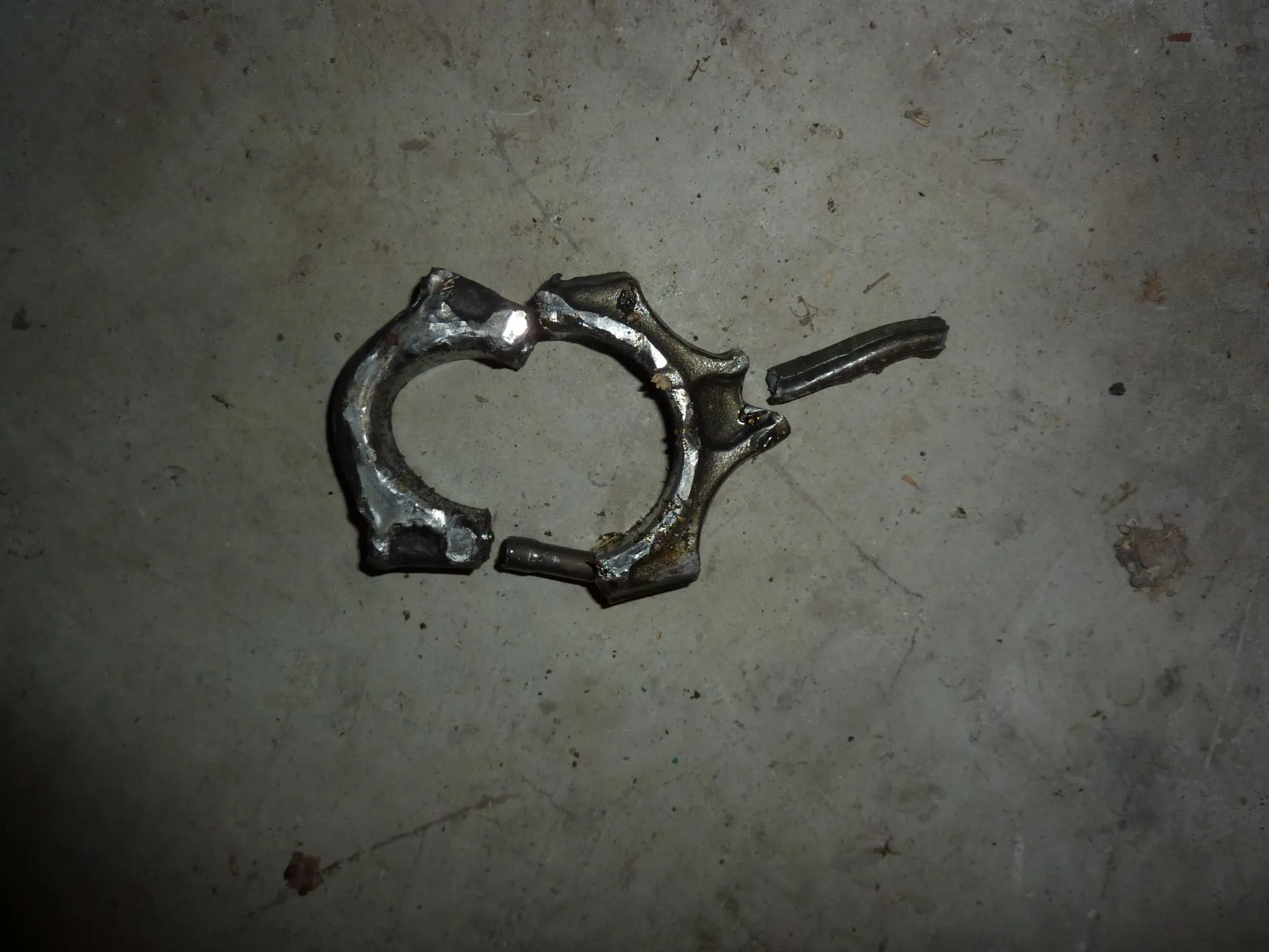

I'm wondering if you just happen to detonate due to hitting boost in 3rd at a lower RPM? If your running regular plugs maybe one took a s*** at the wrong moment?
i thought boosting at low RPM killed transmissions, not engines...
Doubtful that the normal heat range plugs caused this damage. I want to know if the rod bolts let go or the rod snapped.
