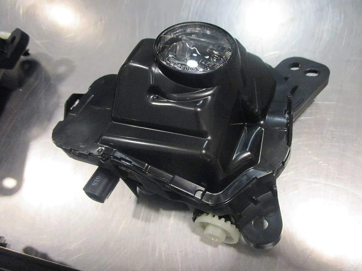

With regard to the foglights, it looks like they are adjustable as well. I don't know for sure, but the adjustment knob appears to be the white plastic one at the bottom of the assembly in this picture.
