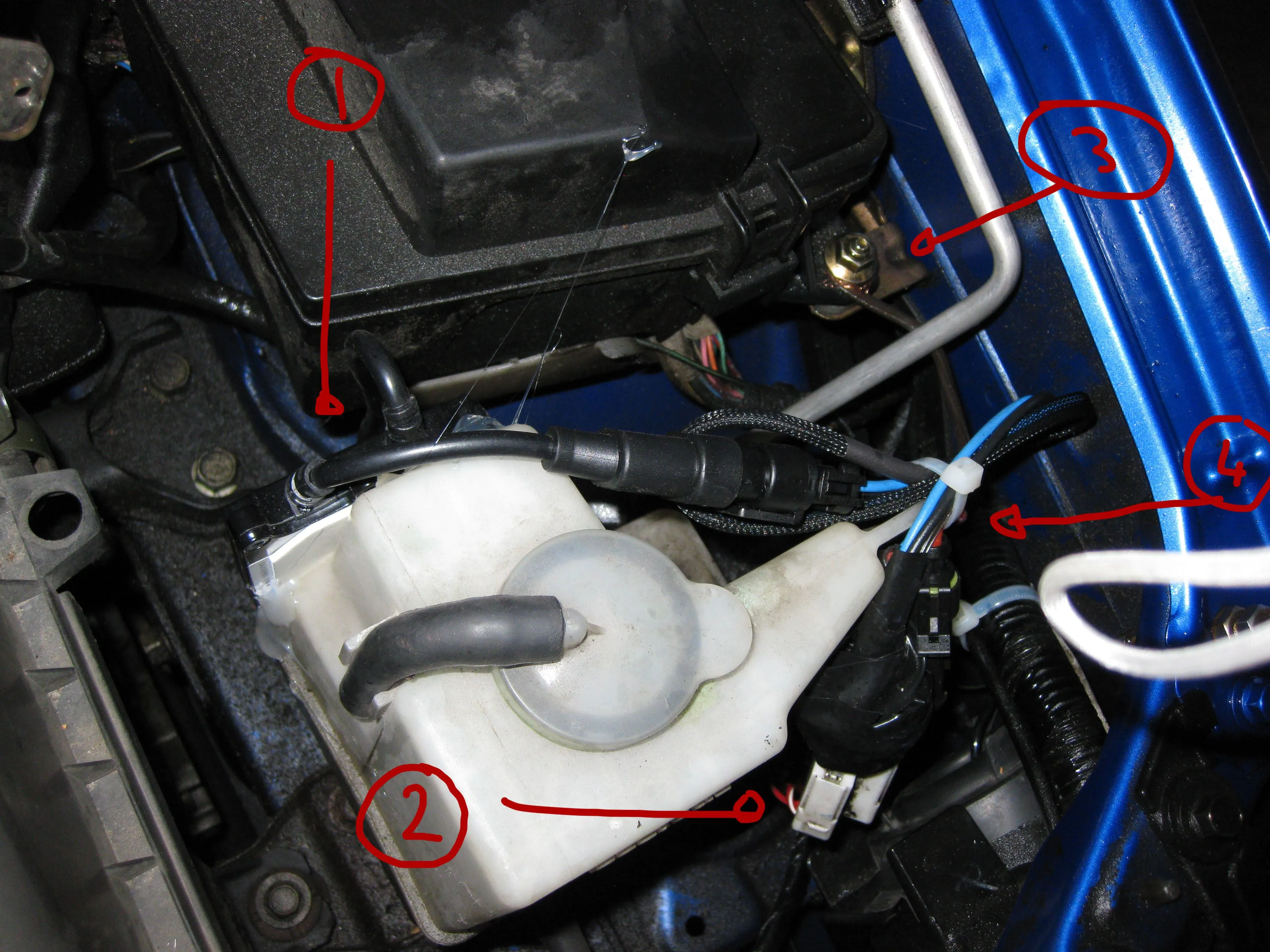

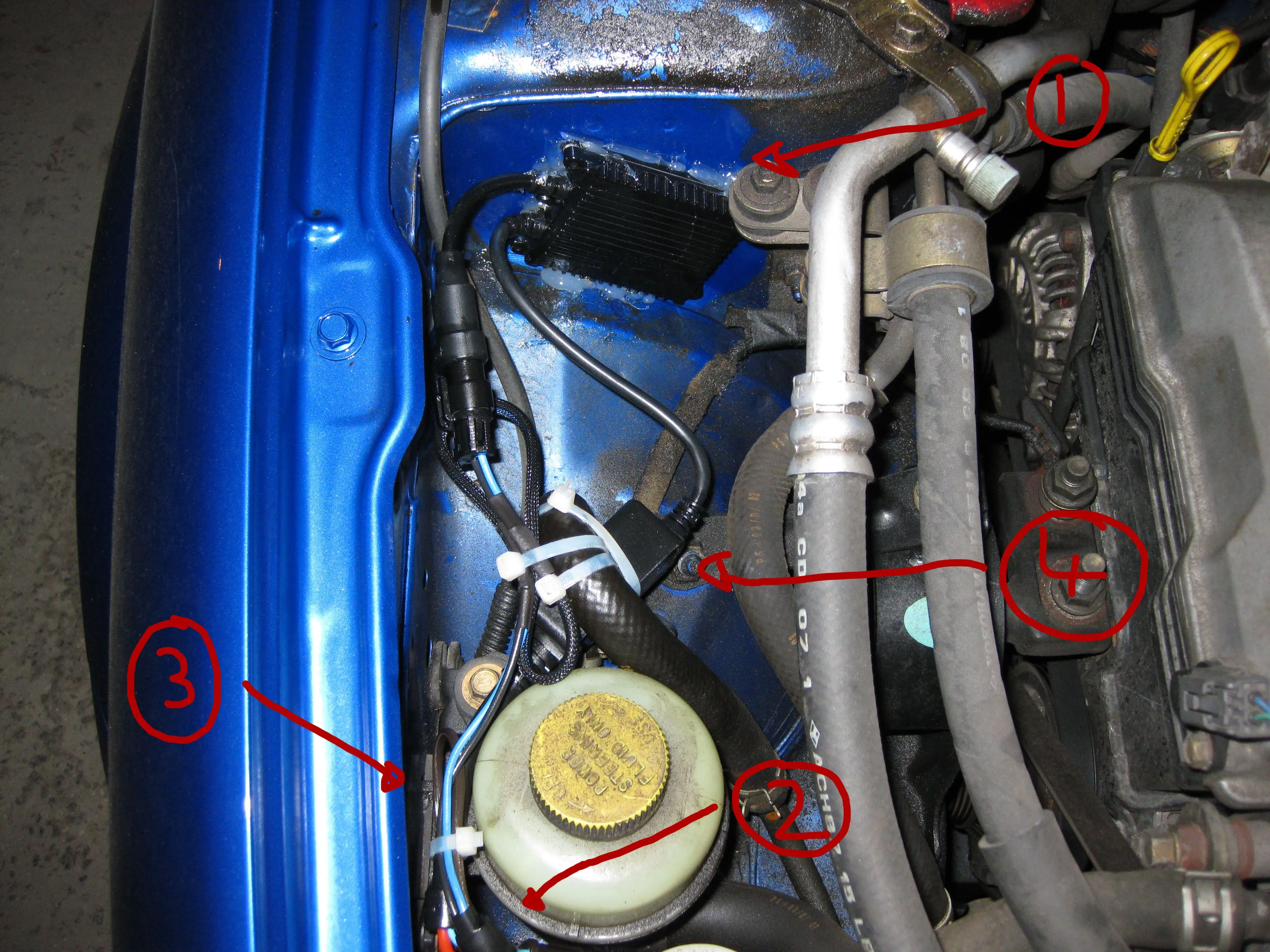

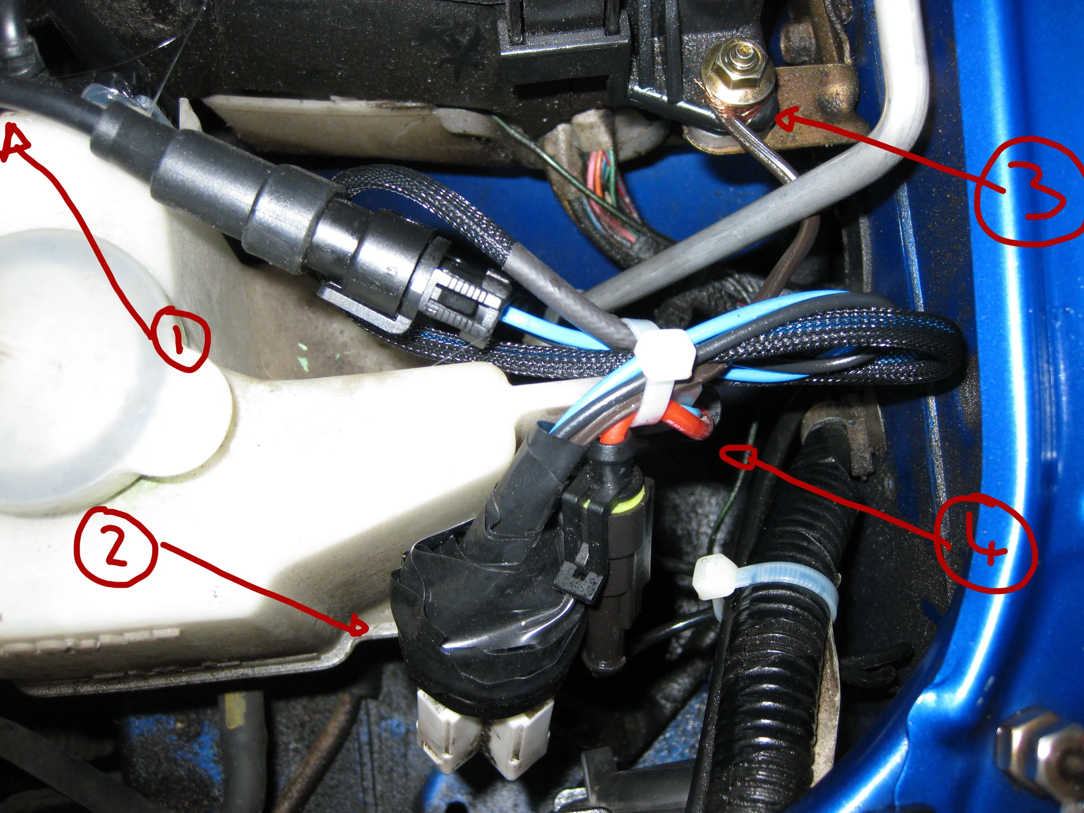

Alright, so i got some pictures, but they're not that easy to understand.
I would've liked to take clearer shots but I wasn't readyto unwire and we-wire the whole thing for the pics.
First pic is passenger side,
second and third is driver side.
In all pictures,
1. Is where I decided to mount the ballast (it came with double-sided stickytape but I decided to add some hot glue for good measure)
2. is where you connect the HID kit to the original connector. (I haven't figured out a way to isolate it better than dozens of turns of black tape.. any suggestions?)
3. Is where I decided to ground it to the chassis get 12V (NO FLICKER!) You can choose any place, test it with a multimeter to make sure it's chassis. I chose screws cause you can just roll the wire around and screw it back tight so it's pretty easy to do.
4.Is where I tied everything up to keep it tidy and in one place.
Hope it helps, let me know what you think.
PS. Yeah it's pretty nasty in there, I just had my rustproofing done so there's oil everywhere and on everything.

Thankyou, new little weekend project hehe. Yeah, I just had mine oil treated aswell and it's messy in the engine bay :(
