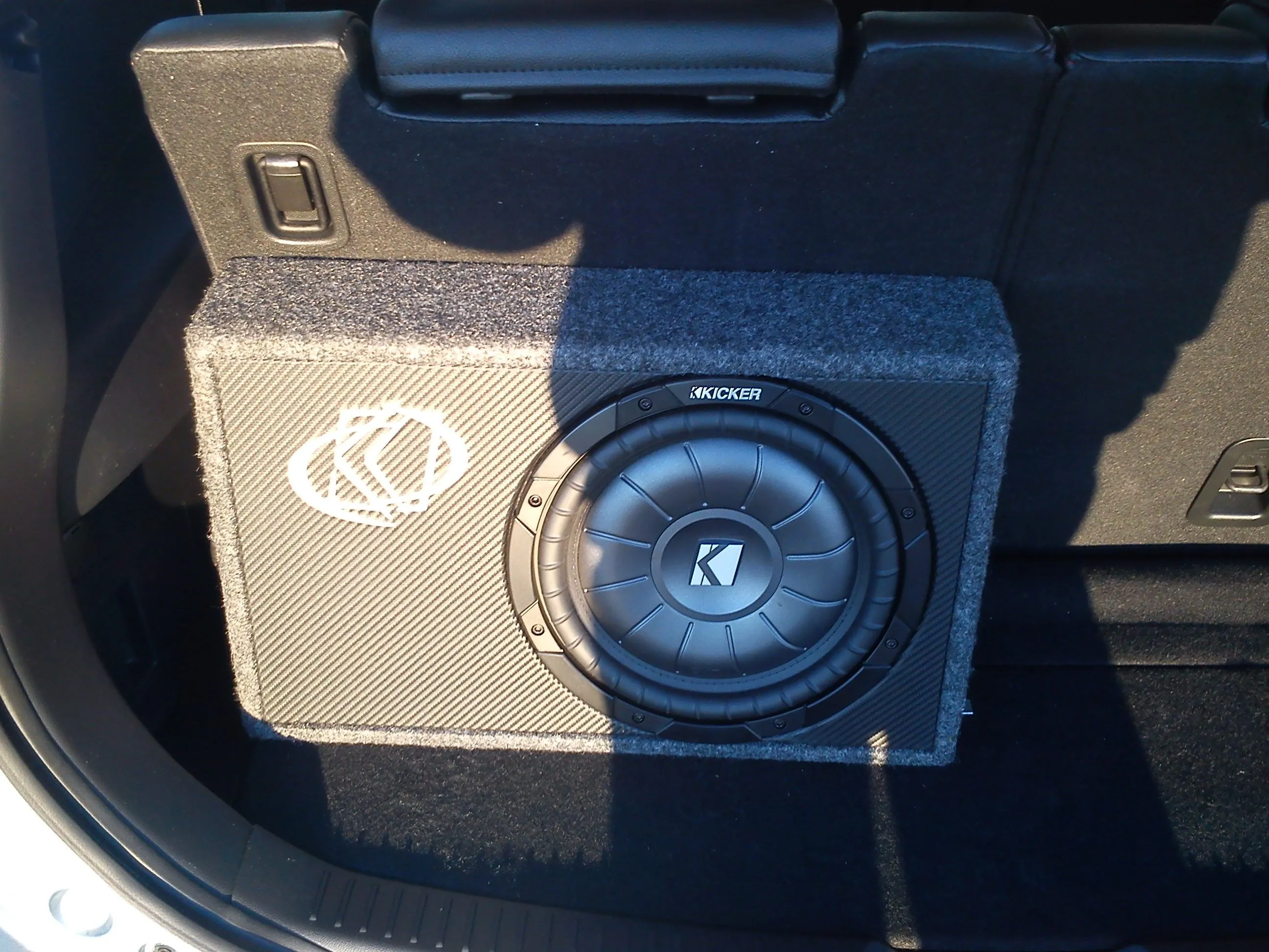

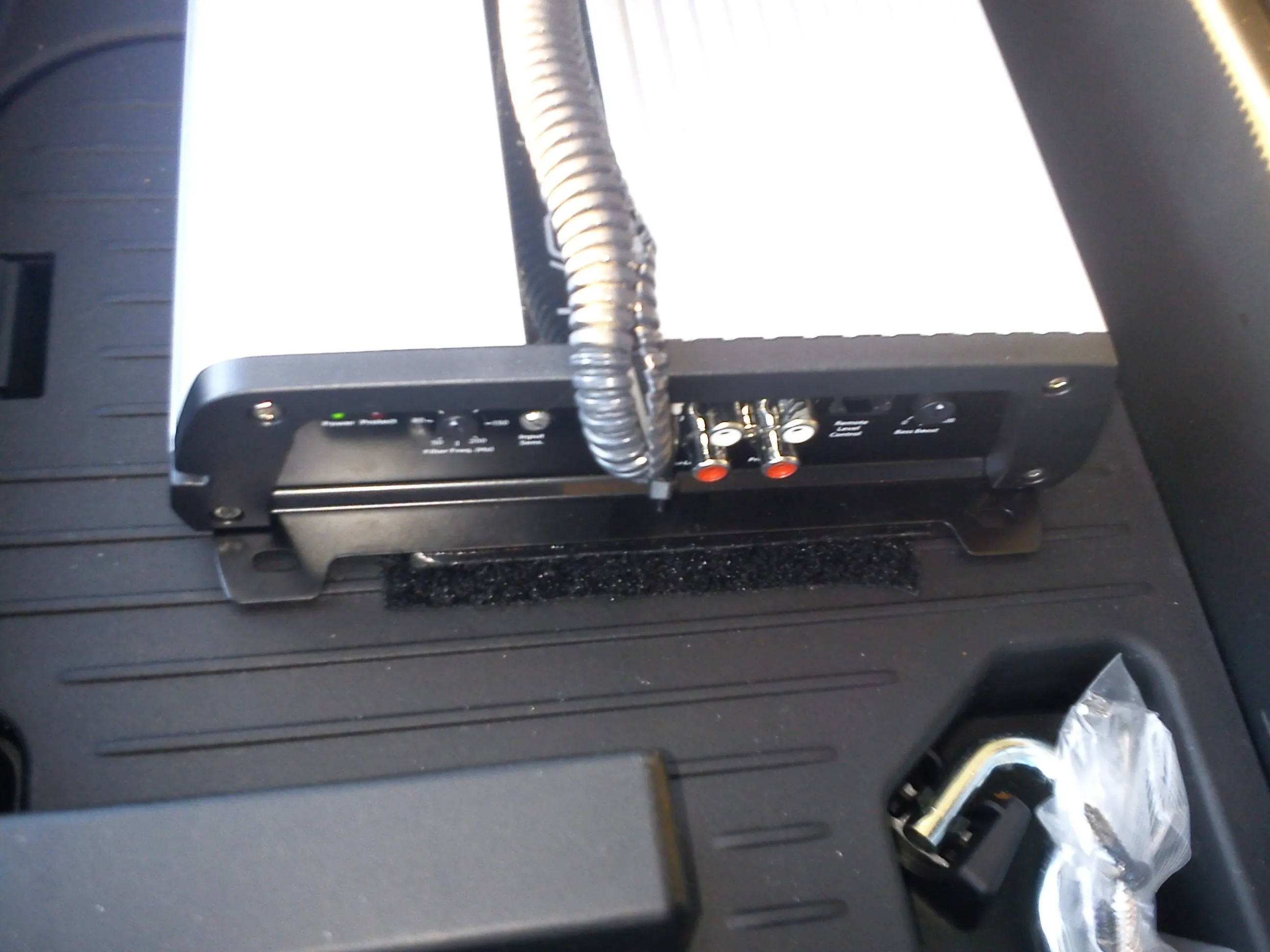

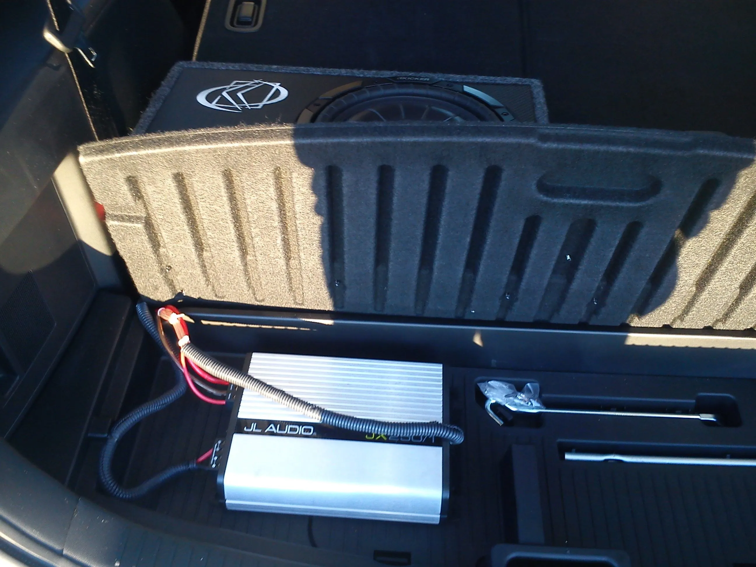

Here are some photos, by no means complete, that I have taken this morning. It gives you an idea as to how the amp and the subwoofer unit was mounted. Power comes from the battery using 8 gauge Scosche amp wiring wire bought from Walmart, and ground is tapped into the existing grounding position behind the rear panel. Speaker wires are high quality ham radio rated zip cord 10 AWG. Currently fine tuning the crossover and boost level but I think I am happy with the setting now (see picture). Subwoofer is holding onto the carpet via Industrial Strength Velcro -- the rough side only as it sticks to the carpet. Sticky/adhesive side is facing the subwoofer. Three silver brackets are from Lowe's -- about $4 for the set of 4 with self tapping screws. All wires are hidden, and the speaker wires are soldered onto the posts of each speaker. Marine grade heat shrinks on connectors just about every connection joints. As per the subwoofer unit, when you flip over the cover, the sub just lays flat on the rearmost seats. Kind of neat how it does this. Once flipped, you can access the emergency jack.
