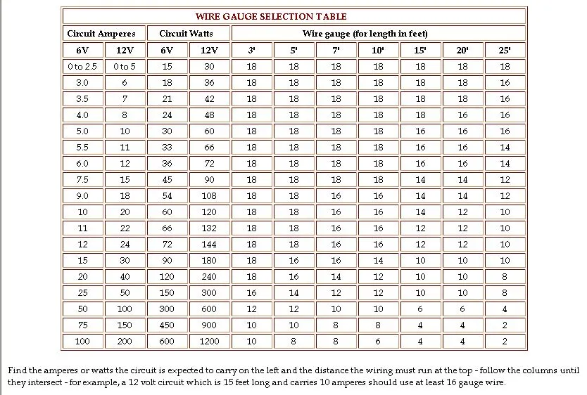

I found this chart on the internet - not to say it is written in stone but the values look good. If you are worried about it bump it down to the next guage to be safe.
It really depends on what you plan to use the outlet for? 12 volts at 15 amps and 20 feet long - 14 guage which is pretty thick - I don't think you'll find another 14 guage wire on your car except for an alternator cable.
