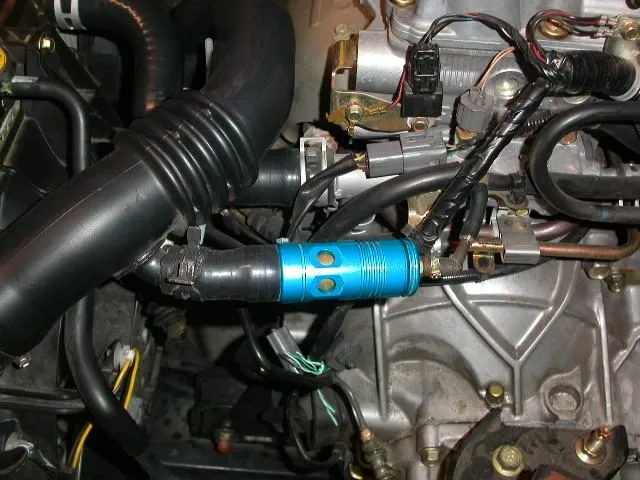

Wait, you have the TXS-S on there? So, you have hardpipes but stock intake? If that's the case, just cap off the Injen's recirc tube.
Here's what I've got, it was on the car when I bought it...
