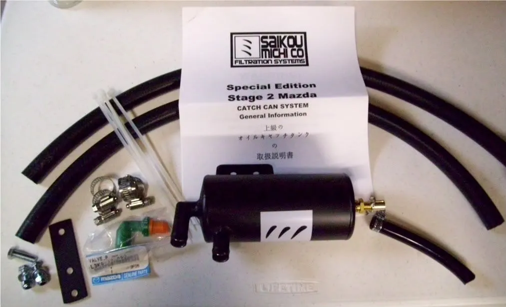

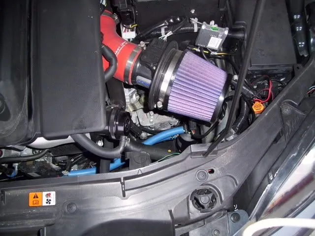

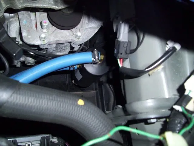

I just got a Saikou Michi OCC from a GB. Looking forward to installing it in a couple weeks. The kit that's installed in the pics is from the person who organized the GB and did all of the legwork on the mounting options and getting all of the hardware/parts together. I went with the one located below the SRI since I'm running the CP-e nano.
It was pricey - $130. For me it was worth the money since I'm lazy and didn't want the hassle of getting all of the parts together and testing/routing everything before is could be mounted. And I like that it has a drain fitting. It's optional to drill a hole in the undershield to where you can drain it at any time. Almost like a Fumoto valve :)
