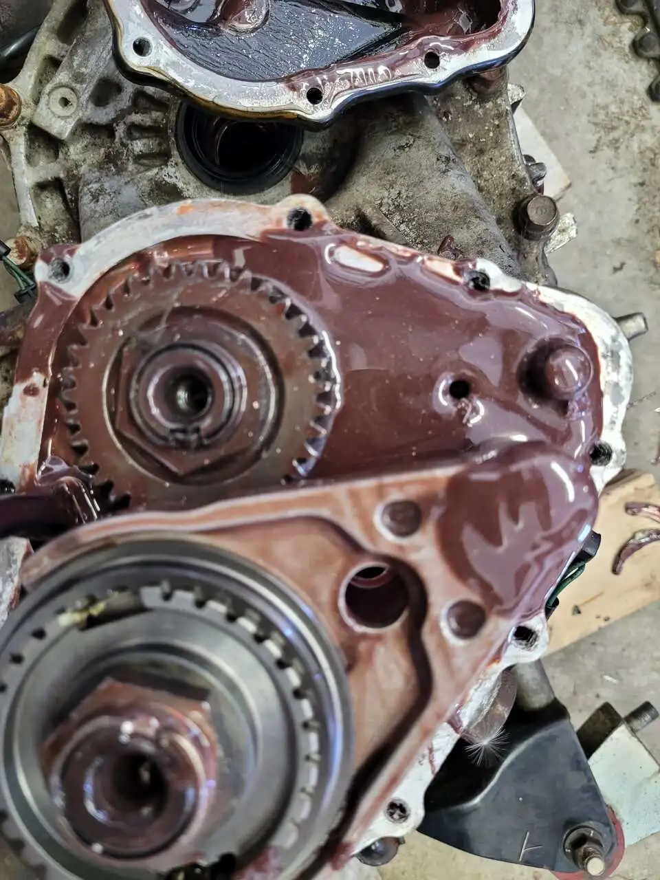

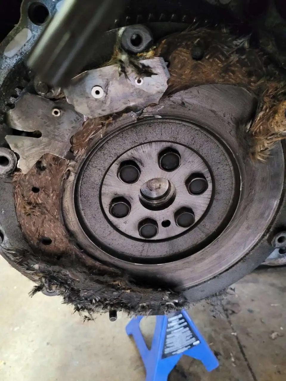

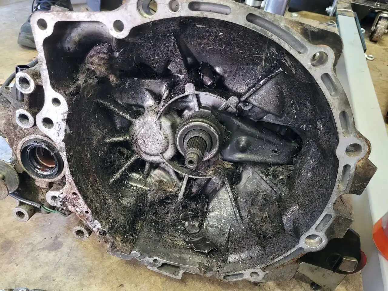

Some pics of the catastrophic clutch failure, and some of the transmission damage... I haven't split the case yet, but I'm sure there's more carnage inside.

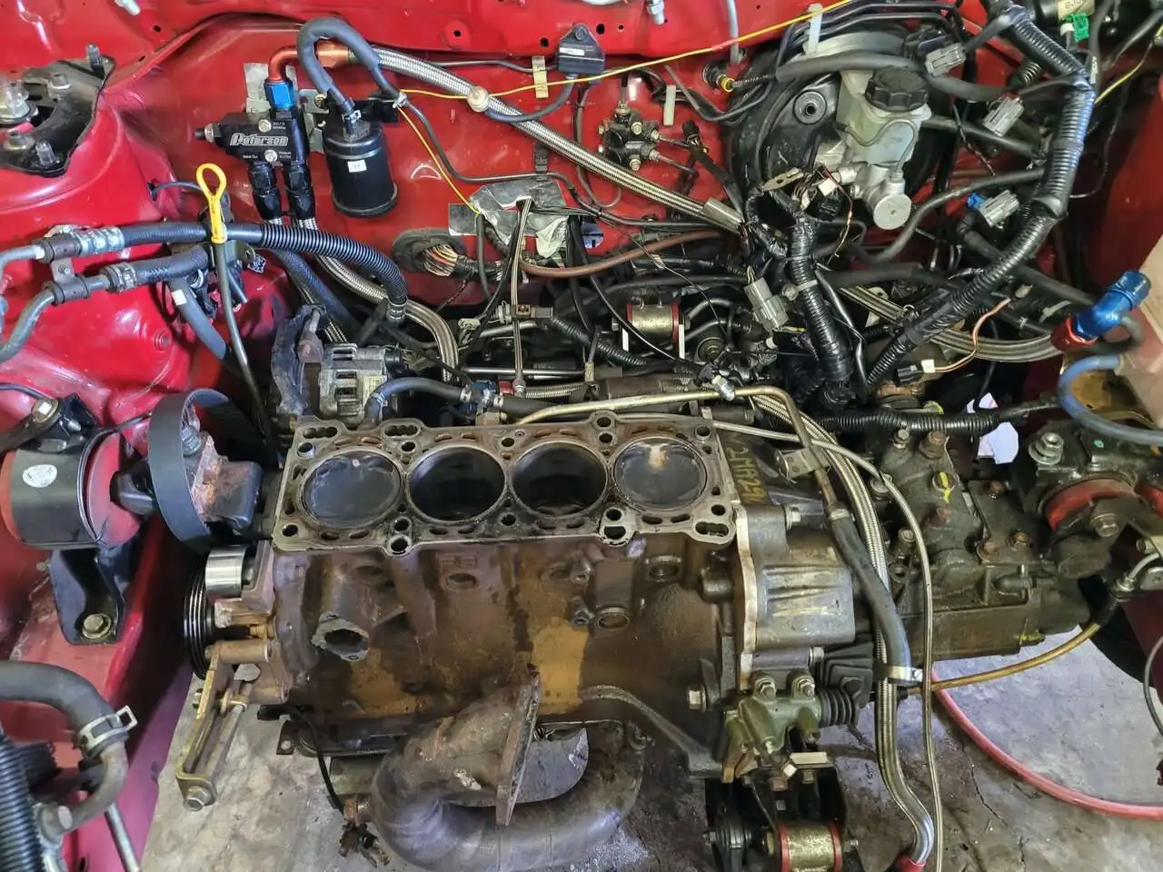

Since my last post, the car was put back together, and raced once more in early October at Calabogie Motorsports Park. All was well until 3rd gear decided to become neutral after about 90 minutes. We limped along for another hour before oil leaks put an end to our day (and our season).
Here's a link to my fast lap from Calabogie: My fast lap - LDRC race @ Calabogie - Oct. 1 2022 I had never been around the track until the pace laps on race day, but managed a 2:33.9 once I got somewhat comfortable with the track.

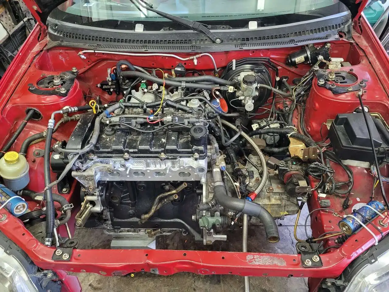

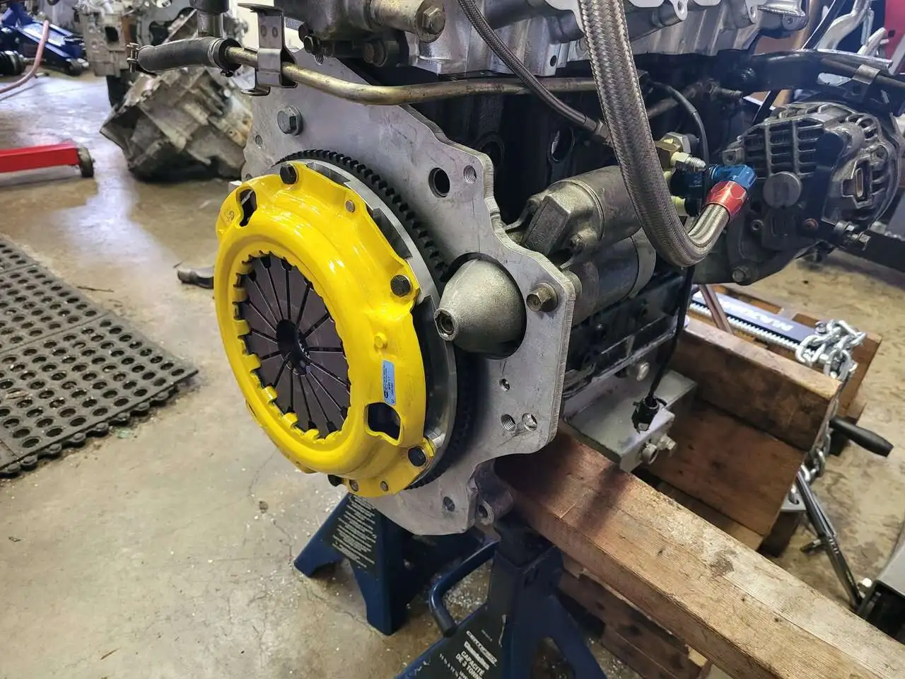

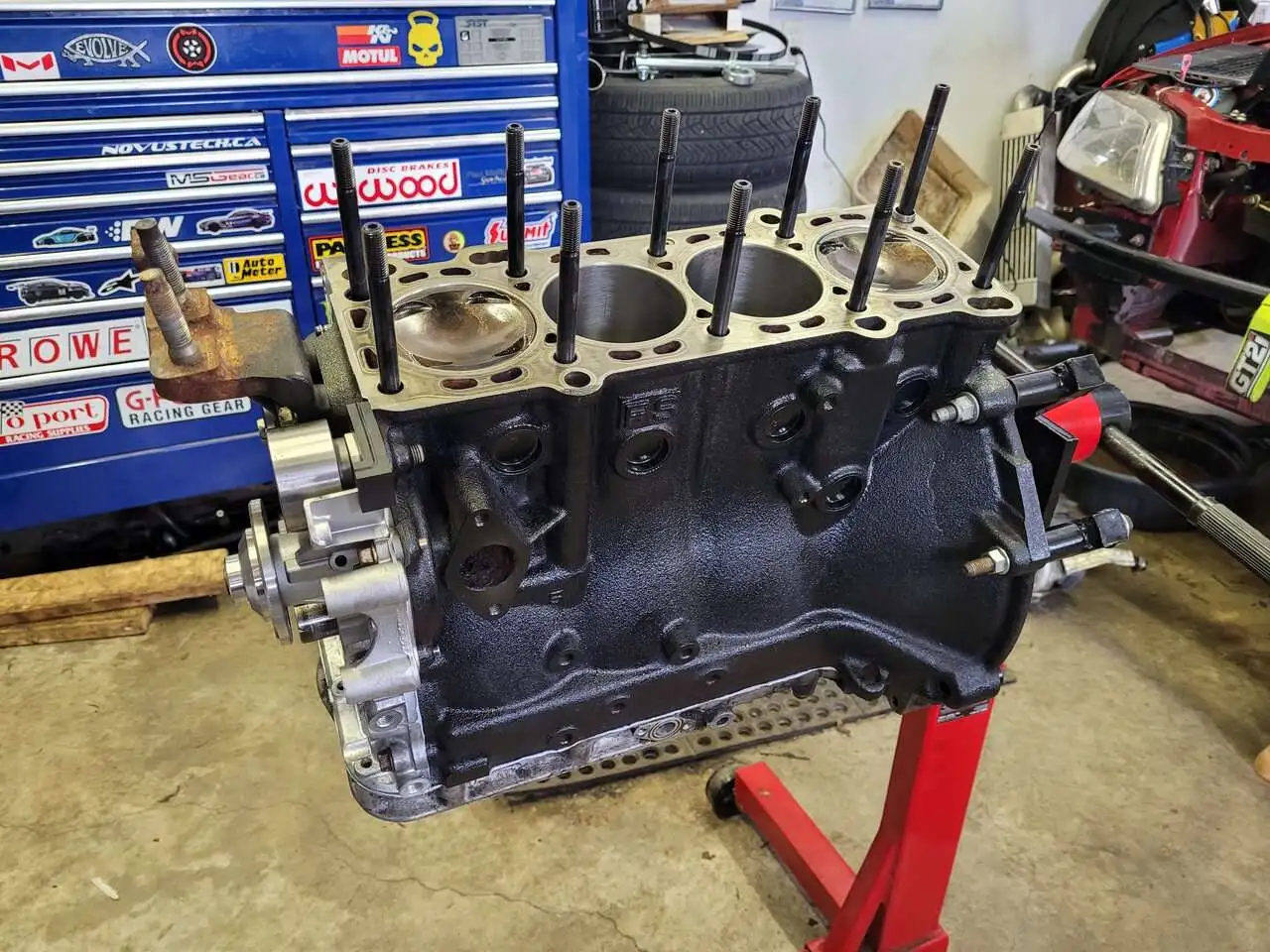

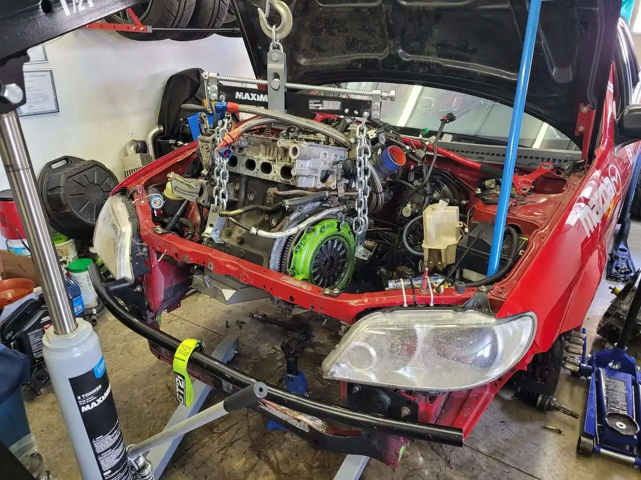

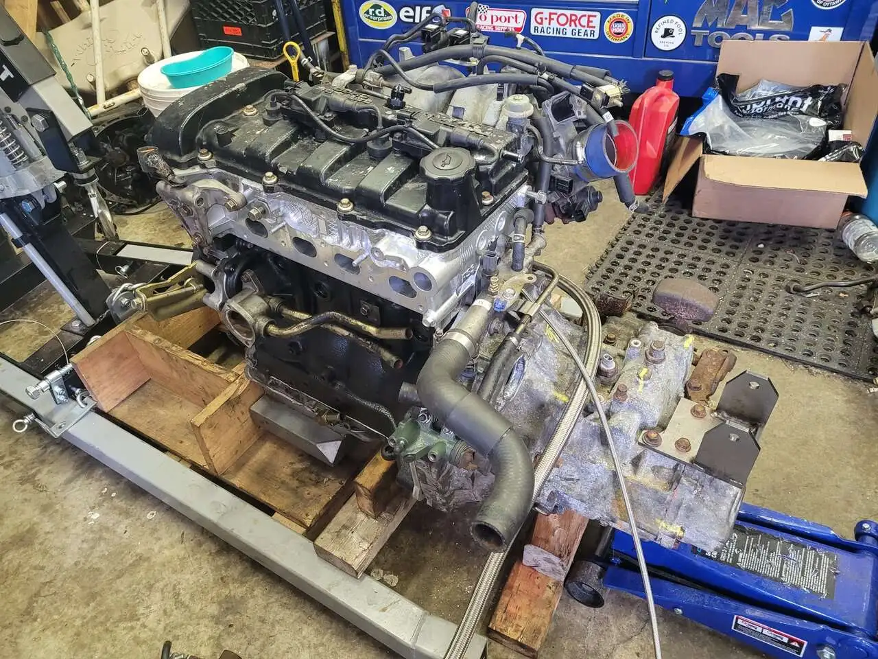

Over the winter, we've completely rebuilt the engine, and are in the final stages of swapping in a Toyota E351 transmission.

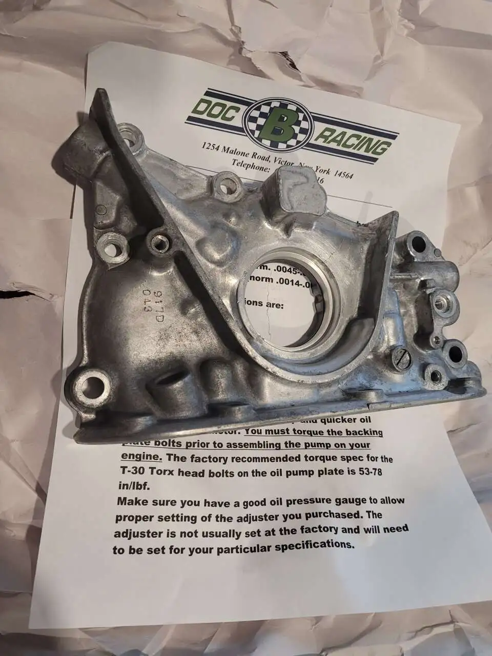

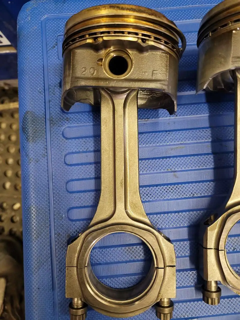

Assorted progress pics from over the winter:
-Tore apart the engine to find Pauter rods in place of the weak factory ones.
-Got an upgraded Doc B Racing oil pump
-Freshly machined block with ARP head studs
-Old, leaking engine coming out
-Toyota E351 swap kit

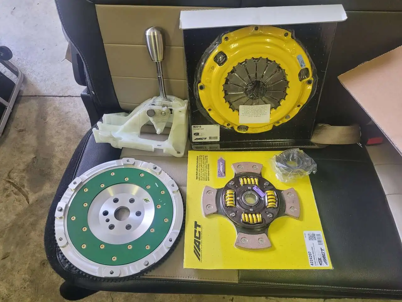

-New clutch, flywheel and shifter assembly for the Toyota swap
-Adaptor plate installed to the block
-The Toyota E351 transmission
-Engine and trans mated together
-Powertrain back in place
Still some work to do (axles, shift cables, clutch slave cylinder plumbing and finishing the revised oil system), but the plan is to be on track next weekend at Shannonville for the season opening Lucky Dog Canada event.

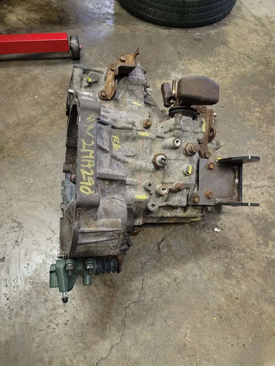

Nice! How much work did the Toyota transmission take to adapt? I spy a bellhousing adapter, are the drive splines close enough / the same?
Looking forward to seeing how this goes 👍

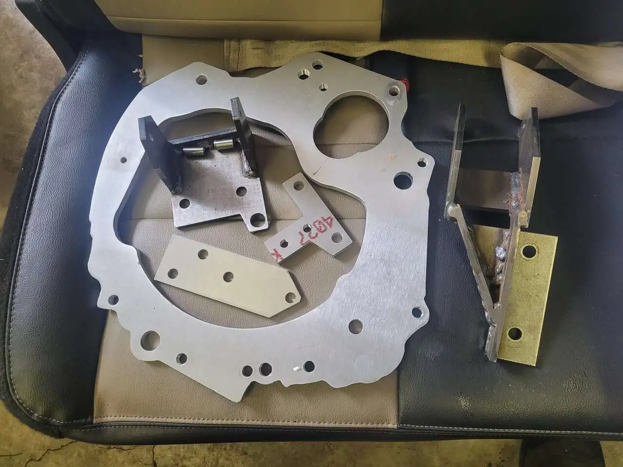

It's a fair amount of work. Someone else did all the development work, I'm using his adaptor plate and trans mount brackets.
-The FS pressure plate and flywheel can be used, but need a clutch disc for a Toyota 22RE engine.
-09-12 Corolla axles work, though the ABS sensors won't read (not important for a track car).
-The Toyota trans requires cables for shifting, I'm adapting a set from the 00-05 Celica with custom brackets and a Corolla shifter assembly.

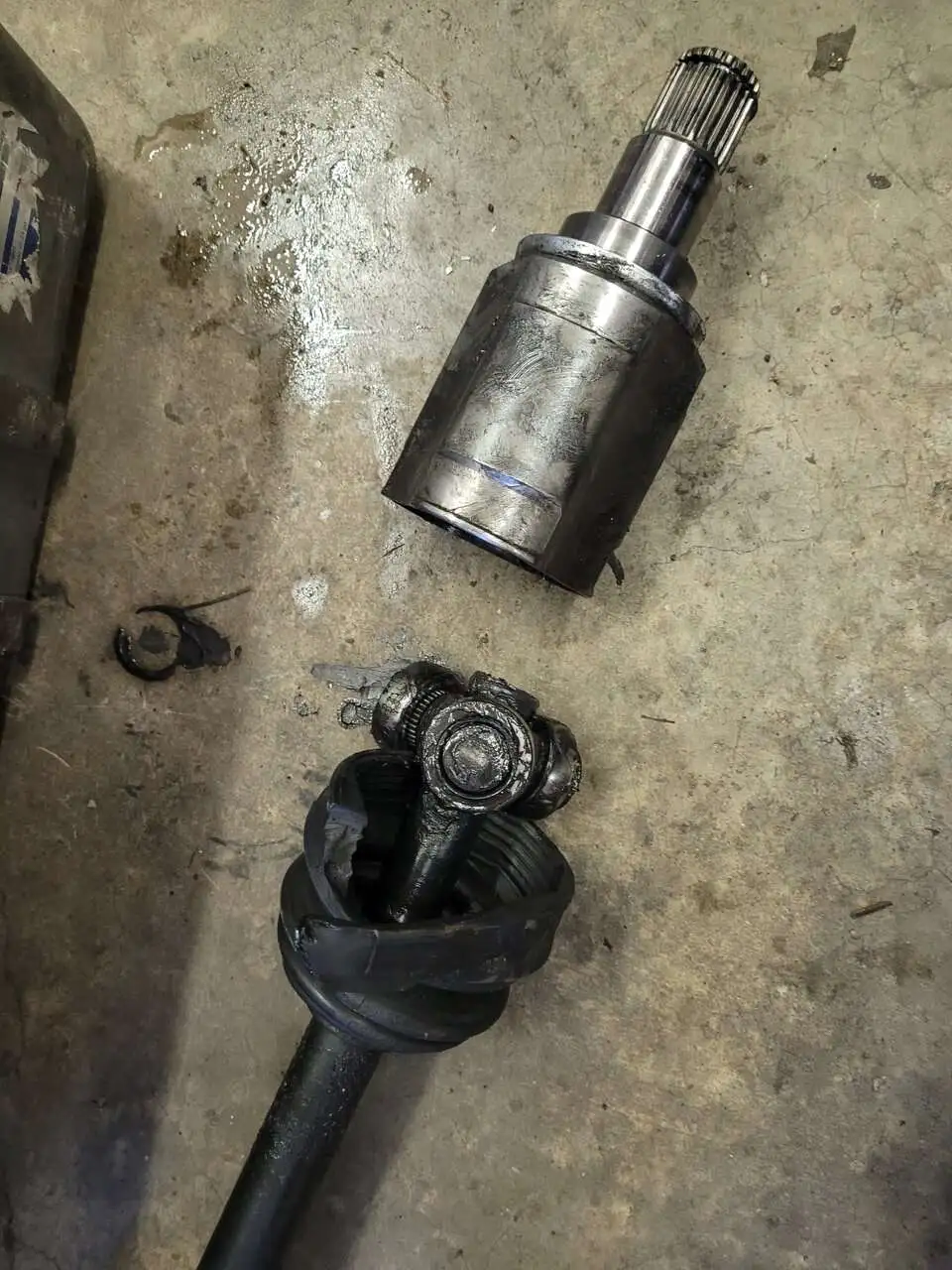

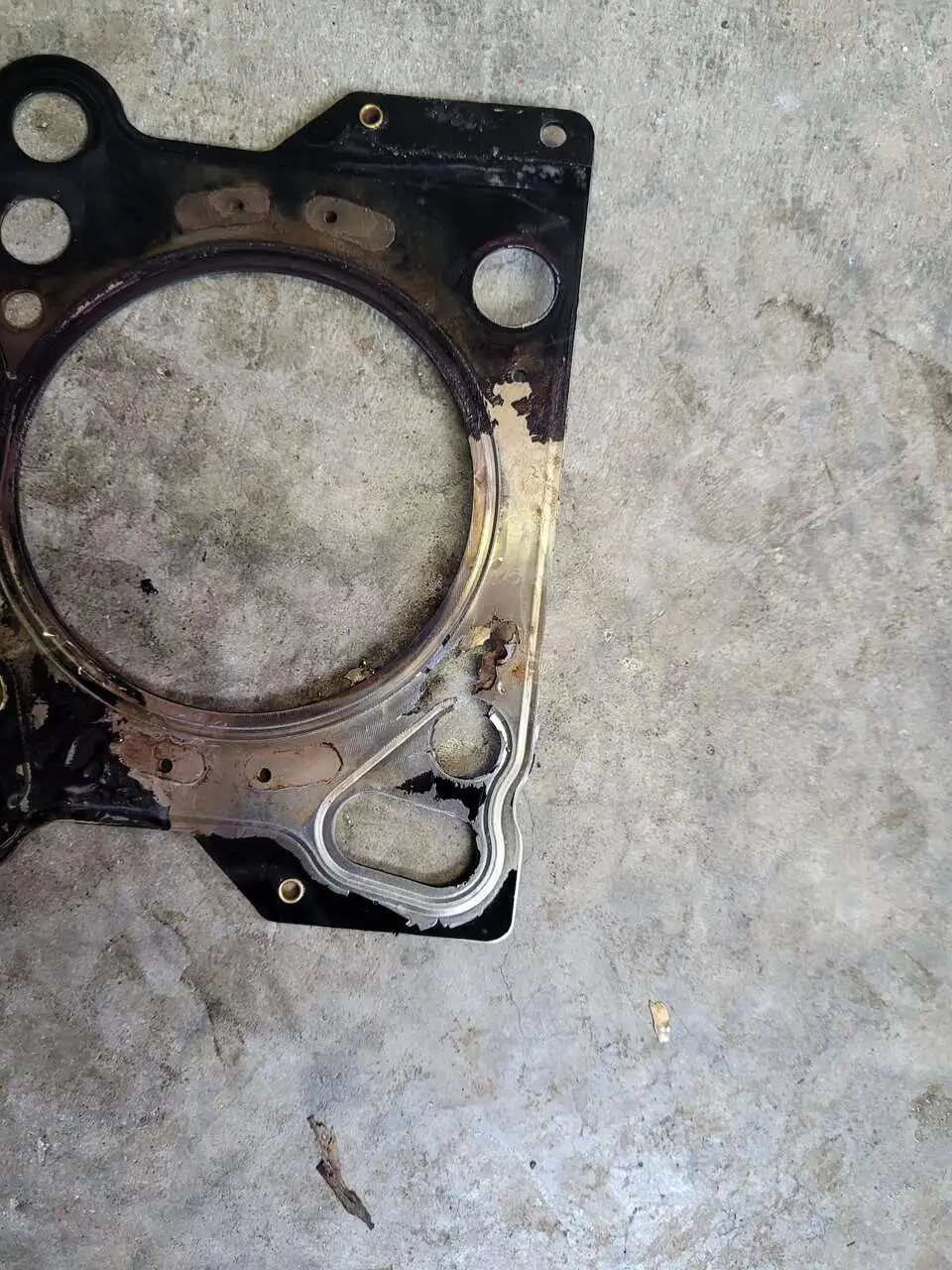

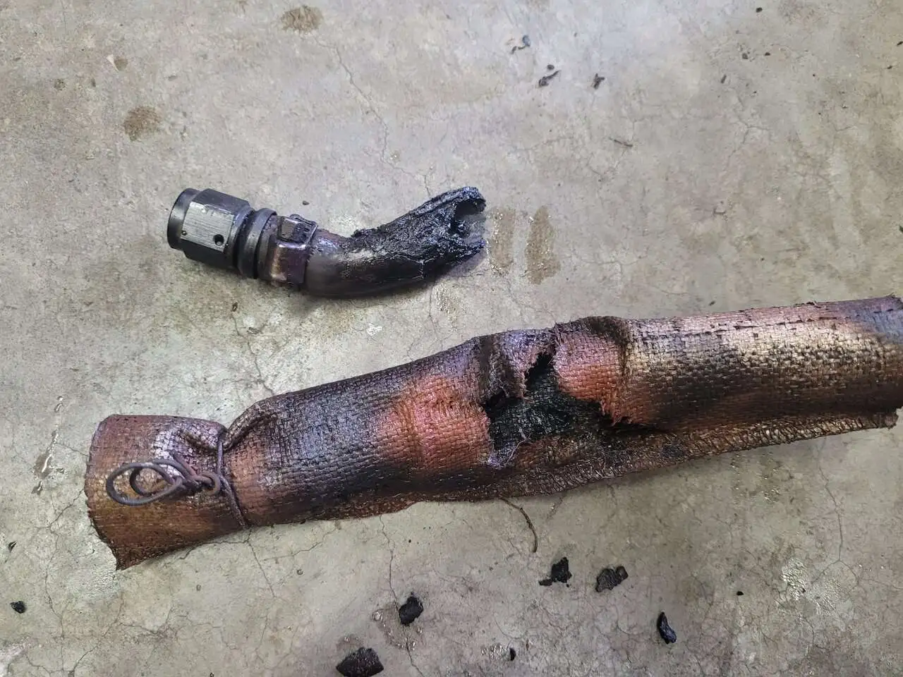

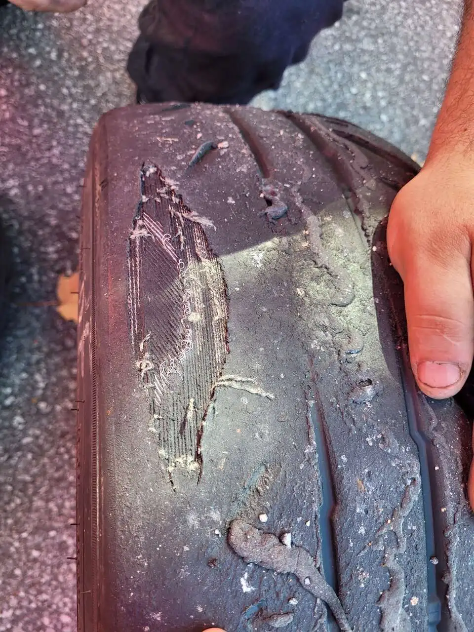

Well we made it to Shannonville. We did 2 hours of testing on a cool and occasionally damp Saturday, without issues.
I took the green on Sunday morning for the 40 minute sprint race (that ended up being 55 minutes due to an incident), and managed a 3rd place, albeit a lap down on the top 2.
Unfortunately, we did some additional practice in the afternoon and an exhaust leak at the turbo melted one of the bypass hoses and we cooked the engine. Headgasket melted and head warped. Waiting now to see if we can get a good head in time to head to Mosport for May 13-14.

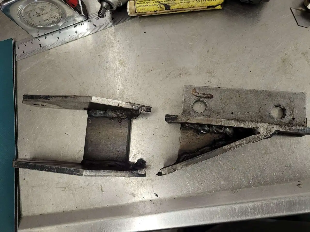

On the plus side, the Toyota transmission held up to 3.5 hours of abuse on track. I just need to sort out the shift cables, lateral movement was not up to par, so we used 3rd and 4th gear almost exclusively.
