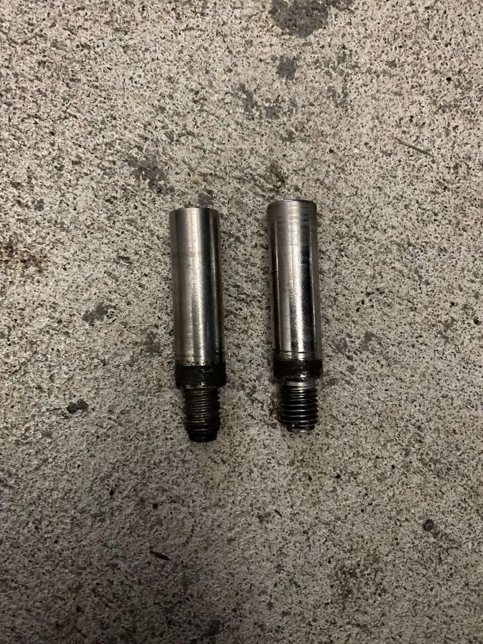

Rear brake caliper pins. One is from my Mazda5; the other is from my M3. Can you tell which is which?
Appears to be the same part – except that the ones on my Mazda5 seemed to require an Allen wrench between 6mm and 7mm, and half of them were mangled pretty badly; I had to use a Torx bit (T50 I think) on a breaker bar to get them loose. Luckily I had a full (albeit used) set of spare pins from my M3, which take a 6mm Allen and haven't been horribly mistreated. Swapped them in with a set of brand new Volvo brake pads.
Bonus: the dust caps for the pins are also the same as on my M3. Also fortunate, because my Mazda5 was missing two of them.

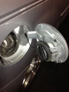

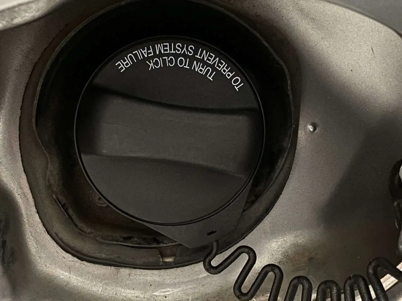

Volvo fuel cap! 😬 PN is 31392044. Seems to fit perfectly, though the casing is much bigger than the stock one. Let's see if it triggers any codes...

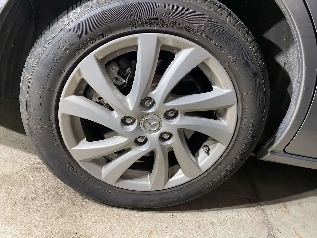

The tires, I mean. What's in the pic is what the car came with. I had intended to drive on them until it was time for winter tires, then ditch them when I swap winter tires onto the the stock wheels, and get new 3-season tires with new wheels next spring. I knew this tire would suck, but I figured I could just drive slower for a while and it'd be okay.
Holy crap was I wrong. Even with most of their tread remaining, these tires are a nightmare in the wet. Feels like driving on snow. Trouble accelerating uphill and braking downhill. Constant accidental wheelspin in second gear, and the occasional slip in third. Even just staying with the flow of traffic, it often takes real work to keep up with – or avoid rear-ending – the person in front.
So, yeah. New wheels, tires, and alignment this coming week. Not a moment too soon. Still a few days out, but I've never cared less about chewing up tires with a bad alignment.
Really liking the Volvo pads so far. Good pedal feel, right amount of initial bite for street use, plenty of reserve braking power when things get hairy. No idea about fade resistance, and hopefully it'll stay that way.
I think left (elongated tip) is the Mazda. The pins are pretty universal. If you check out the Mz5 slider pins on Rockatuo, it'll show the full compatibility list -long list of manufacturers (not just models) use the same part. Considering ATE is the OEM brake supplier, I would suspect all of these cars also use same/similar ATE floating caliper setup.
Are you getting a DTC related to the fuel cap? If not, why replace it? Did you keep the tether and how does it hang when fueling?
Here's the Mz5. Best method is to cut the cord.
Actually that's the BMW one! The one on the right was off my 5.
Yep. Ate, Ate, everywhere.
full
No code yet. Replaced because the tether was broken, cap seemed to be original and ragged, and... I kind of wanted to see if a Volvo cap would fit. :ROFLMAO:
Also sorta-kinda hoped it might help my intermittent warm-start issues (it didn't).

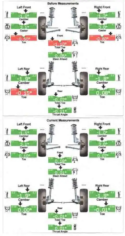

Got an alignment today. Printout attached. Pretty okay with the results for now. Everything up front is new – struts, control arms, and tie rods – but everything out back is original AFAIK.
At some point I'll replace the rear LCAs, UCAs, and lateral arms, plus the rear trailing arm bushings. Anyone think I should get camber correction arms while I'm at it? I'd rather stick with OE-style to keep it simple, but I'm open to opinions.
Had this done at a Subaru dealership and got a '22 Outback as a loaner. Wife said she felt like a soccer mom in the Outback whereas she doesn't in the 5. Another win for the 5 – and for my taste in life partners. :cool:
