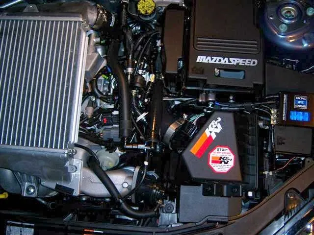

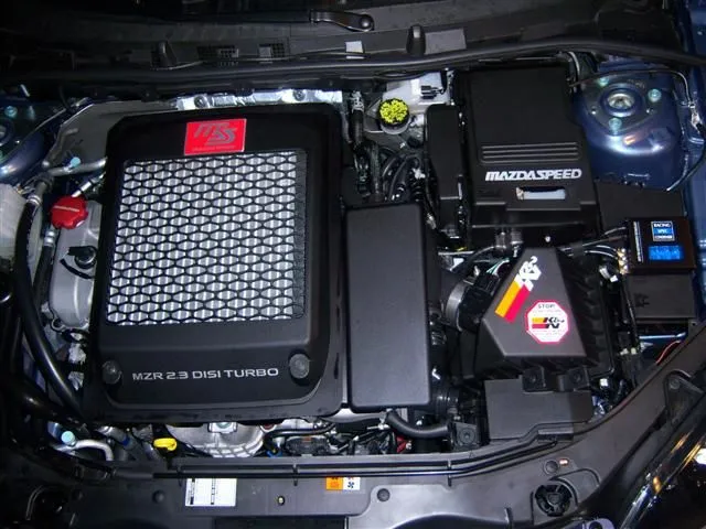

Sheesh.......All done. I started early taking breaks to warm up and type here and there on the Laptop. But, done. All back on. Battery is unplugged right now so the ECM resets. I am thinking of welding/brazing on a bracket so the ATP pipe is held in place were the stock inlet pipe was. Here is a PIC. Only difference is the stock valve. The forge is on now too. I left it in the house so I did PICs 1st and slapped on the Forge unit after.
nice work
