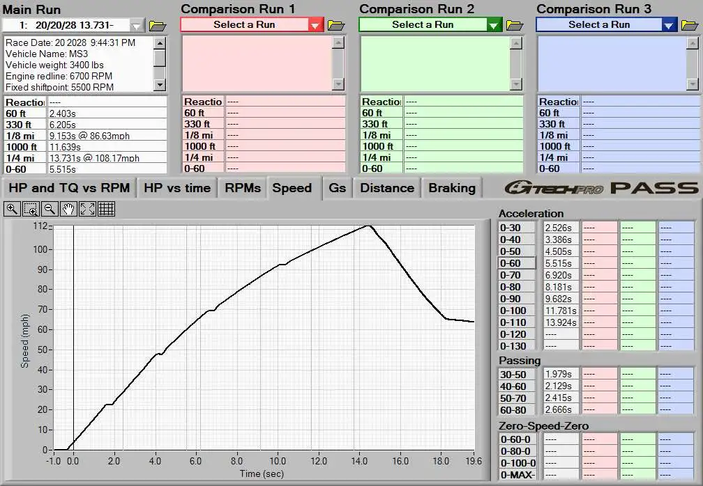

Here's a teaser G-Tech Pro RR chart. Laugh at my crappy 60 ft of 2.4 with an obviously granny shifted 1-2 due to traction problems -- I sure did, but I was not trying to lauch perfectly. I was more concerned about what the run would show for the time intervals from 60 to 100, which came up in 6.3 seconds on that run. Not bad for the high heat and humidity. You do have to dial back the quarter mile trap speed by about 1.5 mph or so, because G-Tech measures absolute speed at the end of the quarter, while the track timer averages the mph over the last 66 feet of the quarter. The car seems to be making nice power for this mod level, once it hooks up.
But again, I caution putting too much value in a single run under very adverse conditions.
