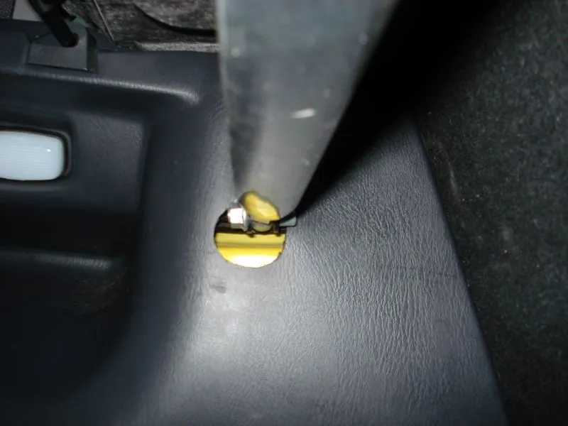

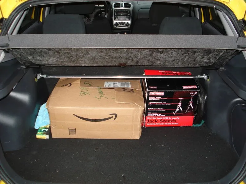

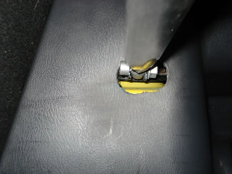

Here are the pics of mine installed. I took them today. You can see the holes...I messed them up when I drilled so I had to redrill. I will probably get a 2 in hole saw and make them circular so it look's better but for now I'm leavin it. and it looks like my left panel is coming off, i didnt notice it when I was looking so I'll check it out when i go back downstairs.

yea i know the holes are bad, especially the last one. but the hole saw wouldnt grab any closer. so i am gonna get a 2 in hole saw to make them both one hole and hopefully center the hole on the bracket. i just dont know when b/c the panels are a pain to mess w/

Just use your dremel tool to make the holes even
if you buy some elastic plastic tubing from the hardware store you can easily make the edges look much 'cleaner'. Buy the hosing, it will have a nutural curve to it from the store. take a utility knife and carfully cut on the outside of the curve all the way down the tube. Like splicing a worm open in biology class. Place the cut edge into the spline you just made and trim to fit in length. If your hole is not an exact circle this will aslo help round it out a bit.
hm...i mite try and remember that. idk what to look for at the store, maybe i'll just go c what they have. just regular black elastic tube?
