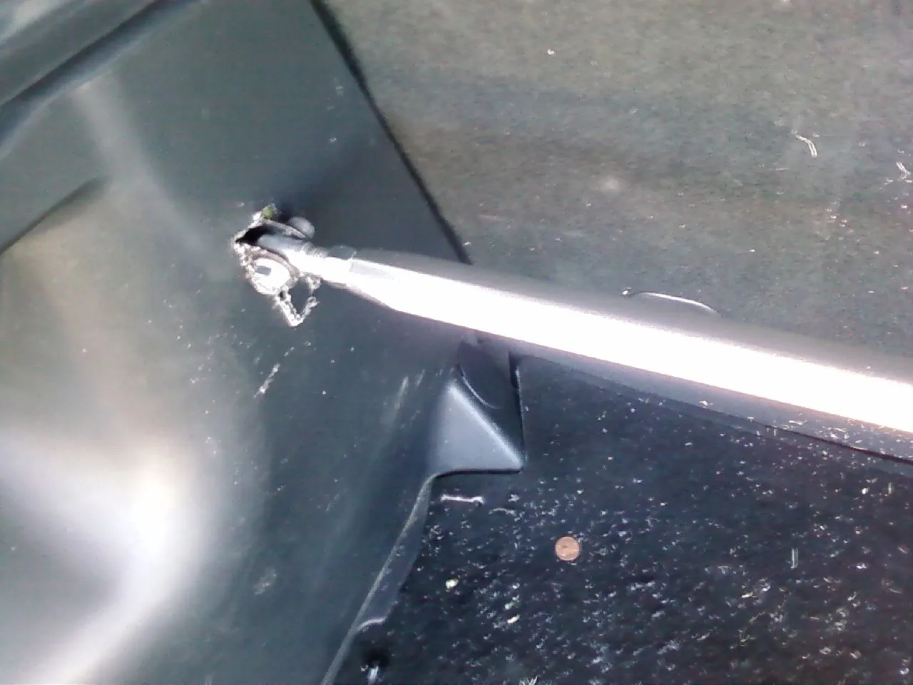

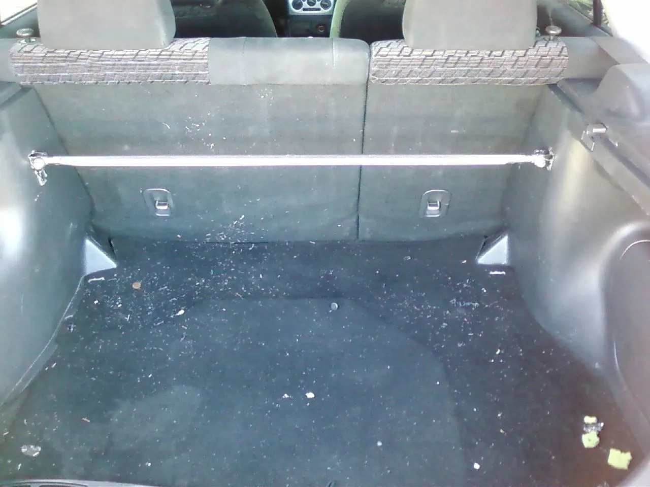

Just received the strut bar today. Install wasnt too bad at all. I just bent the seat belt holder bracket. Looks decent for a first timer. I figured id go to home depot and find a coupler for the brackets, and cleaner look.:cool:
