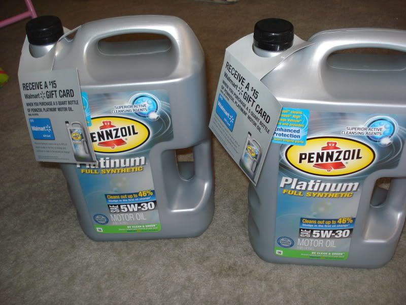

FYI: Walmart is running a special on Pennzoil Platinum:
In addition to costing only $20 for 5qts they will send you a $15 Walmart card in the mail!
Limit two per household
I'm headed there right now.
Just picked up two myself!
