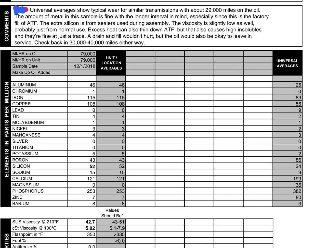

Cx5 2014, with "lifetime atf fluid". This was a sample at 79k. With their data, it seems as good as 29k, telling me to push to another 30-40k. I got this sample before I did a 2x flush and drain.
